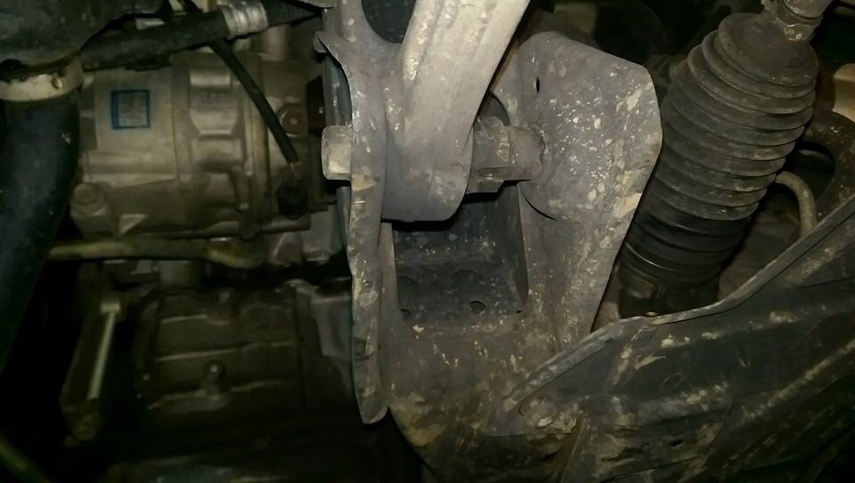

Take a pic of the bushing , or search a hair for pics of good vs blown

Blown LCA bushing, if it's good it will be centered
