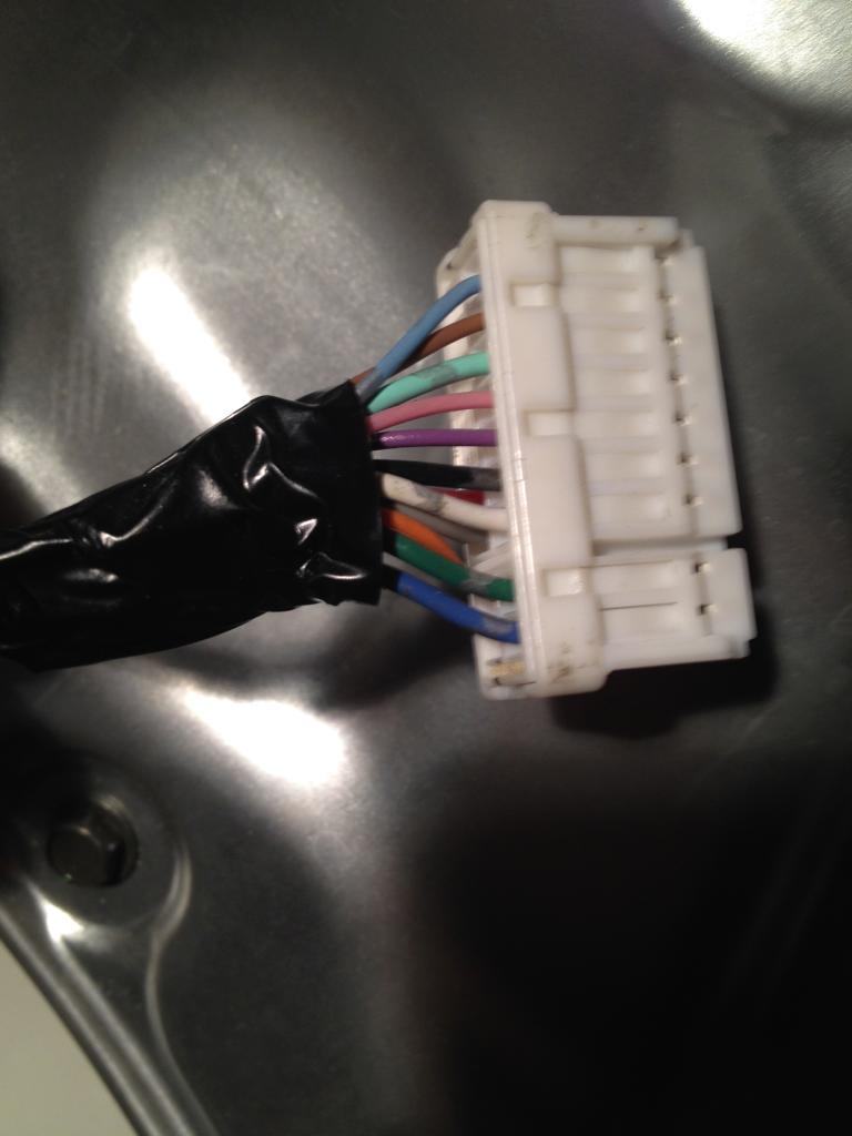

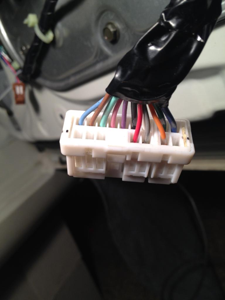

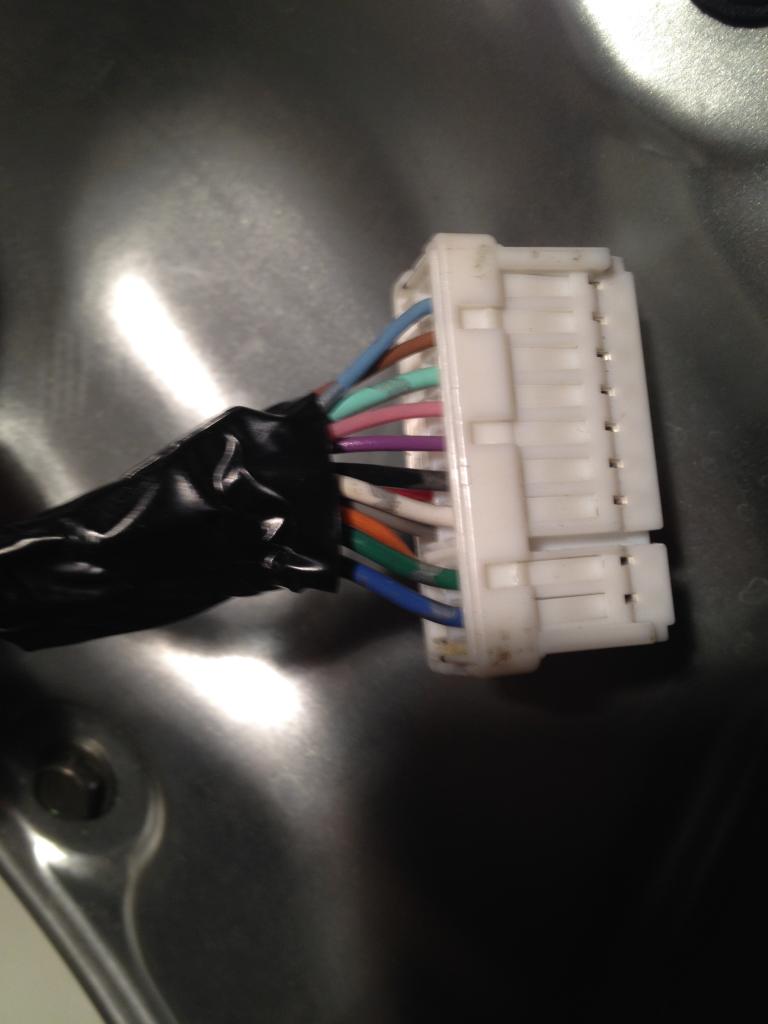

I have a 2003 track edition, and i have been having troubles with my door lock actuator. I was in the process of removing the door panel on the passenger side and i had to unclip the single electrical harness attatched to the window switch (The one with 12 different colored wires). Well in the midst of trying to unclip it i must have pressed the wrong part and instead of releasing the whole white harness, it let go of all the seperate colored pins!
there are 16 different slots so the possibilites are endless and i dont know which colored wire goes into which slot. If anyone has an upclose picture showing which wires go into which slot and could share that with me it would be greatly appreciated! Or if someone knows where i could find the rescourses for this (i have looked virtually everywhere, from the nissan website, to ebay ads!) and point me in that direction id be forever in your debt! Thank you so much everyone!

ahhh...the beauty of having a gutted car!
My disclaimer - these are off my 2003 touring, I have never modified this wire harness and I cannot guarantee that your wire layout is the same as mine and therefore I cannot be responsible for any damage that occurs to your car as a result of the use of these photos.
I want you to do something nice for someone in the next few days...here you go:

Wow, thank you so so much for taking the time out of your day to do that. You are the best!!!!! I dont even know what to say, you saved me so much trouble! thank you!!!

No problem...it took me more time to walk to the garage than it did for me to snap the pics...I couldnt tell from your picture but how do the wire colors match up?
please update the thread with your progress and/or a final solution!

Well thank you!
And to confirm yes, the wires on your 2003 touring match the wires on my 2003 track passenger side, and all the electrical is working again!
