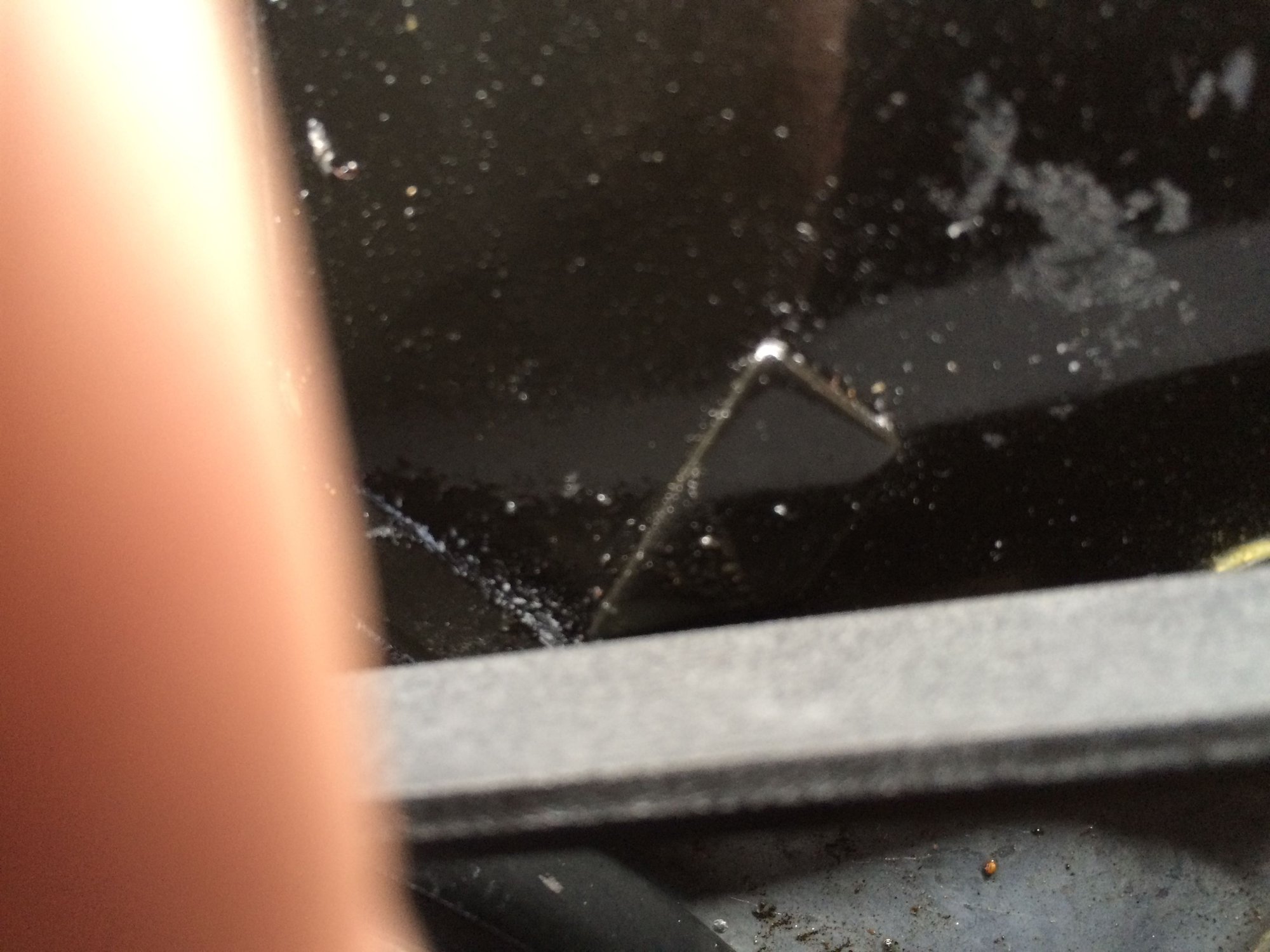

Just took these pics with my iPhone after a quick lunchtime drive.
Water pump access cover- it is pretty grimey

UPDATE** I replaced the valve cover gaskets and spark plug tube seals (and plugs that were sitting in oil in the tubes) Still have a leak, less substantial, but still there. Would a front main failure make all that mess in the front? I don't think it's a rear main- looks pretty good back there, but I have to get this sorted out. Any recommendations would be helpful from those who have chased something like this down on their VQ.

UPDATE: So I found it. Front Main Seal was the culprit. When I removed the crank pulley I found a crack in it and replaced. Come to think about it, it had a little wobble to it previously. The woodruff key was a little bent toward the driver side, but i was able to get the new one on and put some blue loctite on the opening that sits on the crank. No wobble, seal & crank pulley replaced, and the best part was no leaks.
