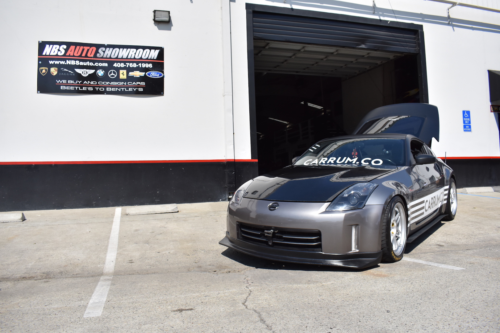

Hey guys,
I've had an 07 grand touring for 2.5 years now. She's got about 70k on it with light mods. I daily drive and drift the car. So I took her on some heavy highway runs while on a cars and coffee rally to an event. Had the car driving at pretty high speeds most of the time but nothing new to the vehicle.
The next day I turned the car and a weird humming/buzzing sound that was coming from the engine. I looked up what it could be first thing I saw was to change the oil. Found some thread about some guys saying that once they changed their oil the sound went away, which I was hoping the same for me.
The oil had been in the car for only 25-2700 miles. I changed the oil and filter and the sound still remained. When I rev the motor the sound increase with it.
