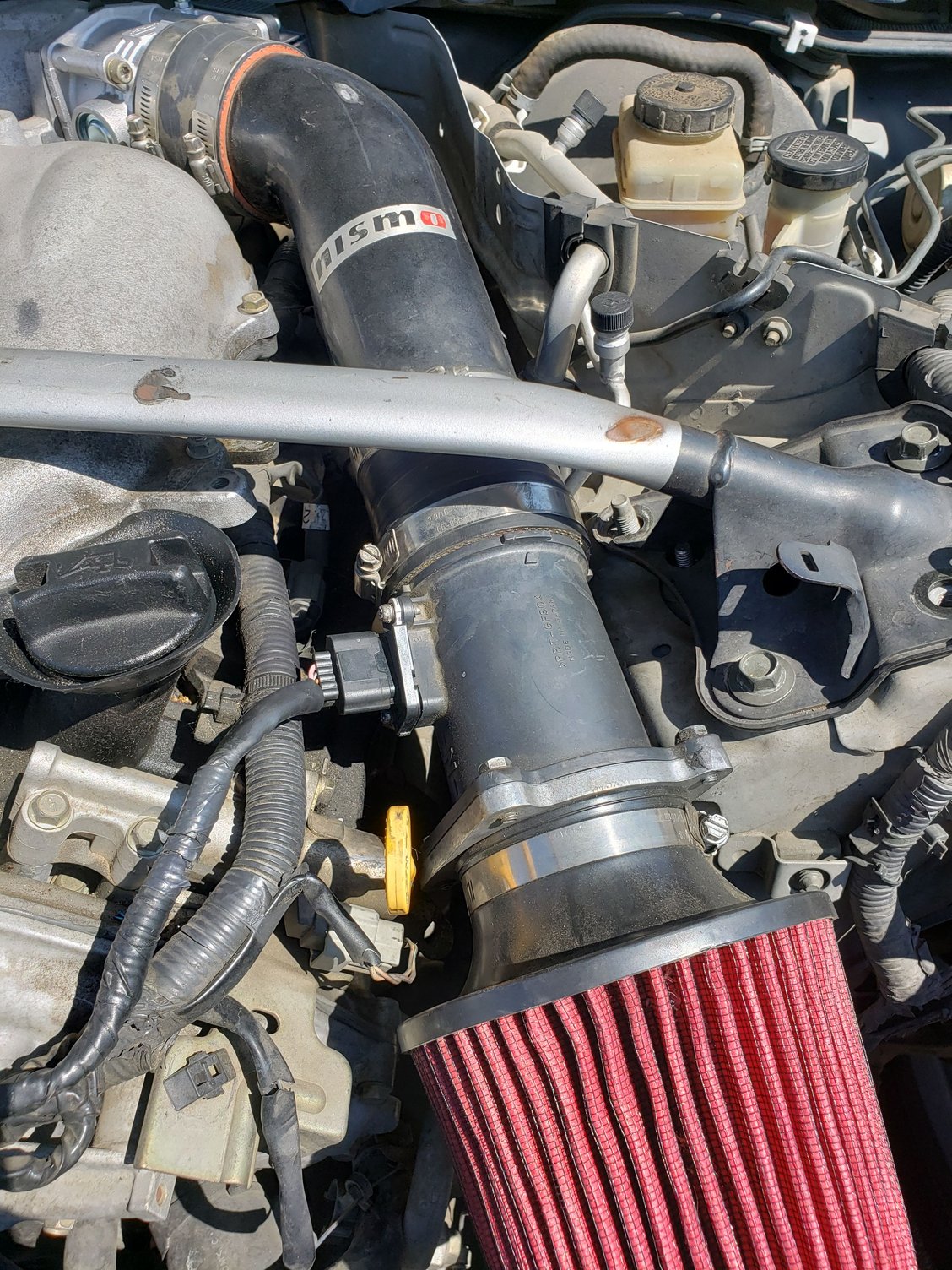

Post a picture of your intake. If someone put a 4 inch intake on their and never bothered with a tune it might be the main culprit. For some reason 4 inch intake pipes are all the rage lately in these cars.

It doesnt look like it's a 4 inch. The car ran fine for a while after fixing the lean issue it had on it. Now its throwing p0172. I'm swapping the new MAF back into the car. It was switched back before the intake was cleaned and I'm going to clear the code and see how it runs

that style of intake filter doesn't allow for laminar flow to that maf, it will be wildly turbulent air.. ( there's no venture behind the filter like on a JWT) AND... it loves to throw filter oil at the maf.
I opened this thread ready to comment " what crummy ( no offense meant at all) intake do you have, or you have a vacuum leak."
You sound like you've researched the common issues, but vacuum leaks can be a b*tch on this weird plenum , and hoses do tend to leak especially at hi mileage like that. Also, leaks can come and go due to heat expansion on the plenum etc.
In all honesty, if you have a mostly stock car otherwise, find a factory airbox and reinstall, it is hands down a better intake for this car than anything else out there until you get VERY modded.. and it comes with ZERO problems or gremlins.

While I do agree with you, I bought the car with that intake on it. I would love to get something better, but that'll come later after some significant mods. While it isnt the best, it's also not the absolute worst either. If you're getting oil thrown through the intake, then you might have a vacuum leak, pcv issue, and/or a dirty intake. I've also found vacuum leaks to occur on the back side of the plenum more often too
