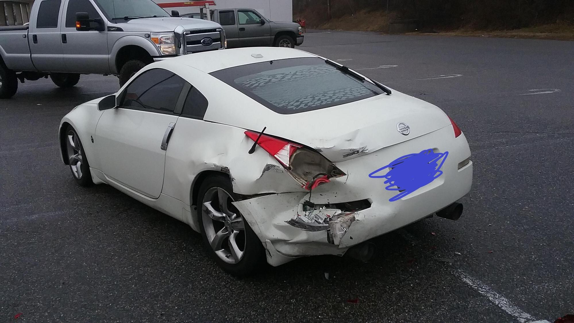

115,000 miles, rear ended in a parking lot by a rolls....
Their insurance is estimating over 10k in damage, saying that there's damage to the unibody. Which means they're probably totalling it and getting an estimate on the car.
The car still drives just scrapes the wheel. It has been sitting for a week now though.
Does 10k sound like a correct estimate for this?
It's a damn shame because I feel like the car easily had another 100,000+ miles left in her.
Original clutch btw
dont judge the tint it sat under sun for years and bubbled up

Rear Quarter including inner fender ~ $3,500 - $5,000
Taillight ?
Hatch ?
Rear bumper ?
Exhaust ?
Chasis/Subframe ?

Mine had about half that damage, and it was close to 6k. Not to mention they will find more damage when they start taking stuff apart

100% totaled. These are full welded quarterpanels, and the frame rail and inner structure is definitely damaged to the point of needing replacement. I would also bet that the axle, suspension, and subframe are all damaged also.
