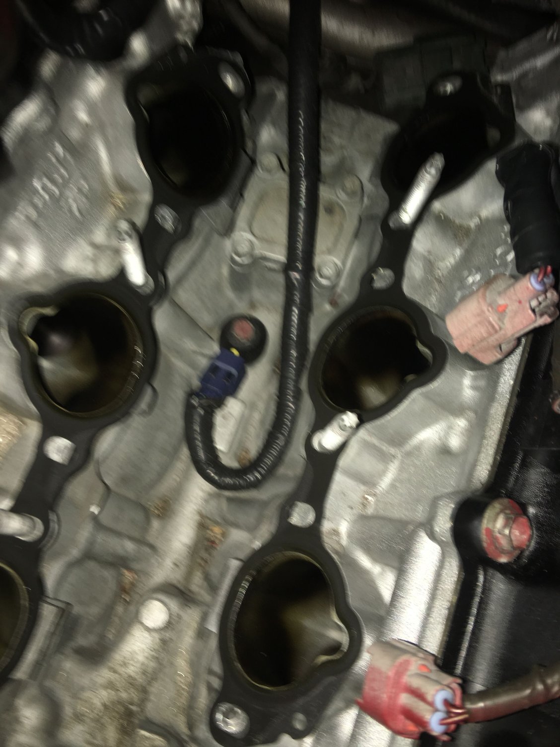

Hi Everyone,
To start off my Z is a 2003 Touring model. I bought it off craigslist in hindsight not the greatest judgement call especially since the engine blew not even 25 minutes after i bought it and because it was no refunds i chose to just cut my losses and just towed it home which was a few hours away. A chunk of money and a month later I got the new engine installed and even then I still had a profound amount of issues the car had a clean title and only 44,000 miles on it when i purchased it the previous owner said it was used for drag racing not sure if that's true nor is it what i use the car for its my daily driver. I love the way it looks and sounds apart from the misfire. I put quite a bit of money into my car and i'm not really complaining i do love my car and its been a lot of fun learning about it and repairing it. I'm sure if i didn't love it I would've just given up after the list of repairs kept getting longer and longer. And now i have this P0300 code that's pending and stored that's lasted at least a year now.
Some background information on what I've done include I have replaced the O2 sensors, the coils, I have redone the wiring harness, changed the fuel injector O-rings, changed the spark plugs, changed the camshaft and crankshaft sensors, the battery, the air intake, I've upgraded the majority of the coolant lines with the Z1 Silicone ones and checked the vacuum lines for cracks and couldn't find anything like that, added new grounds and cleaned the original ones, replaced the thermostat, A/C compressor, Clutch setup and clutch lines, Changed the passenger side fuel pump. and a variety of other things.

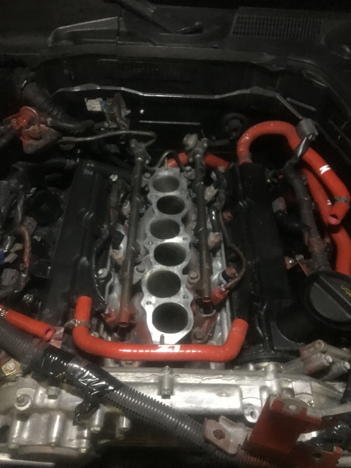

With the help of this site and the service manual i was able to do the majority of the repairs and reduce the cost. Which was helpful since I have some distrust when it comes to shops (very bad experiences in the past) but when i ran out of ideas I caved in and ended up taking it to the dealership to try and solve this misfire issue $200 later they said it was an intake manifold leak that seemed to be the culprit and told me to strip it down past the intake runners and then reseal it. Which i did a few days after and the car still had a pending and stored P0300 code so i decided im better off asking for advice here because this has been my go to place for help. Especially when they told me in order for them to remove my ignition coils and check for oil down the spark plug tubes they would have to remove my intake plenum and wanted to charge me $1100 which i declined.
After I've replaced all those things the car runs great no oil leaks now, no stalling, no overheating, the car idles at around 1200 rpms with some up and down movement according to the scanner by about 20-60 rpms. It has always idled high even before the code came up. I don't have catalytic converters just test pipes with the proper O2 sensor locations. The CEL never blinks just a constant service engine soon but for the life of me I cannot figure this misfire thing out and i'm hoping its something obvious and simple that i'm missing and not something wrong with this new engine. I've checked every other post related to this code and tried it all to no avail, so as a final attempt I would really love to know if anyone has any thoughts or anything that could help me out. thank you.

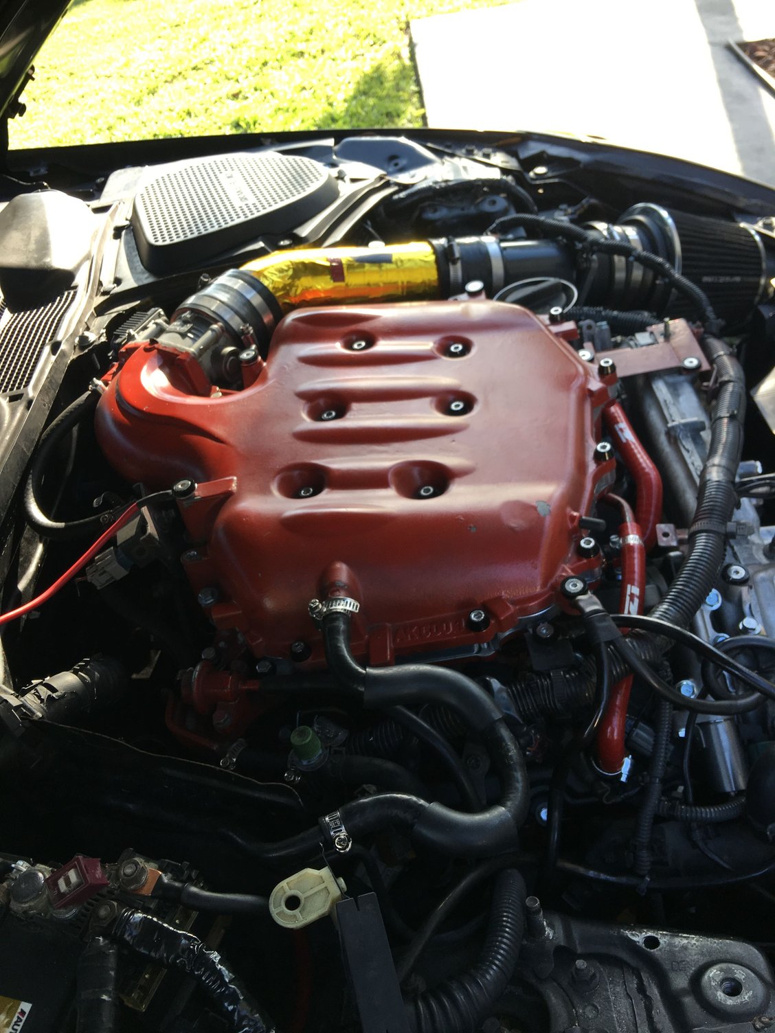

Welcome and congratz.
With test pipes you have changed the way the car breathes. The airflow is outside what your ECU is expecting so it throws a code. Don't get me wrong, you may actually have misfires but you say it runs well. Make sure your intake is snug. The idle is high, might want to put a vacuum gauge on the intake and watch for fluctuations.

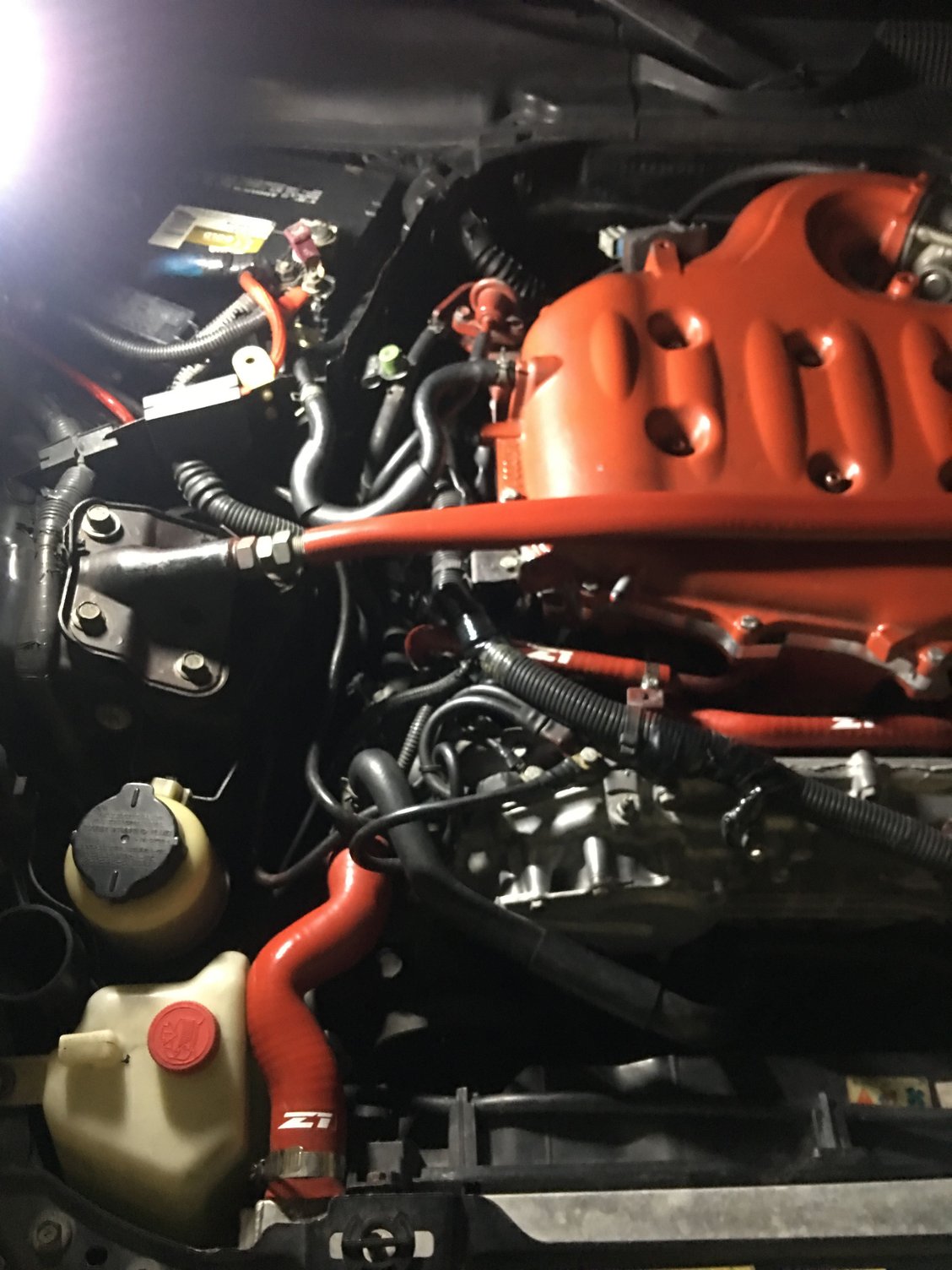

i would question the sanity of who you bought it from to use a red wire as what looks to be a ground
Old Jun 19, 2020 | 01:10 PM
Joctcb's Avatar
Joctcb
Joined: Oct 2018
Posts: 6
Thank you for the reply,
I actually will have to take the blame for that one the original set up had to be modified when the new engine was installed, but I bought the red ground wire from an auto parts store because my battery didn't seem too stable and I read on here adding more grounds could potentially improve that, so I went and bought it from the battery department and it was labeled as a grounding wire but hopefully its not causing a problem. It did seem to help although it could just be a placebo effect. A big issue on my battery that the original owner did add is that little red box that's above the positive terminal, I got stranded one night and it turned out that the little box if touched or moved causes my entire car to short out and the car only will power up if that box is snug and connected I don't know why it had to be added, but I just secured it and haven't had a problem since.
