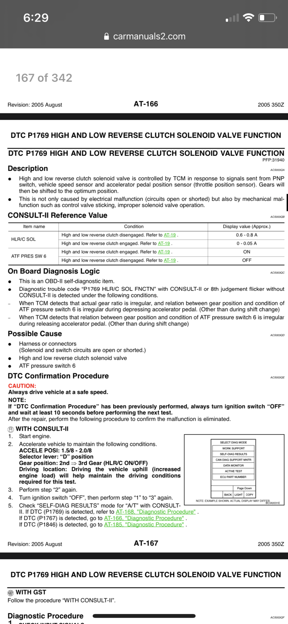

found these in the manual but idk if I know etf I’m reading lmao
im going with the easiest step next which is check the harness connections and stuff
