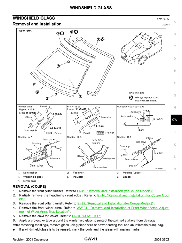

The FSM doesn't really give a whole lot of guidance on replacing the upper molding other than merely saying to remove it and install it securely.
