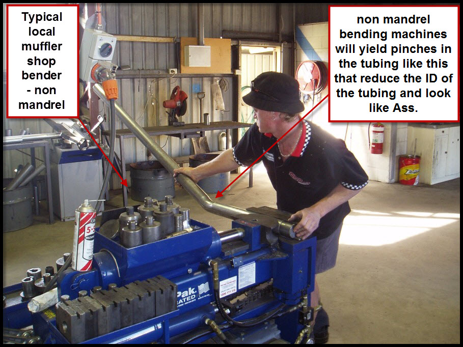

---Now this is where you get the local muffler shop to bend pipe for you--
This point you want to find a muffler shop that can get you SS piping and hands down has a mandrel tubing bender, if not then the bends in the pipe are gonna look like crap.......pinch the ID of the pipe and not have consistent flow...

example of non mandrel bent - ie, typical muffler shop hydraulic bender

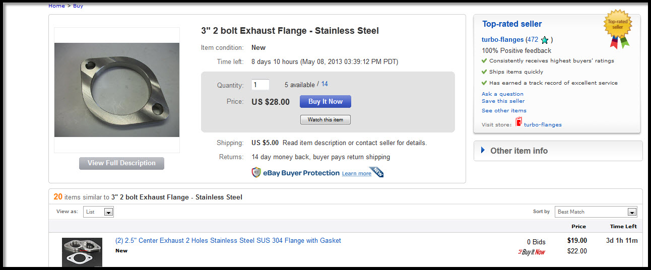

- prior to going, you would want to find online the exhaust flange to mate with your Y pipe configuration and take it to them.....example:
http://compare.ebay.com/like/2210704...Types&var=sbar

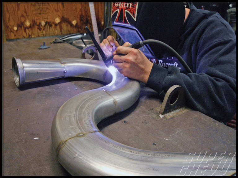

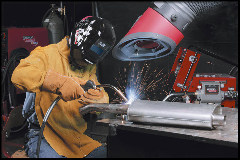

Welding:
Tig vs mig - all/most local muffler shops are gonna wanna do the job using plain, non SS tubing and then they are gonna want to mig weld the job....
Dont do it...find a shop that can do SS steel, has a mandrel bender and can tig weld it for you...
Tig welding:
Horrible mig welding:
