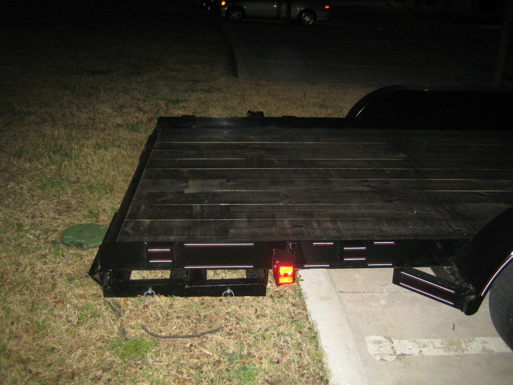

I have a trailer that is about 83 inches wide, so just got rid of the 5 foot ramps in came with, They slid under the trailer in a ramp holder. I made my own 6'-8" long ramps.
I crank the front crank up a bit (while attached to the tow vehicle) and give the trailer an angle along with longer ramps lets me get up on the trailer no problem....
pics off to drift events........last pic shows where the ramps are stored...

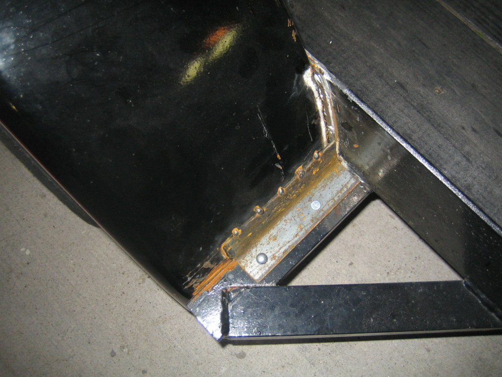

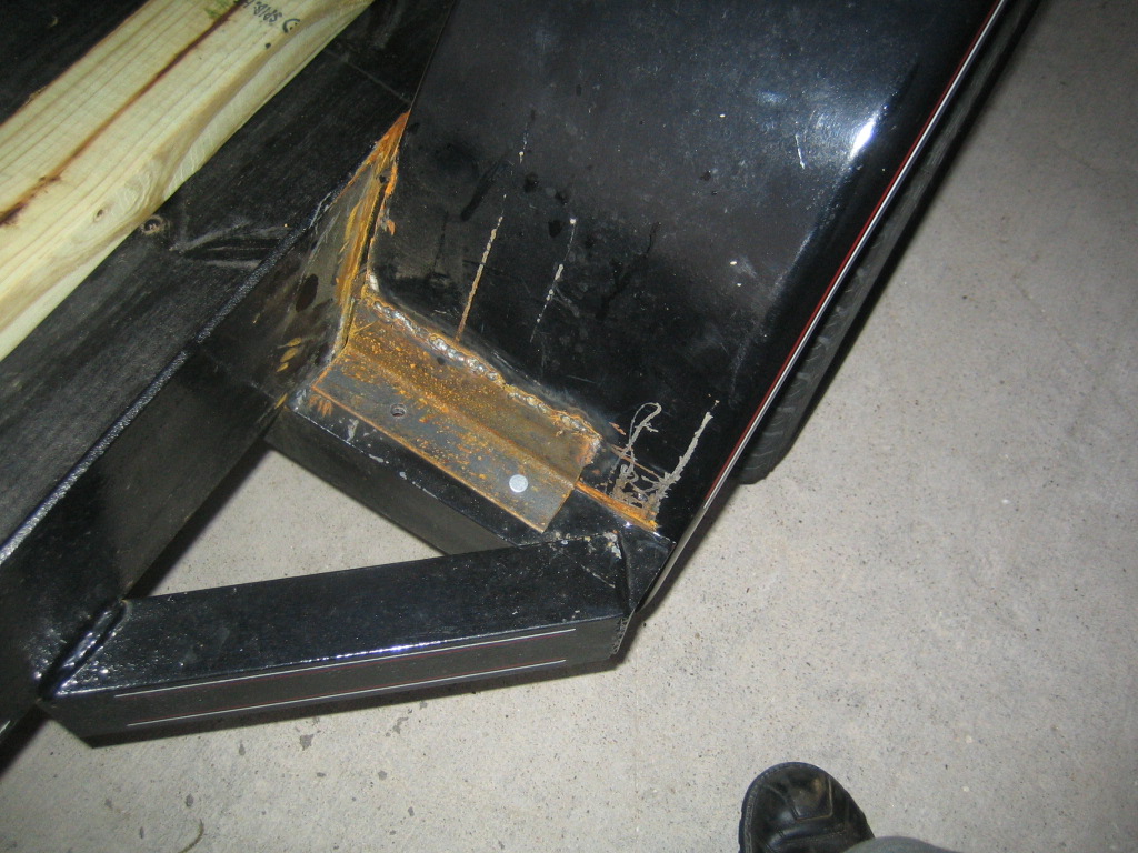

My removable wheel well mod....lol
I grinded all the welds and free'd the drivers side wheel well from the trailer.
then i welded flanges (bent L-angle) and use wing nuts to secure the removable wheel well.
Those pics above are with the car on and the wheel well back on. But it comes off prior to driving the car up on the trailer..
I chemical treated all the rust with rust remover and then painted it all black again. These pics are old, but the current configuration has a welded bolt coming up from the bottom. So i just drop the wheel well down onto the bolt sticking up and then i attach a fender washer and a wing nut to secure it. I also have a C-channel welded to the inside of the wheel well that catches the lip of the trailer side and secures it there too...
