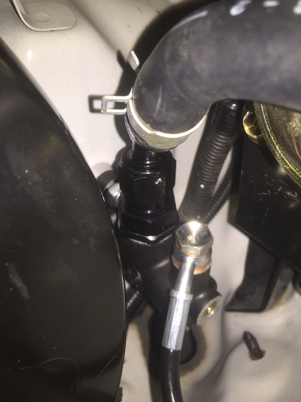

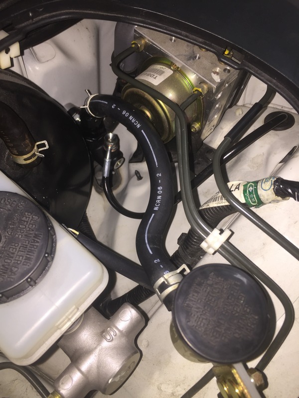

Here is a pic of the Tilton master cylinder tucked away in its new home. I had to cut the rubber hose that connects the master to the reservoir.
