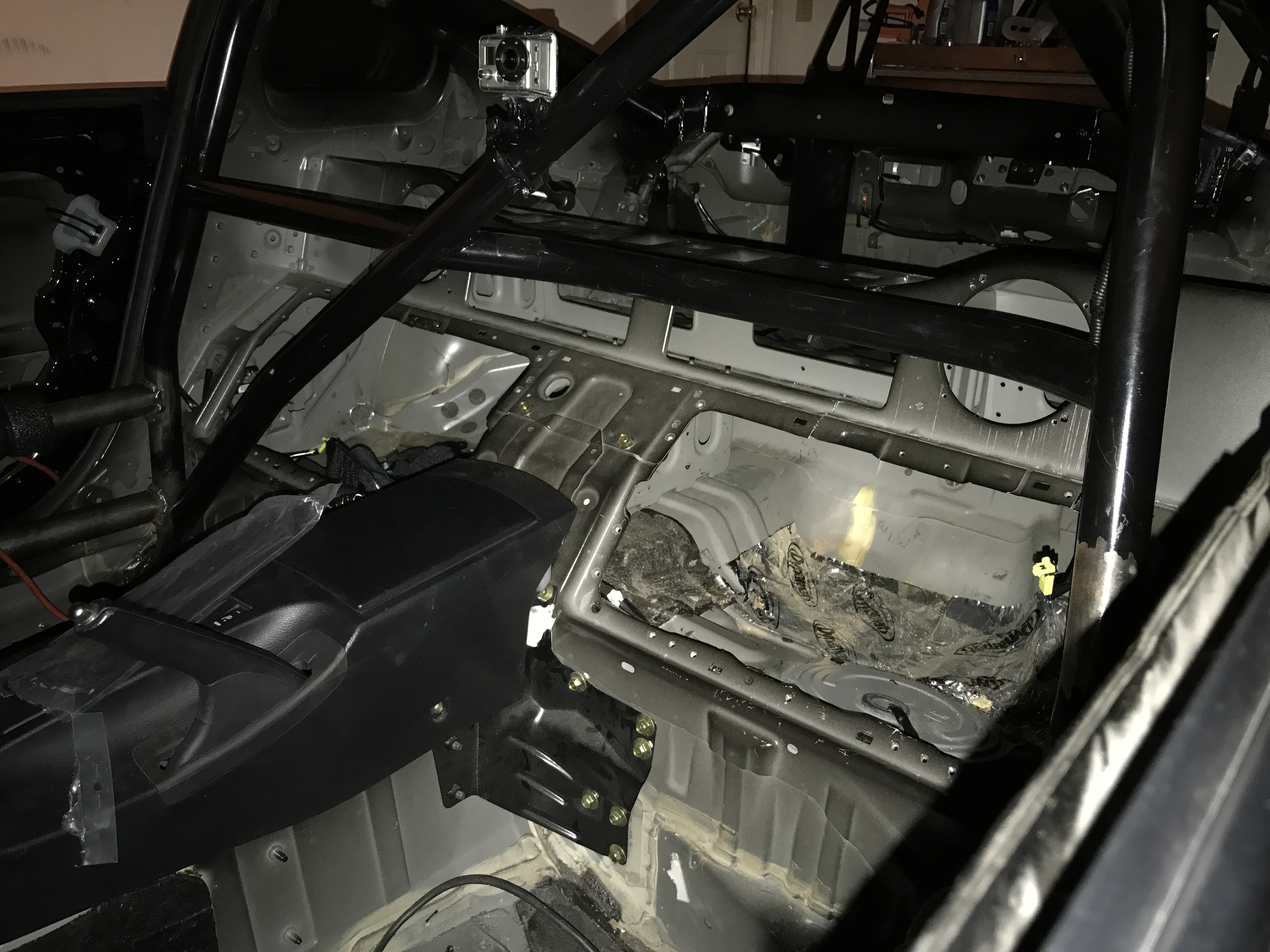

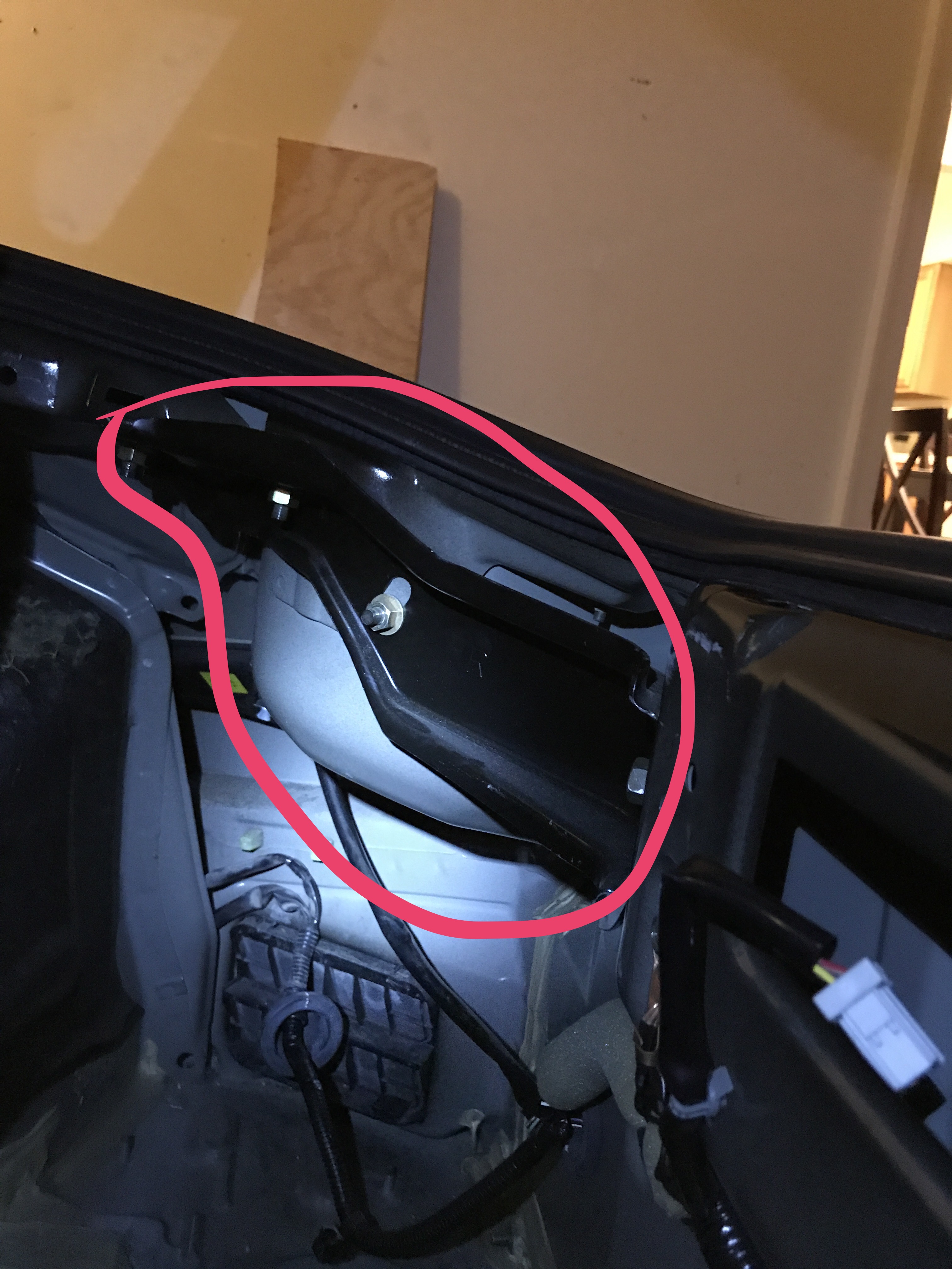

Removing the sound bar has been something I've been taking my time with. I need to go get some spot weld drill bits so I can finish this process. After this is complete, I will go pick up some dry ice and remove all of the sound deadening from the interior. After I do that, I'll be priming and painting the interior as well as the rest of the roll cage. Going for gloss black all over just to keep everything uniform.
Before cutting anything out:
In the process of cutting things out:

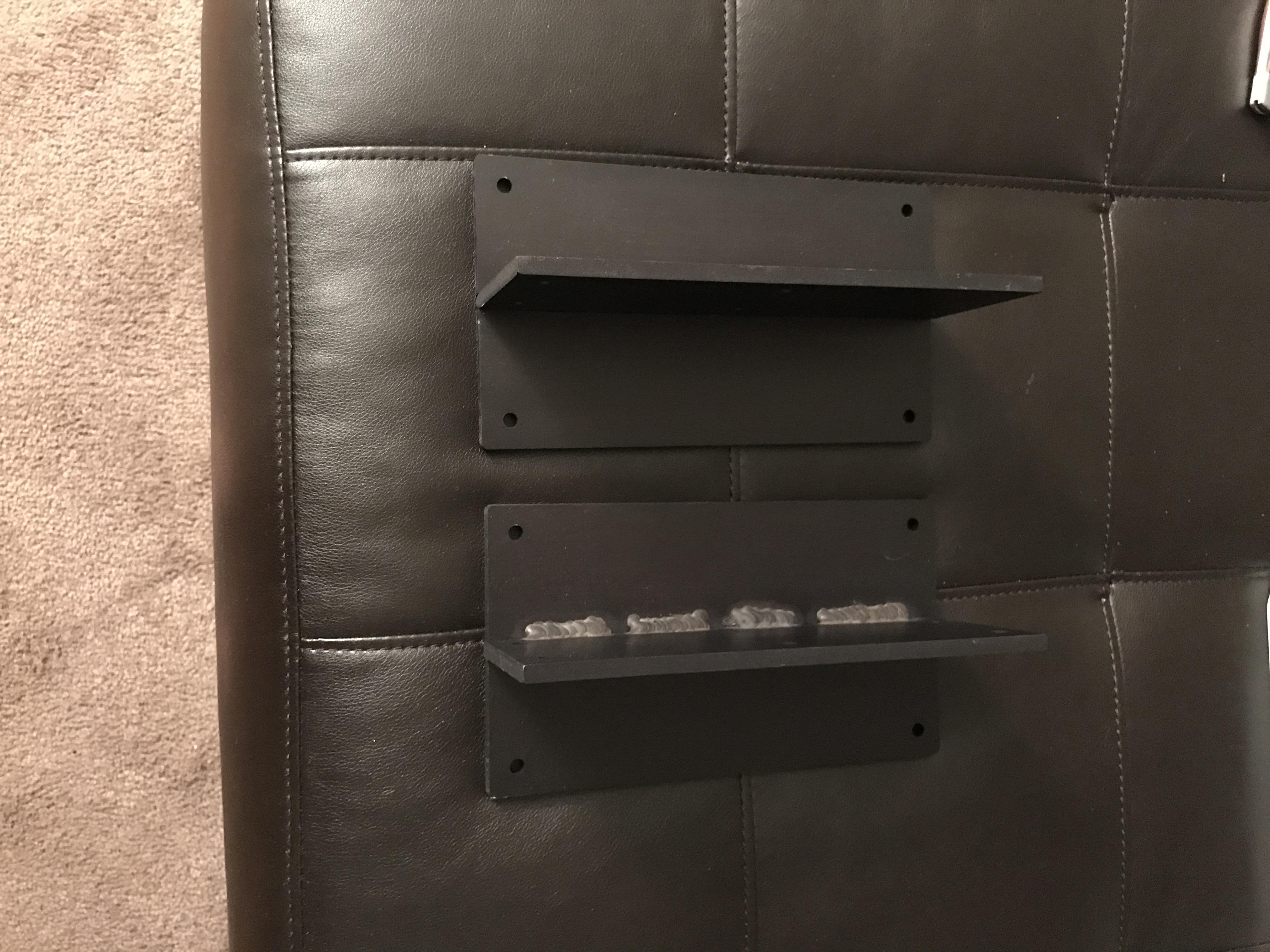

My Kognition wing came in, so I've been toying with marking that up as well. I want to mount that up before painting the interior so that I can make sure I'm not drawing on my freshly painted interior. This thing is incredibly difficult to mock up/mount, but it's coming along. I need to buy hardware for the mount to the frame, but once that is done, we will be squared away.
Base mounts:
Wing stands:
Wing element:

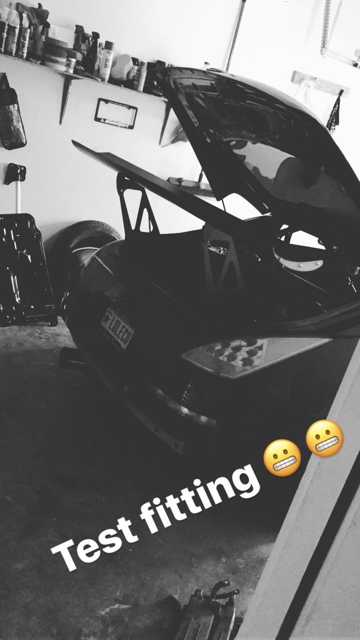

Test fitting picture. I realize the wing is in the stands and the hatch is open. This is because I am test fitting/mocking where the stands will sit so that it can be accurate, then I need to put some toothpaste or something on top of the stands, or crawl in the hatch while the hatch is closed and mark out where I'll be cutting at. Probably the latter as it'll be more accurate that way.

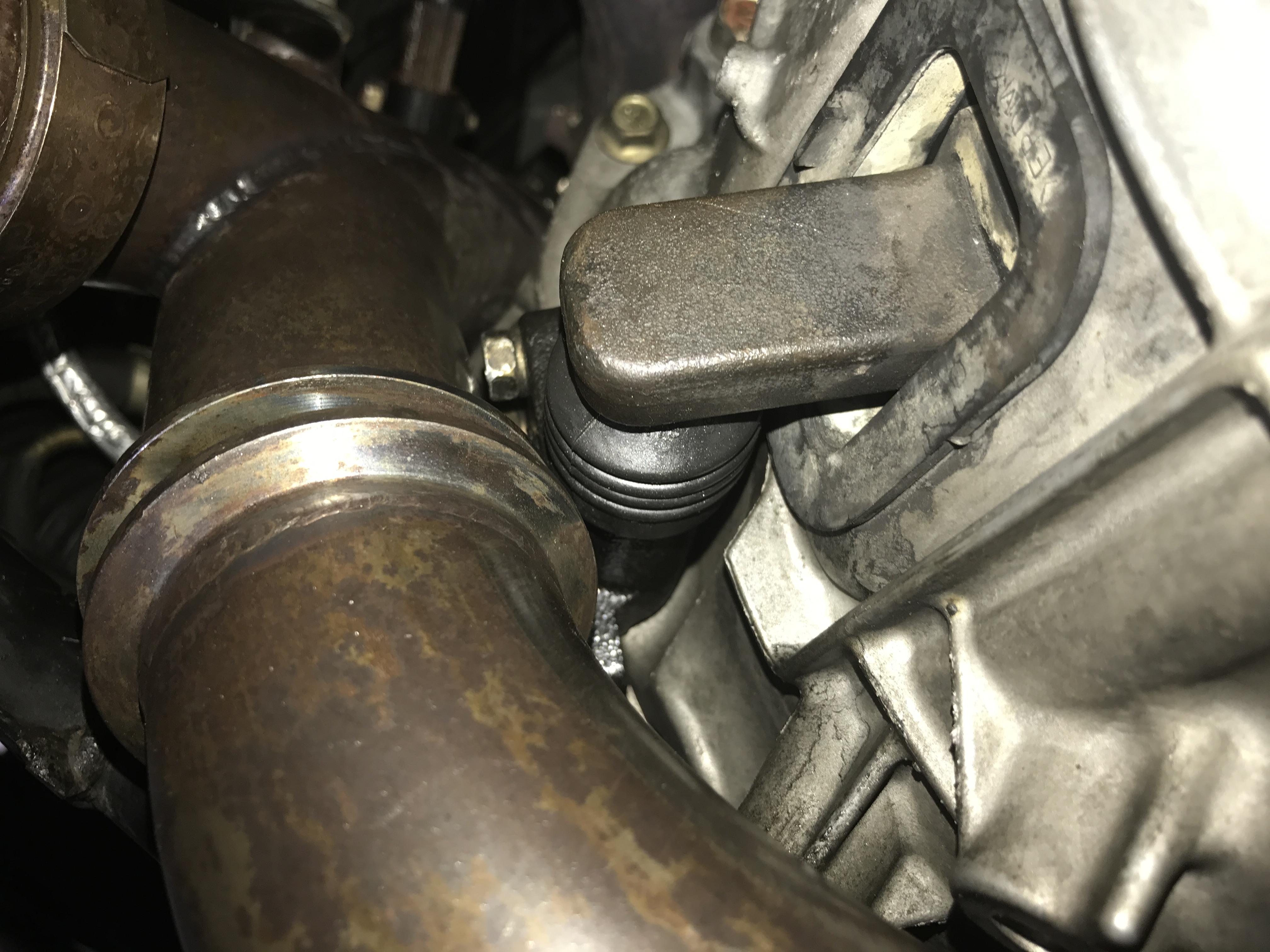

Pics of the crossover pipe to up pipe not mating properly due to the AT/MT difference. Going to have the guys at Dynosty fix this. It needs to be pulled further away from the slave cylinder so I'm not overheating my slave again. Need that to stay cool so I can actually put down laps...

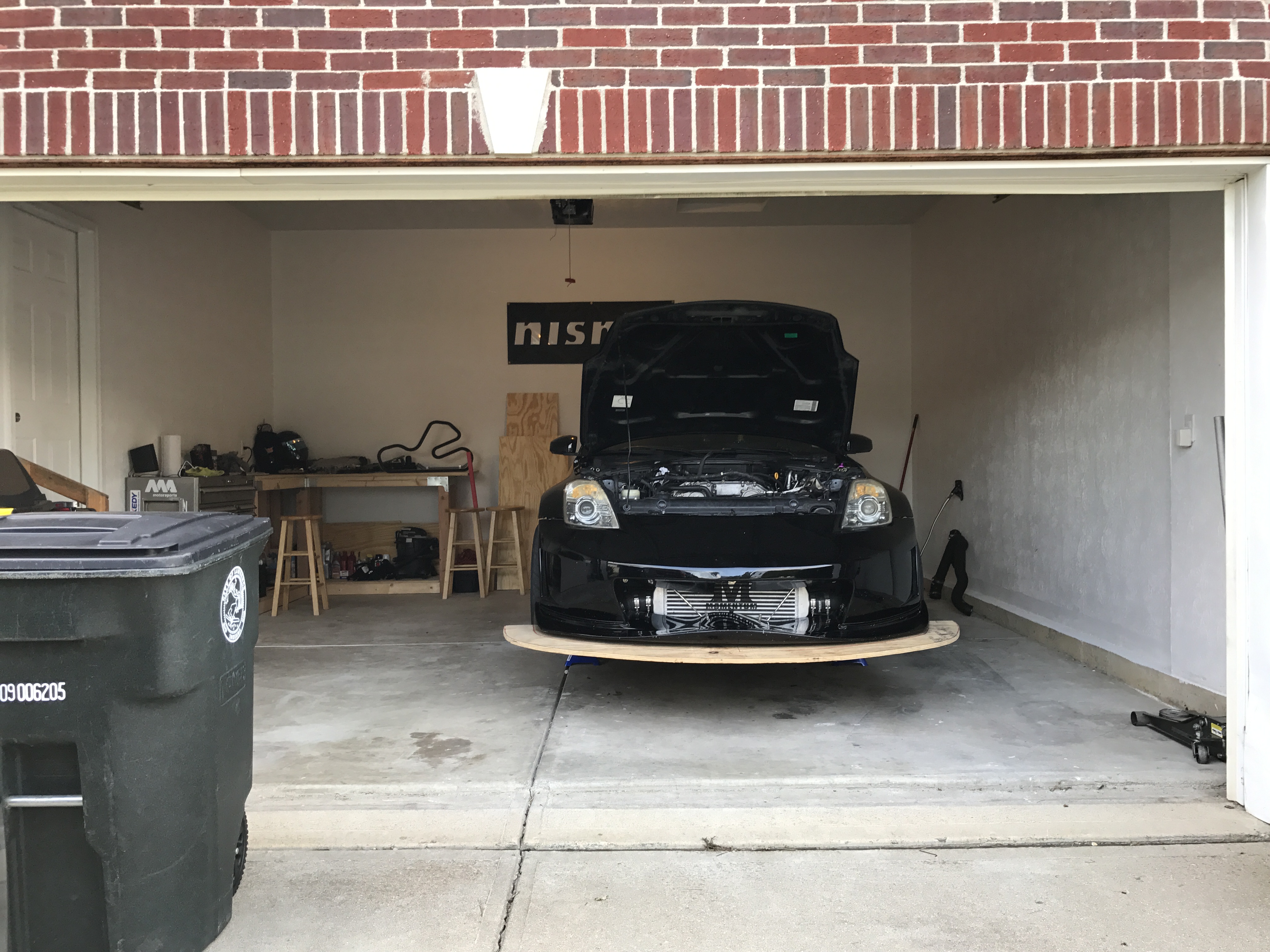

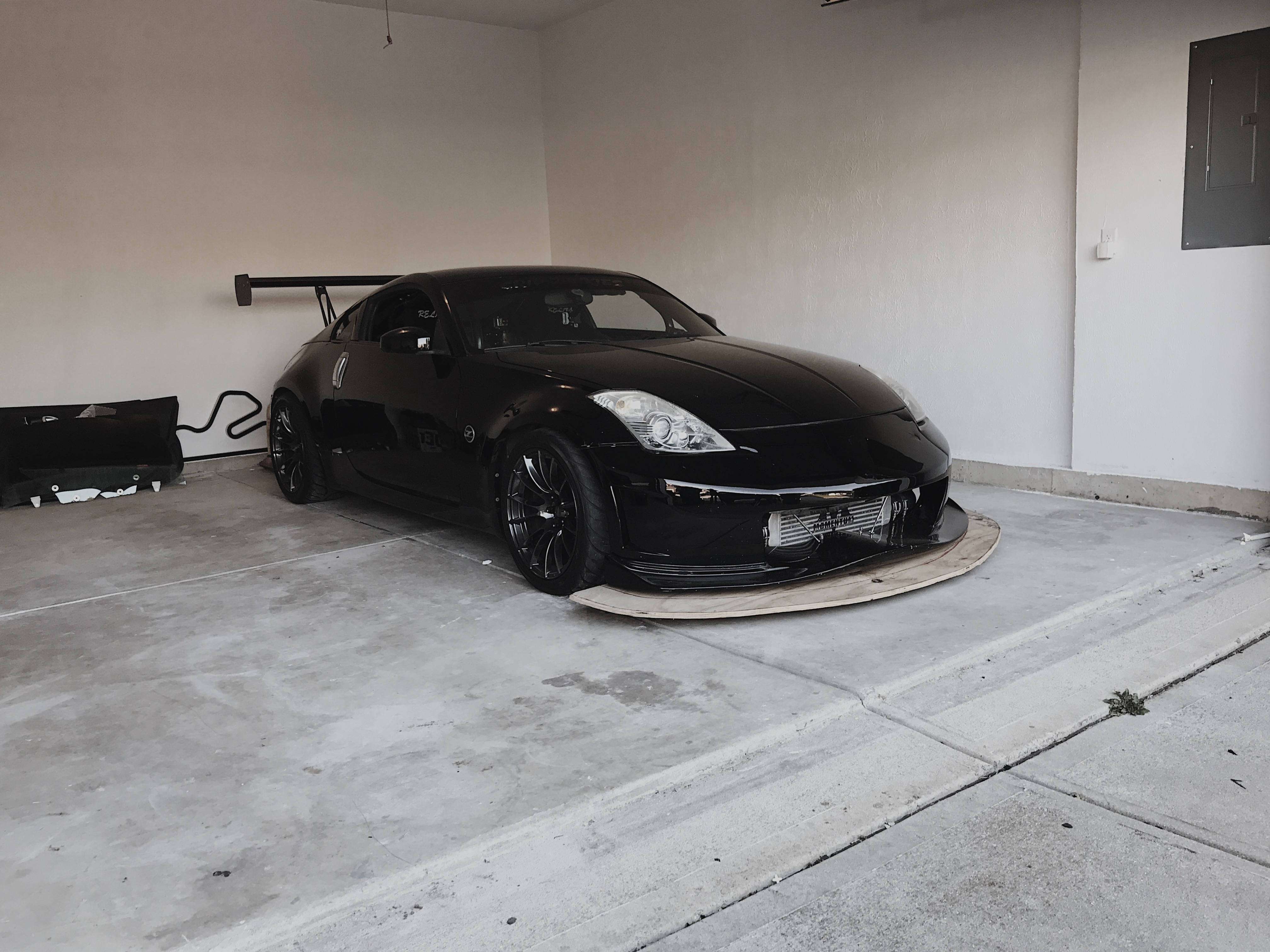

The new garage is amazing, TONS of space (which I've never had). Two car bay, really tall ceiling and enough room to fit the Z with a 5" extended splitter, 12" extended diffuser, and still have ample room to walk around the car.

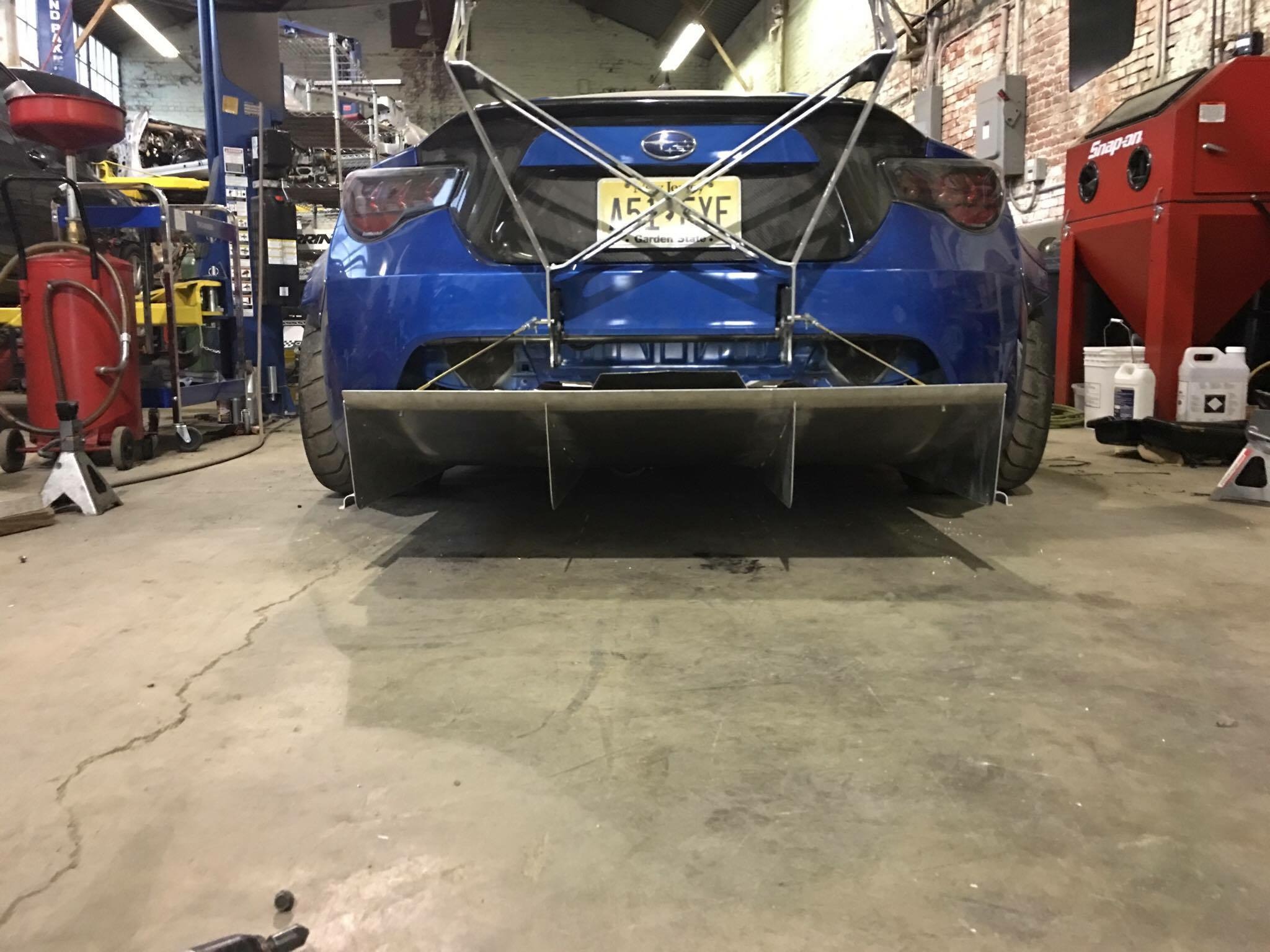

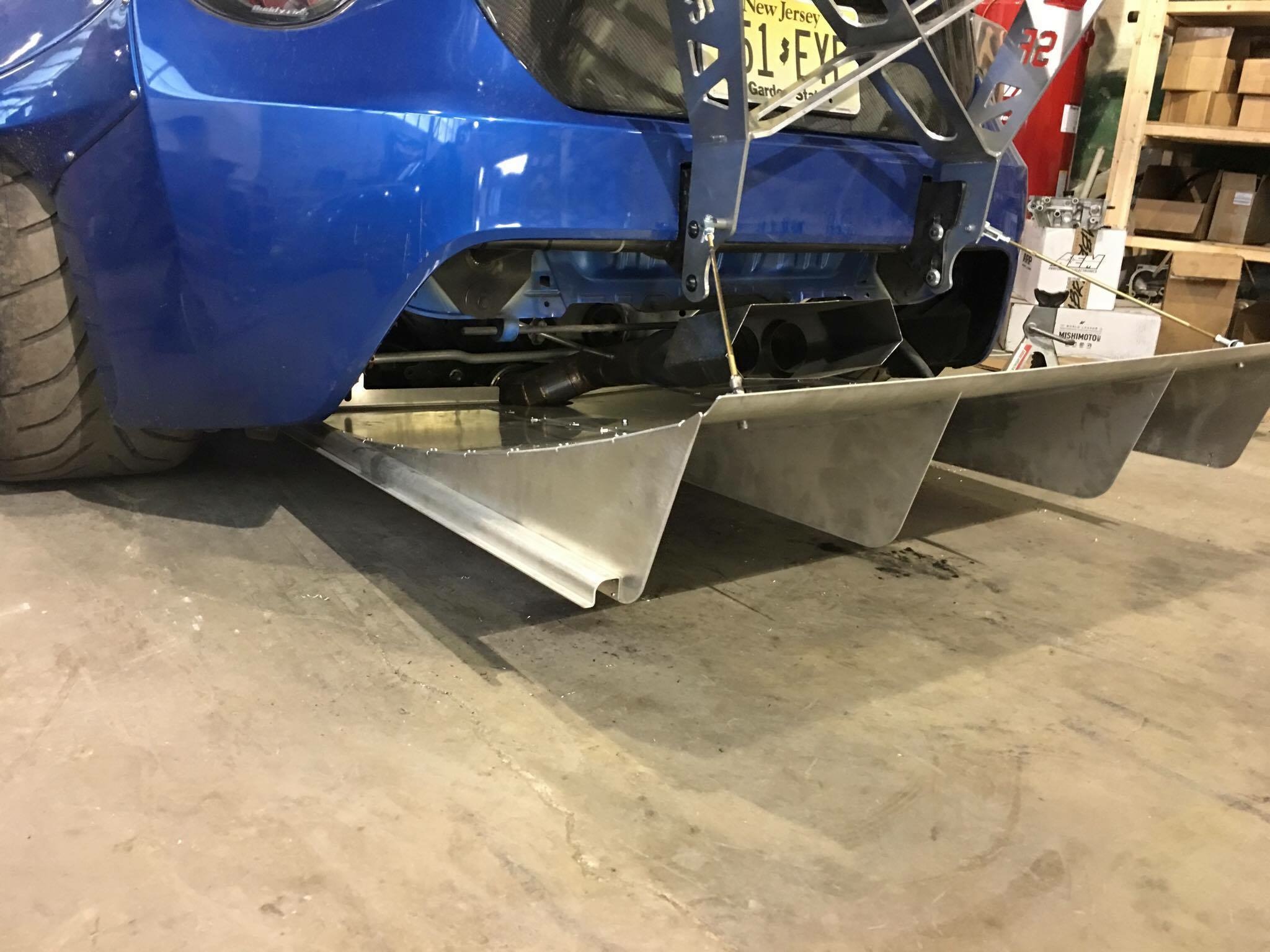

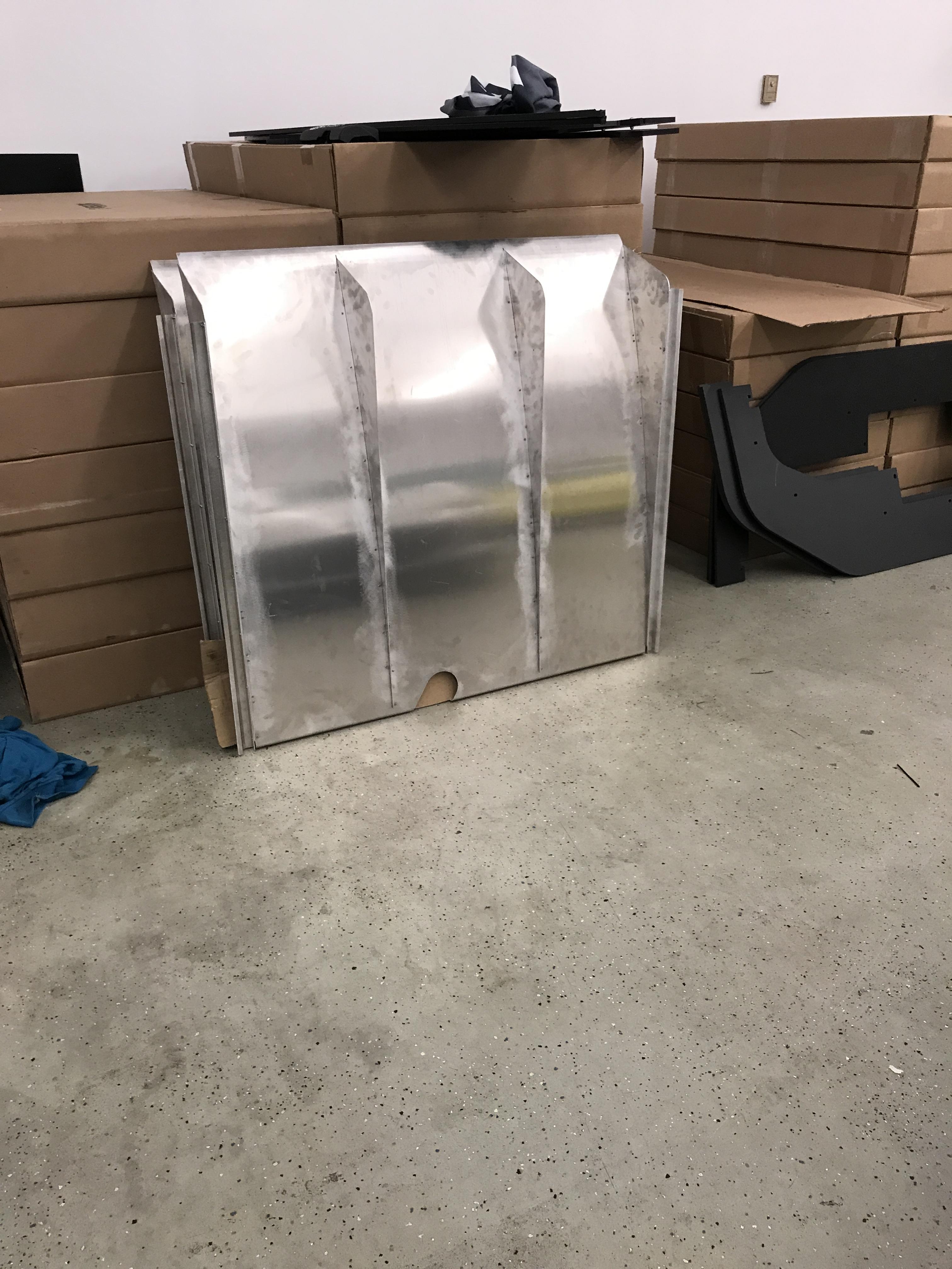

Here's some diffuser pics. The diffuser is from a company called Velox Motorsports (going through a name change soon I think?). This diffuser was made for the GT86 chassis, but they had one lying around and I wanted to test fit it.
For reference, this is what it looks like on the 86 chassis.

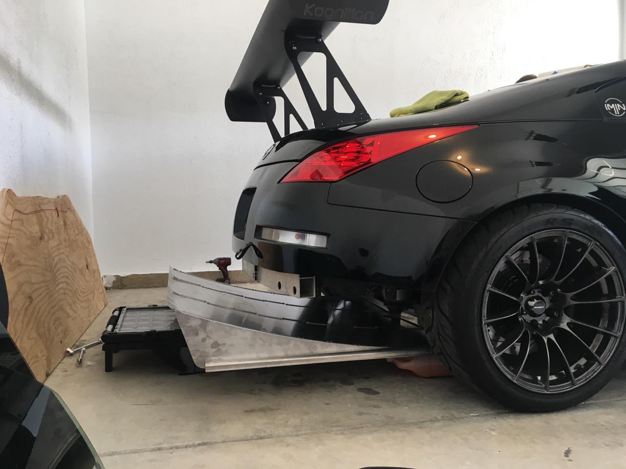

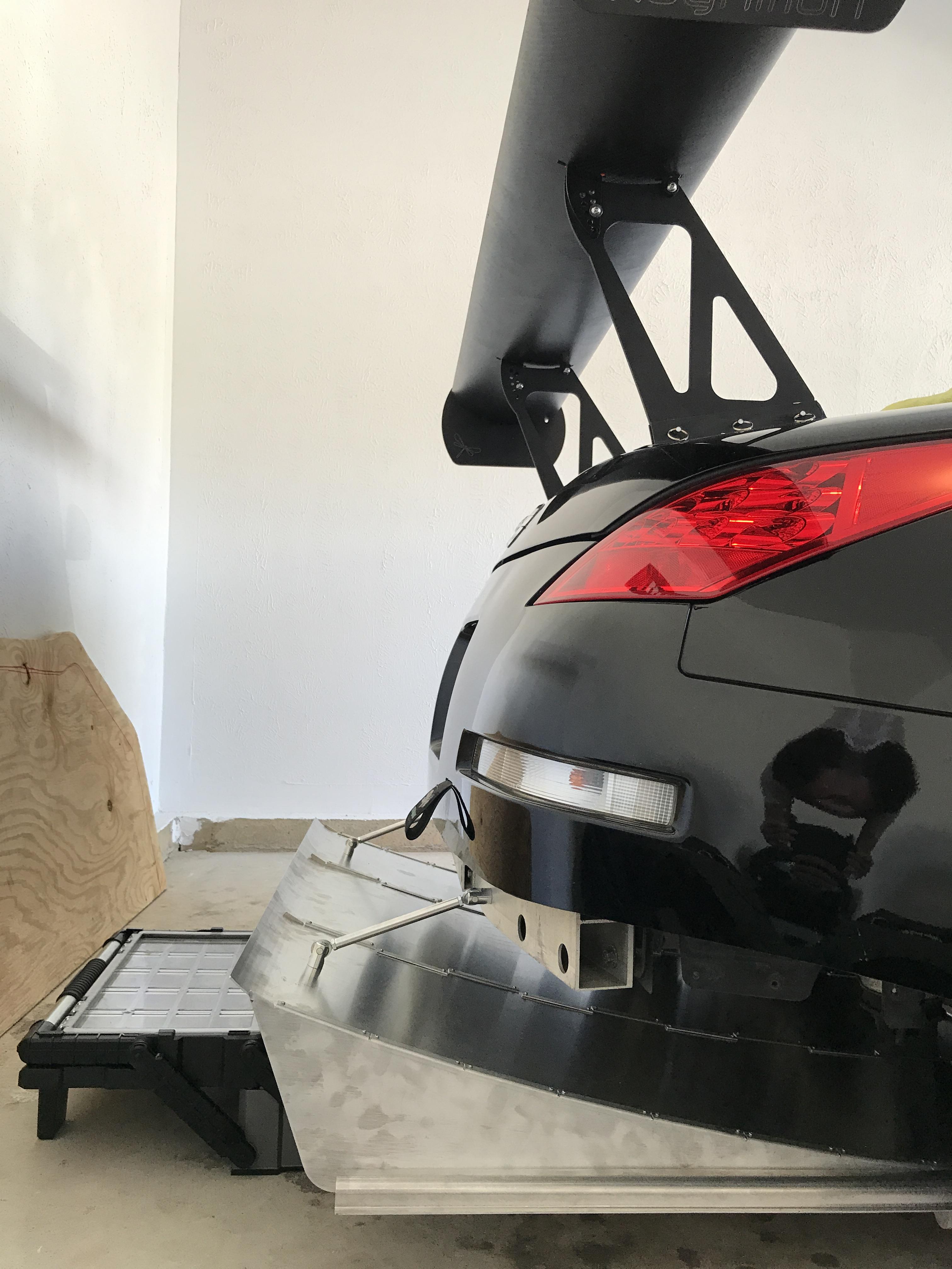

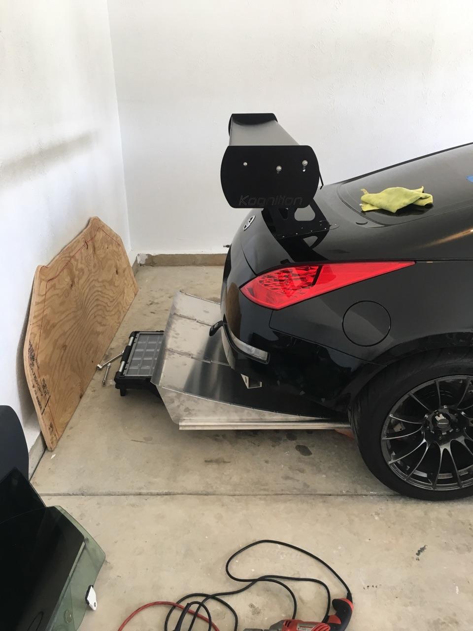

This was our first test fit (we ended up pushing it further towards the axles). Thankfully our cars are longer than the GT86
This is where we pushed it to. Since it mounts fairly low, being below the spring buckets should not cause any issues at all. We've checked travel at full droop and we've got plenty of clearance. Plan is to mount the front of the diffuser to the floor of the chassis. We'll be running aluminum up to the chassis with 90 degree bends for the chassis side, and then we will have a hole drilled in the aluminum for the part that mounts to the diffuser.
I went ahead and installed some splitter support rods for the rear to keep it in place as well. These extend further back so that we can adjust the height of the diffuser to where we want it. We're looking at about 4.5" clearance at the moment (the picture is probably 3.5"). The diffuser will slide back a bit further to give it the extra clearance, and then we will mount it to the chassis at a level height.

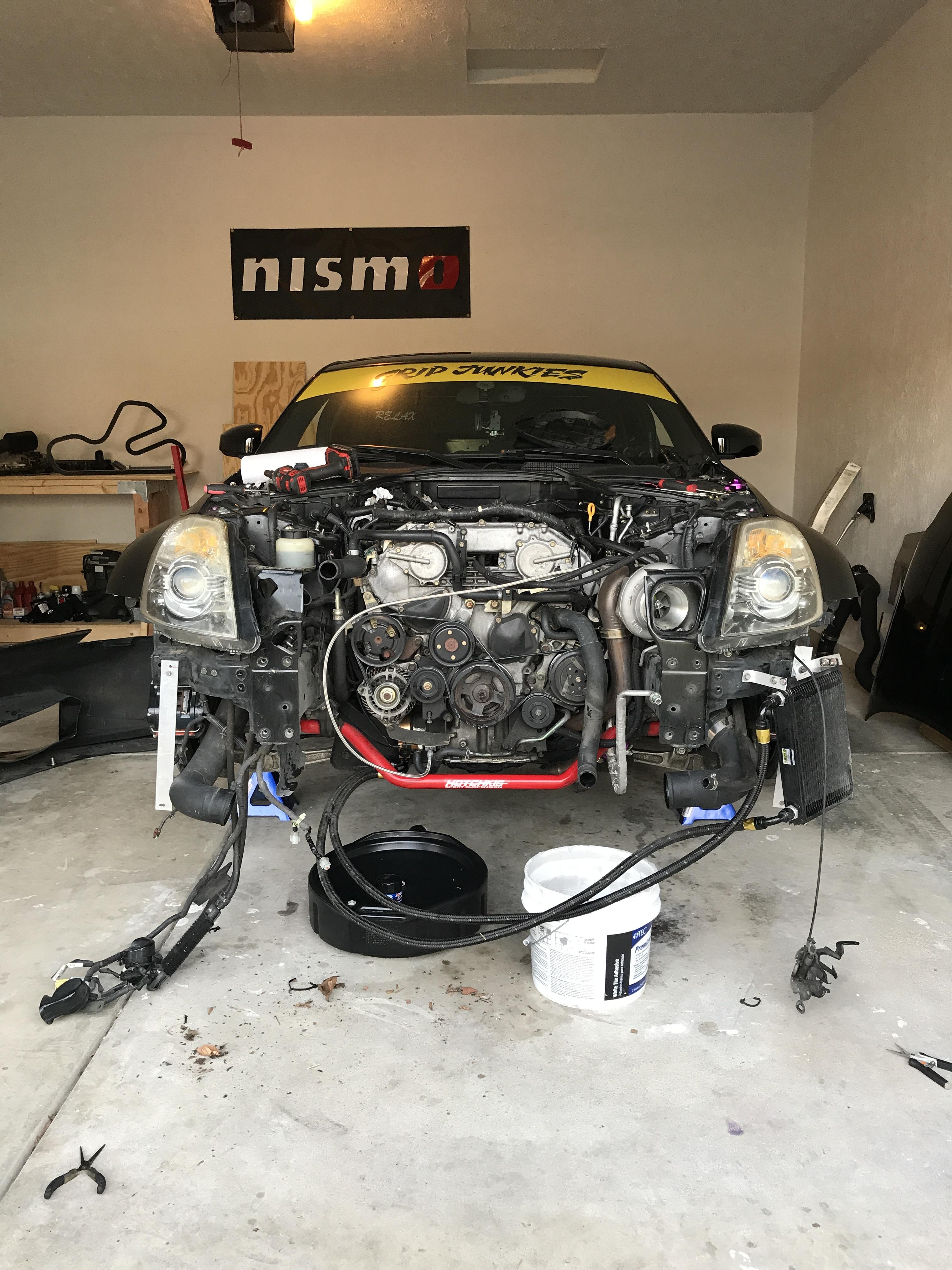

So this is where we started at the beginning of the week:

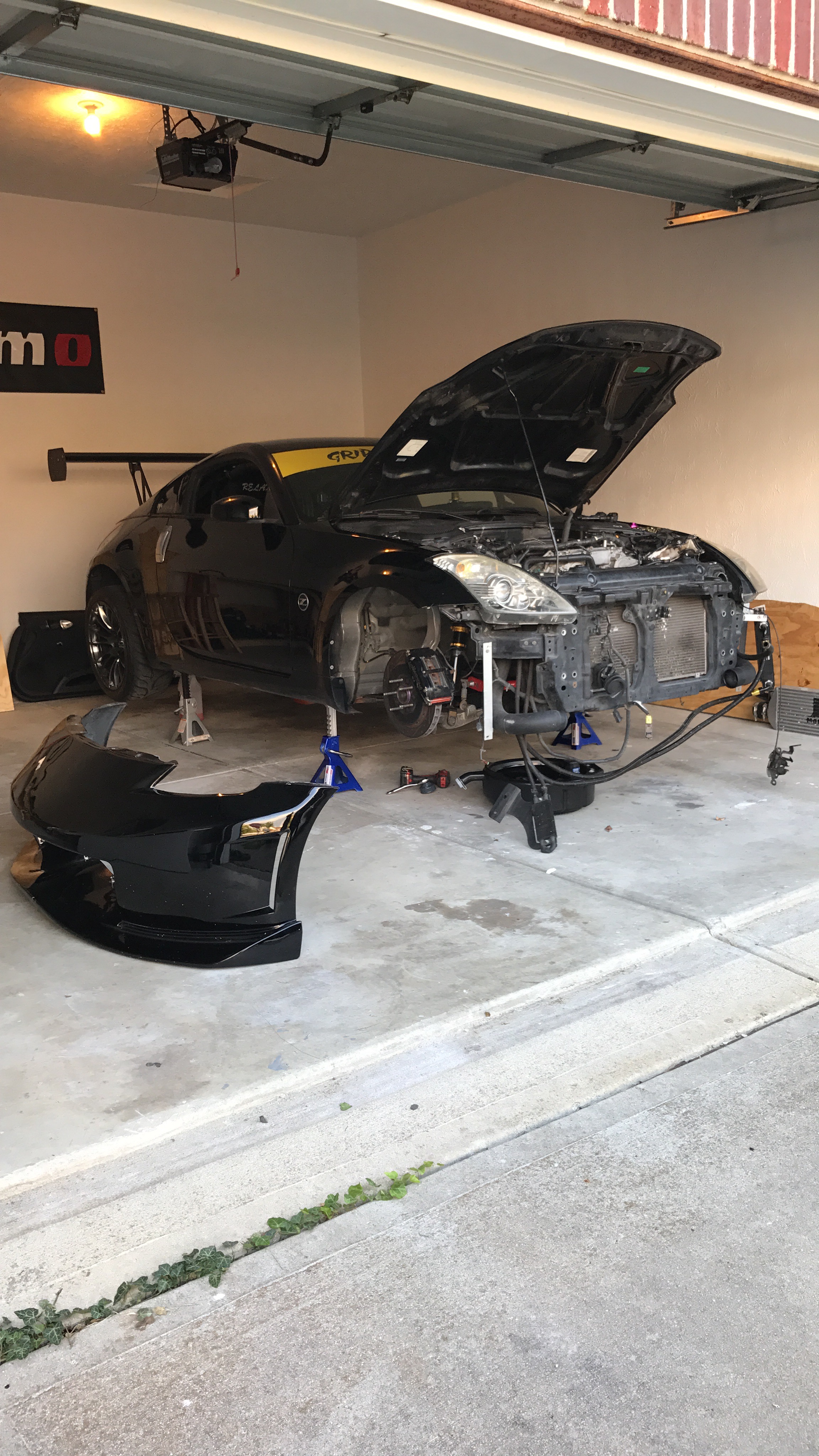

Two days ago I got back in the garage and starting pulling things apart.
And this is about where I left off yesterday.
With the help of a friend this is the progress of the week (but plan on making a lot more progress next week of course). I'm also planning on getting some work in tomorrow to try and HOPEFULLY get the driver's side head off of the car and see where I'm at with the engine.
