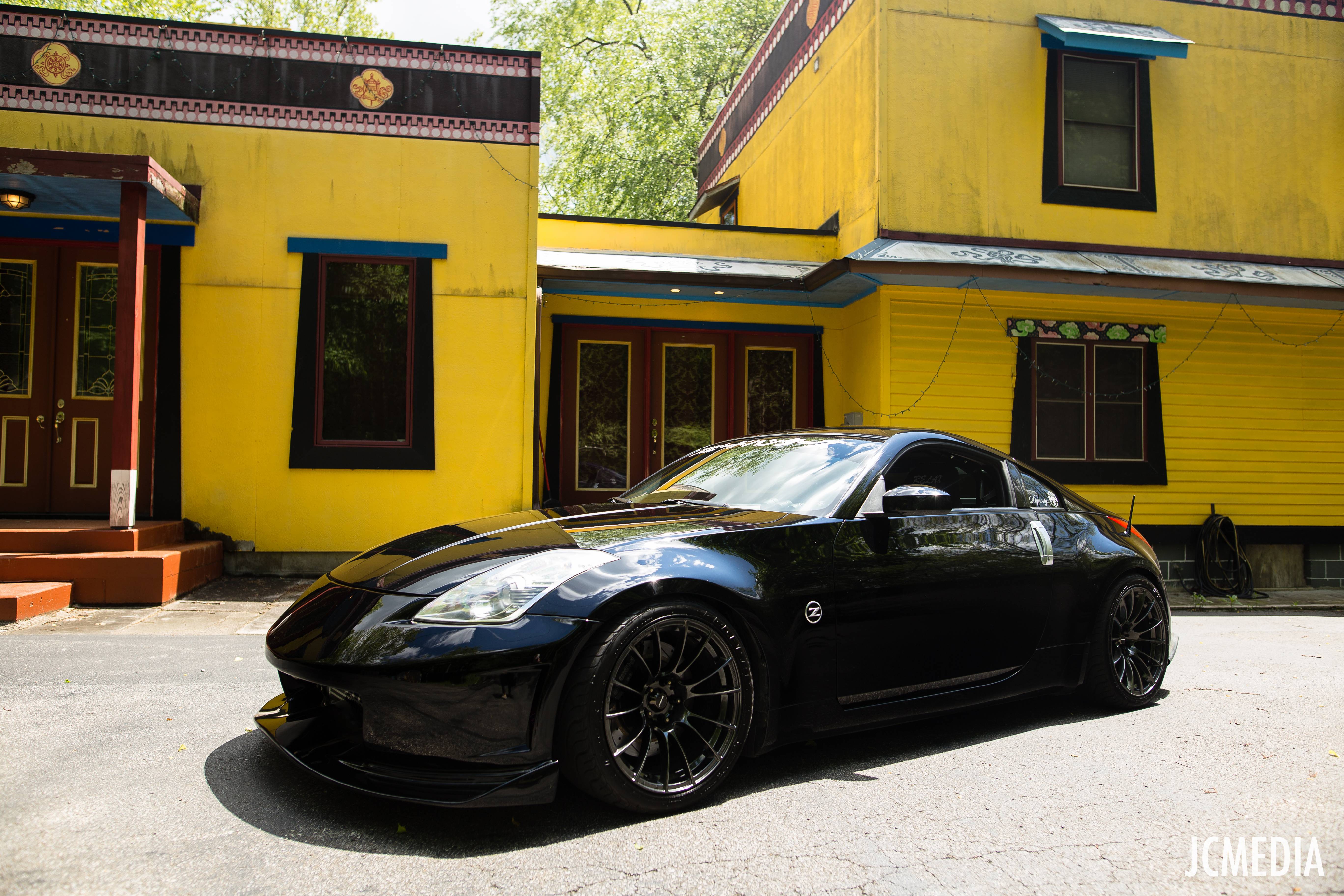

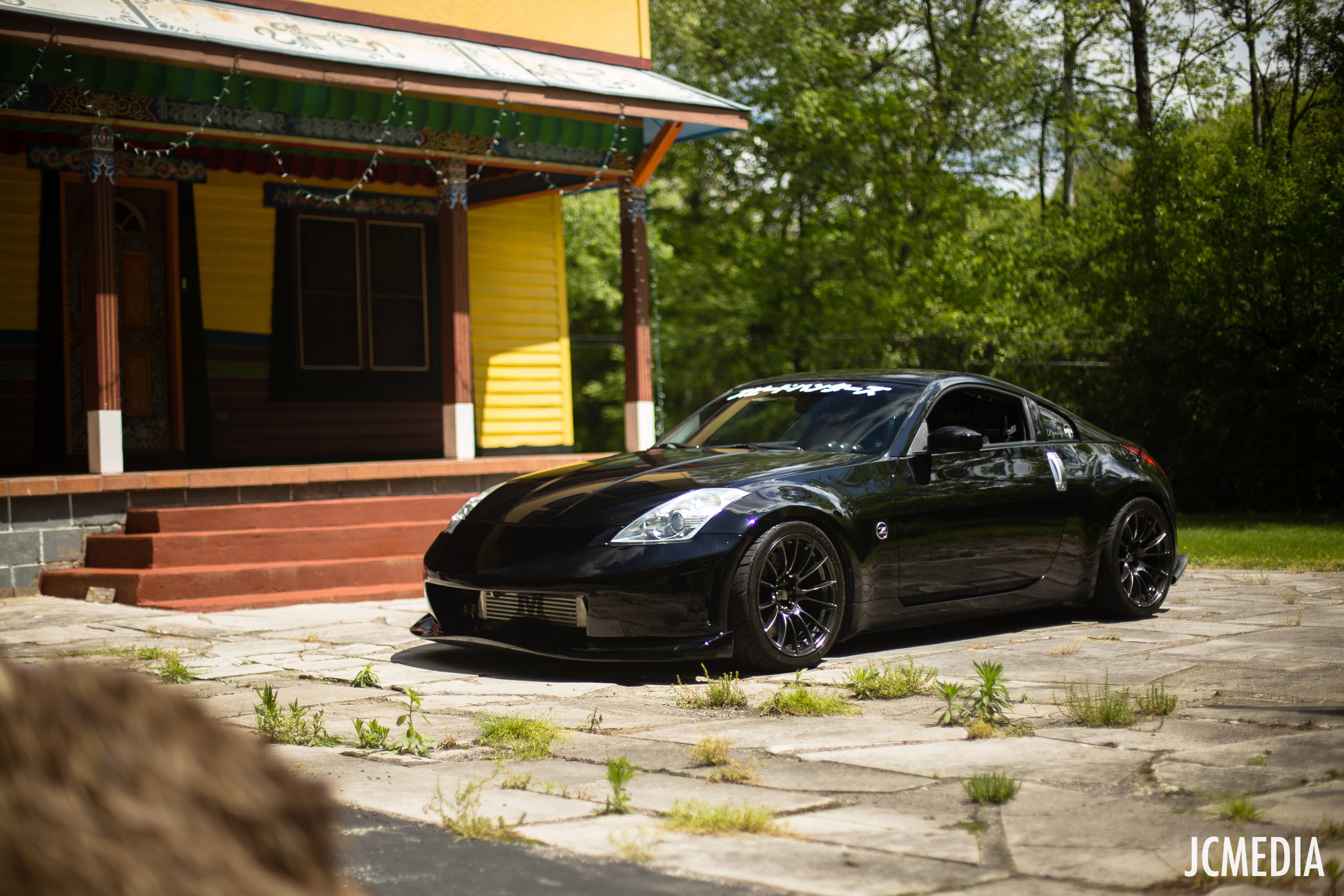

UPDATE TIME!
So let's just start this off right. (Note that this is essentially me reviewing this bumper).
Look at it. Just look at it. At first when I got this bumper, I was like "wtf is this big box at my door?" Then I realized the kind folks over at APTech hooked it up and gave me a sweet opportunity to work with them.
It took me forever to get this thing fitted on the car because I didn't have a very good way to cut the bumper without taking 12 years and being unstable (dremel). So I needed a grinder. I ended up just marking the area that needed cut and sent it off to the body shop to let them do the work.
Overall, the bumper is great. I love pretty much everything about it and the way it looks. I did have what seemed to be a fitment issue at first, but that later turned out to be me being an idiot and not realizing that the fitment issue was due to my oil cooler. So I had to adjust that a bit to get it fitting right.
After getting everything to fit up right, it was time to get this sucker over to paint. Loaded it up in the trusty ol' pathfinder and away she went. Now, I'm saying this because if any of you pick the bumper up, make sure you tell your body shop to add plenty of flex additive into the paint so that it can move on the bumper. The reason that I say this is because the lip that is attached to the bumper flexes on the inner corners of the bumper, and this can cause the paint to crack if there isn't enough flex additive in there (ask me how I know
Since installing the bumper and while test fitting it with my friends and roommate (which I owe so many thanks to for the pictures), I instantly started receiving compliments on how much nicer the car looked with a proper and aggressive bumper. It's something about the way that this bumper looks that makes the car look so much more aggressive and just overall so much more proper.
Also to add to that, I've noticed a LOT of people gazing at the car as I'm driving by as well. Whether that is because of the bumper or not, who knows, but I can definitely assume so since not much else has changed exterior wise and I didn't get this many looks previously.
Overall, I would say the fitment is about a 9.5/10. Since I didn't have much help putting it on last time, it took some work to get it to fit properly on both sides and line up with the fenders, but with a little work it will definitely get there.
As far as quality, absolute 10/10. This thing is aggressive and as beautiful of a bumper as the Z needs (especially for us FI guys with intercoolers). It just adds an extra dimension of aggressiveness to the car.
If anybody has any questions or hesitations on picking one of these up, I say go for it. Shoot APTech a message and let them know that Quinton sent you

Dude the pictures are ****ing great man, very nice, need more pica of bay and interior!
Is it the paint or the clear coat that cracks...never had that issue before.... I used 72500s clear anyways...

It's the paint itself that is cracked. It's like flaking off, I really need to call my uncle and have him fix it because it's starting to really bother me.
