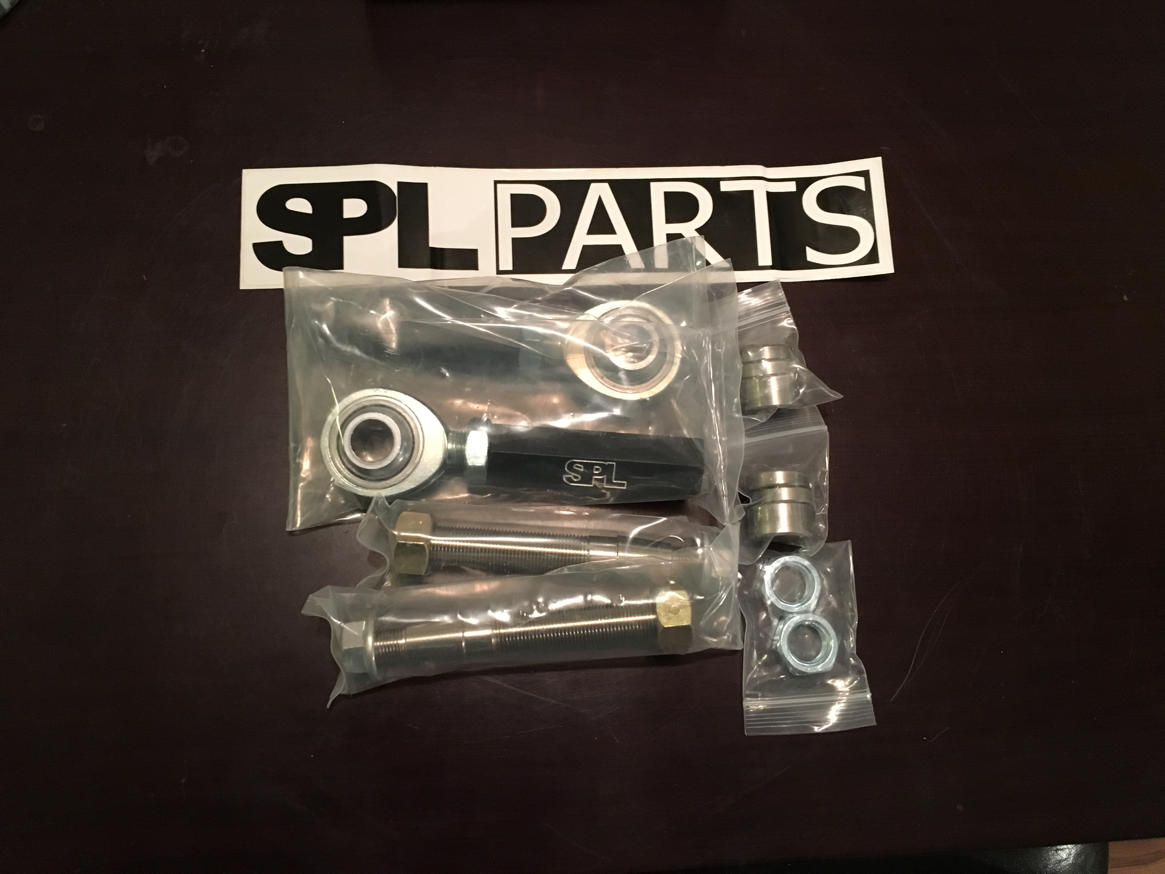

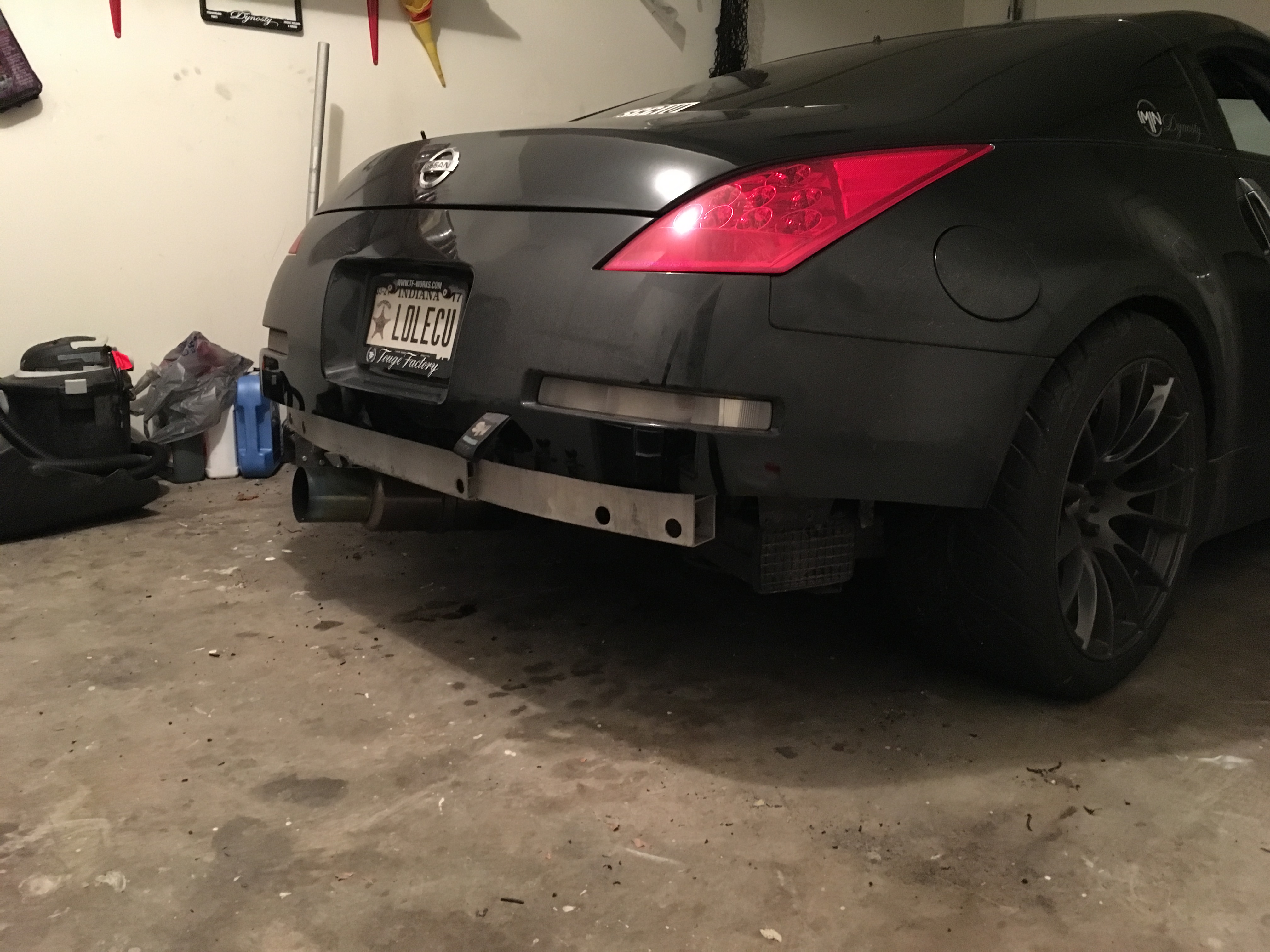

So I guess we will start with some parts that I ordered during black friday that showed up. FTR Splitter Rods 9.25-11" length for when I build my front splitter (to balance out the wing), Z1 coolant hoses (doing my cooling system eventually), SPL outer tie rod ends.
I ordered the tie rod ends because I thought I had a clunk coming from the tie rod ends (they were going bad, I could wiggle them with my hands, but I wanted to fix the noise primarily). Unfortunately, it did not fix the noise, but hey - now I can adjust my bump steer!
I can't lie - these are by far the NICEST support rods I've seen so far. You can tell these are quality when you hold them and when you adjust them, so smooth and perfect. The APR ones are like a toothpick compared to these. Thankfully I'm just using the APR ones for the bumper's center portion, and these support rods will actually go to my front splitter.
Coolant hoses just because they were cheap lol.
SPL for the win, such quality products as always. I need to get all of the other SPL goodies as well. Maybe switching to Moton at the end of next season, so unsure if I'll buy the SPL midlinks or wait until I go Moton (true coil) and just run the toe arms (most likely). Definitely need the front camber arms, my car is maxing out at -2 degrees of camber front right now.

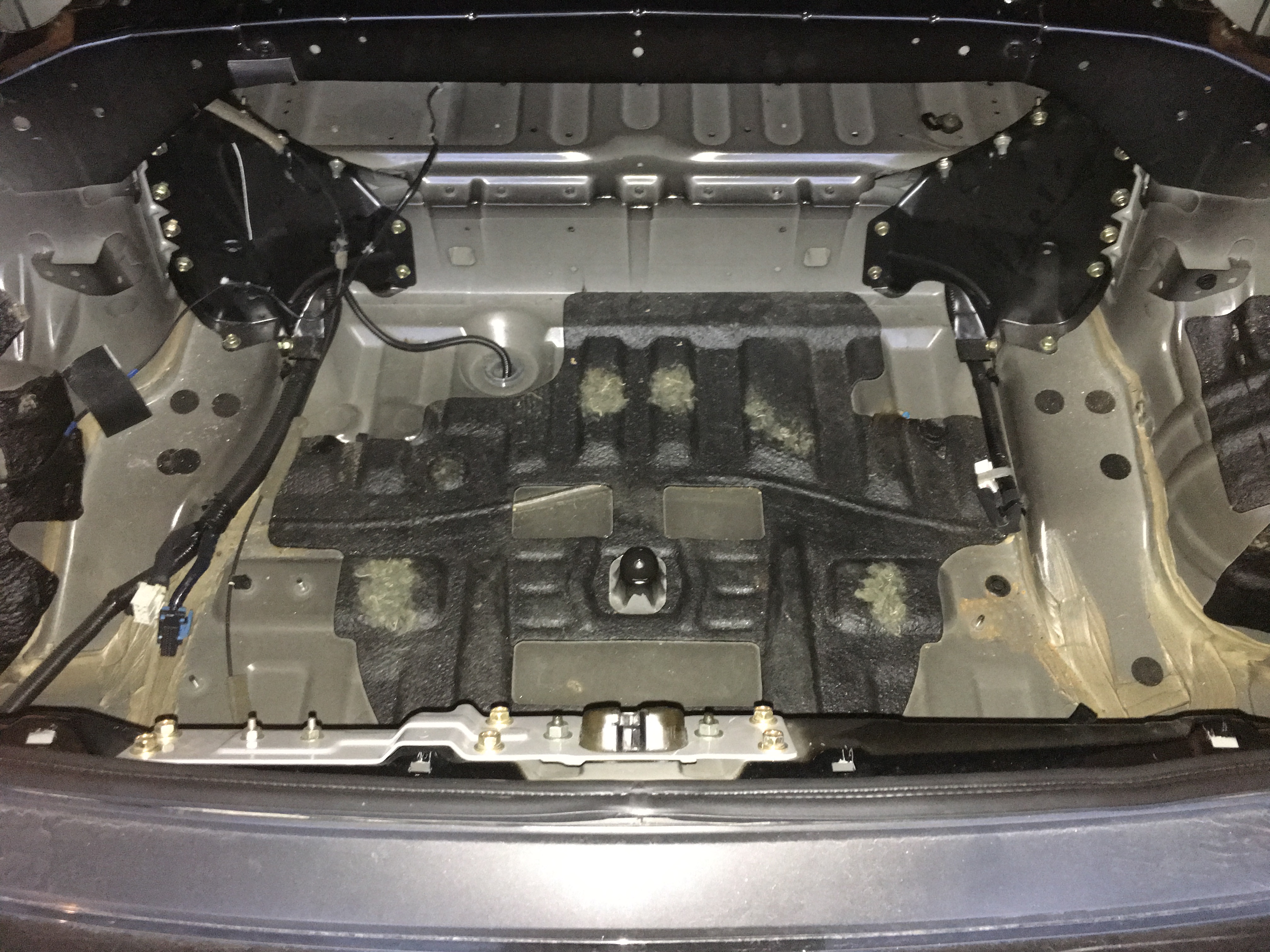

A couple of weeks ago, I started gutting the car. Remove all of the rear interior bits, now left with this...
Now all that is left is to cut out the rear speaker bar metal, remove all of the sound deadening, remove unnecessary wires, remove the front carpet, remove the headliner, remove all of the unnecessary wires up front/airbags/etc, and then paint the interior black. A lot of work to go, but should be good to go come April.

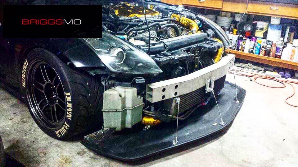

Some inspiration for front splitters:
I love this one, but don't think it's too possible due to my undershroud. Still working out how I'm going to do this. Thinking of running metal along the core support at the bottom and then attaching to that by adding rivnuts and drilling through the undershroud.

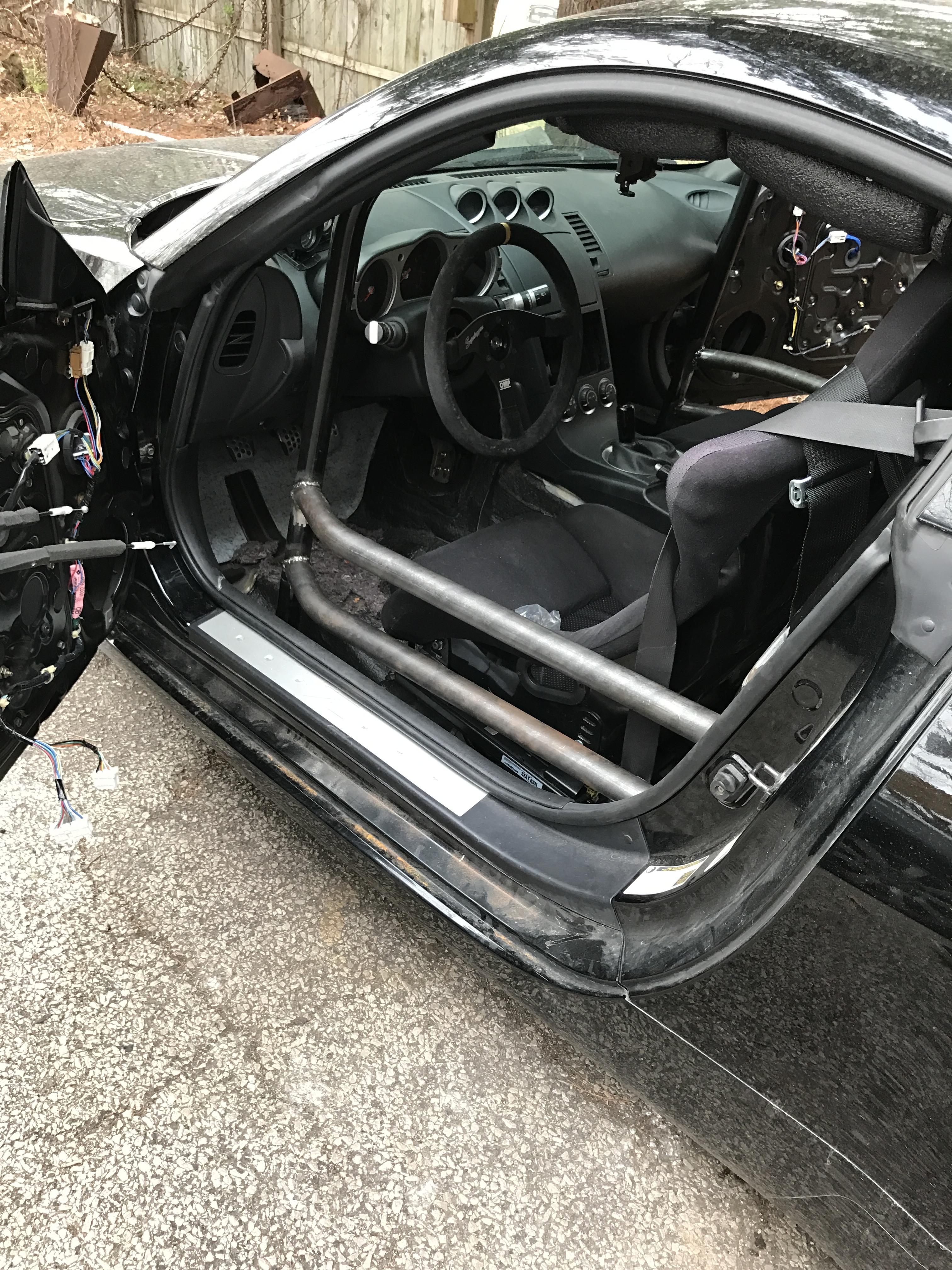

Door bar stuff. Huge thanks to my buddy Chuck for throwing these in for me and putting in the late night hours to work around my schedule and help me throw these in. Had to notch the bars using his bridgeport, then welded them in. Placement is perfect, and there is padding on top of the bars now. Going to paint them when I finish gutting the car (car is stored in a climate controlled garage and everything will get taken care of shortly!)

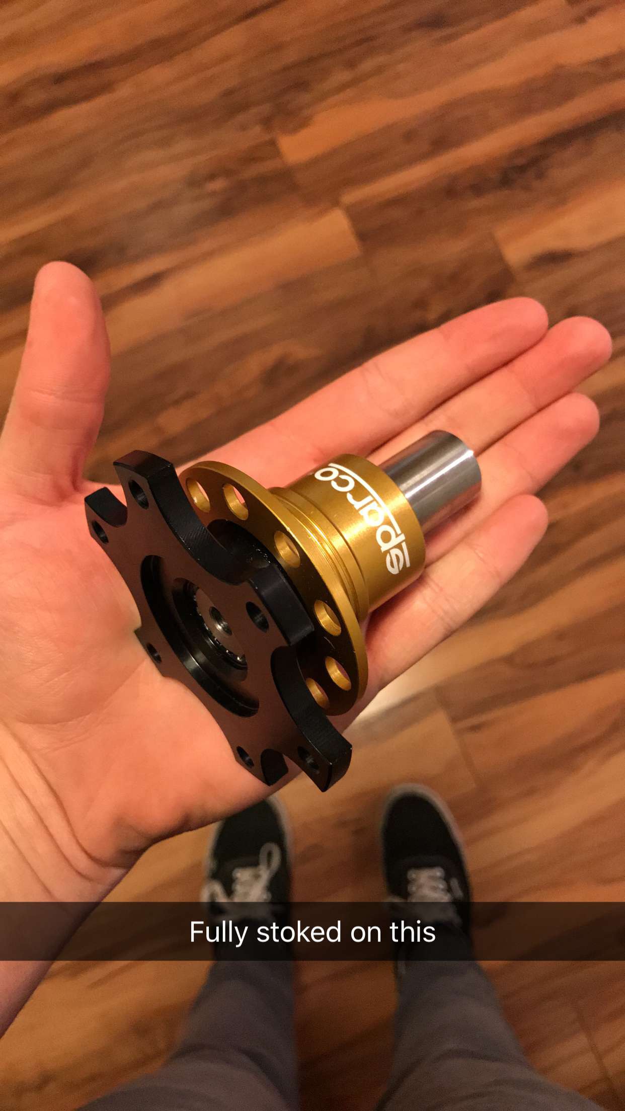

Quick release:
How it looks on the OMP Velocita Superleggera
Going to gut my doors here soon (getting rid of the windows/window regulators and cutting out the wires, etc. Going to place some screws in that allow me to sit the windows in during rain sessions.)

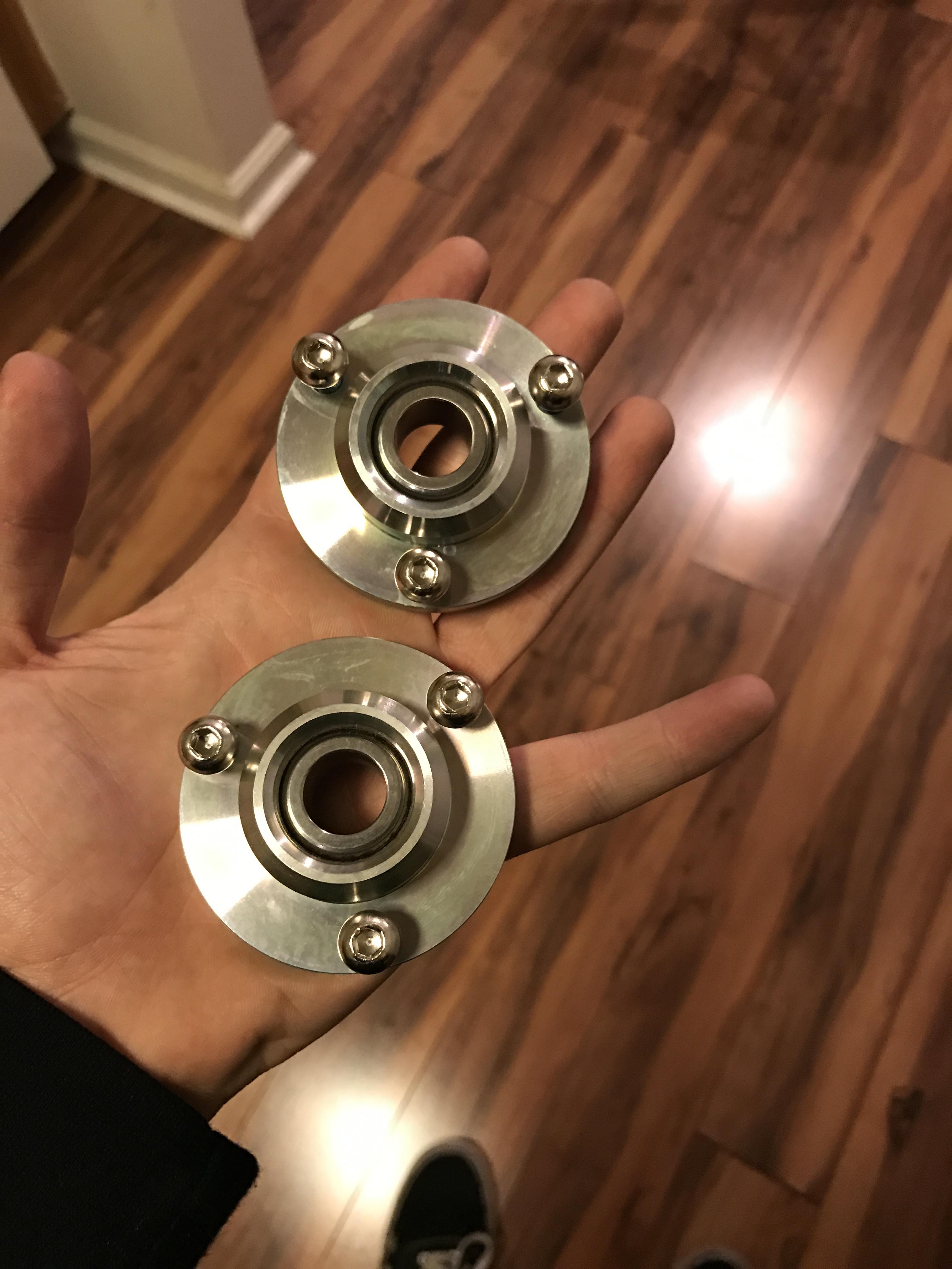

Also something that happened at the end of last season, my spherical top bearings went out on my HKS Hipermax IV SP coilovers, so I spoke with a friend and had some English translated over. Spoke with Yabe-San over in Japan about getting some replacements and got these mailed to me for free (seriously so kind of them and I couldn't be more thankful).

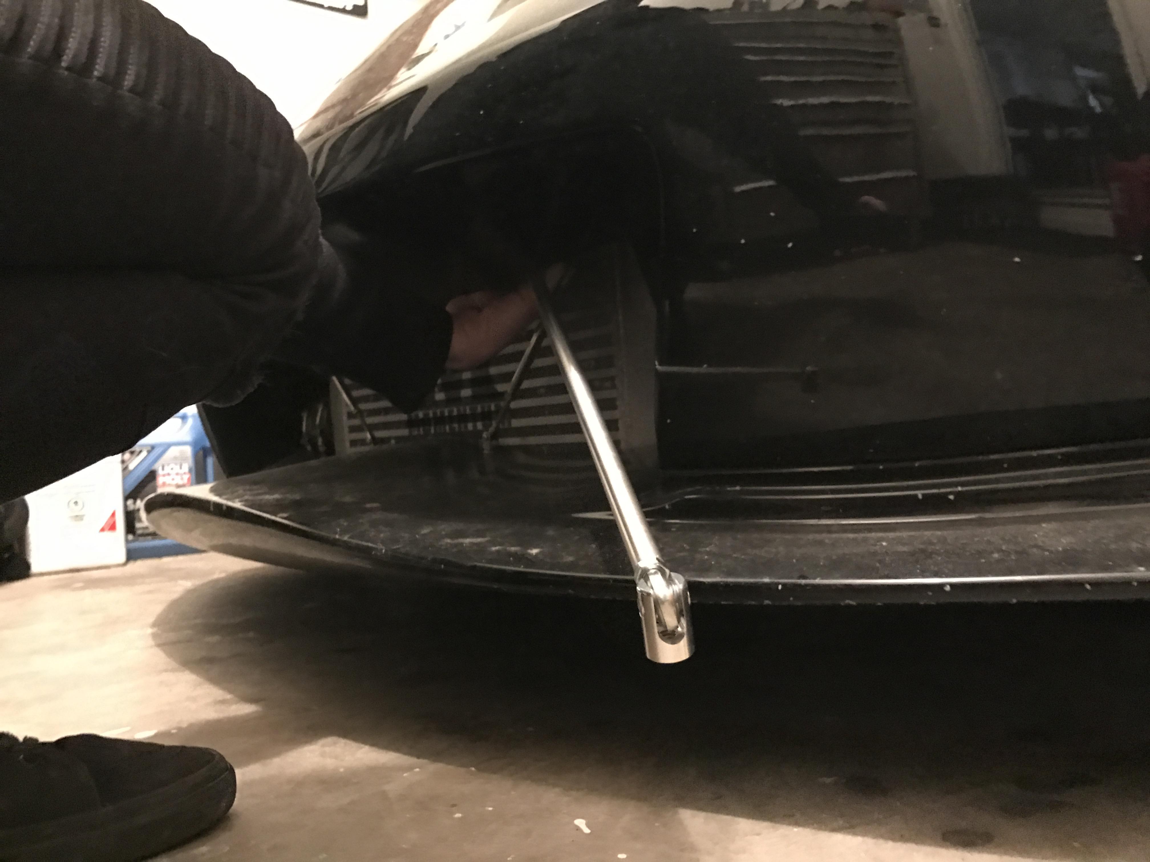

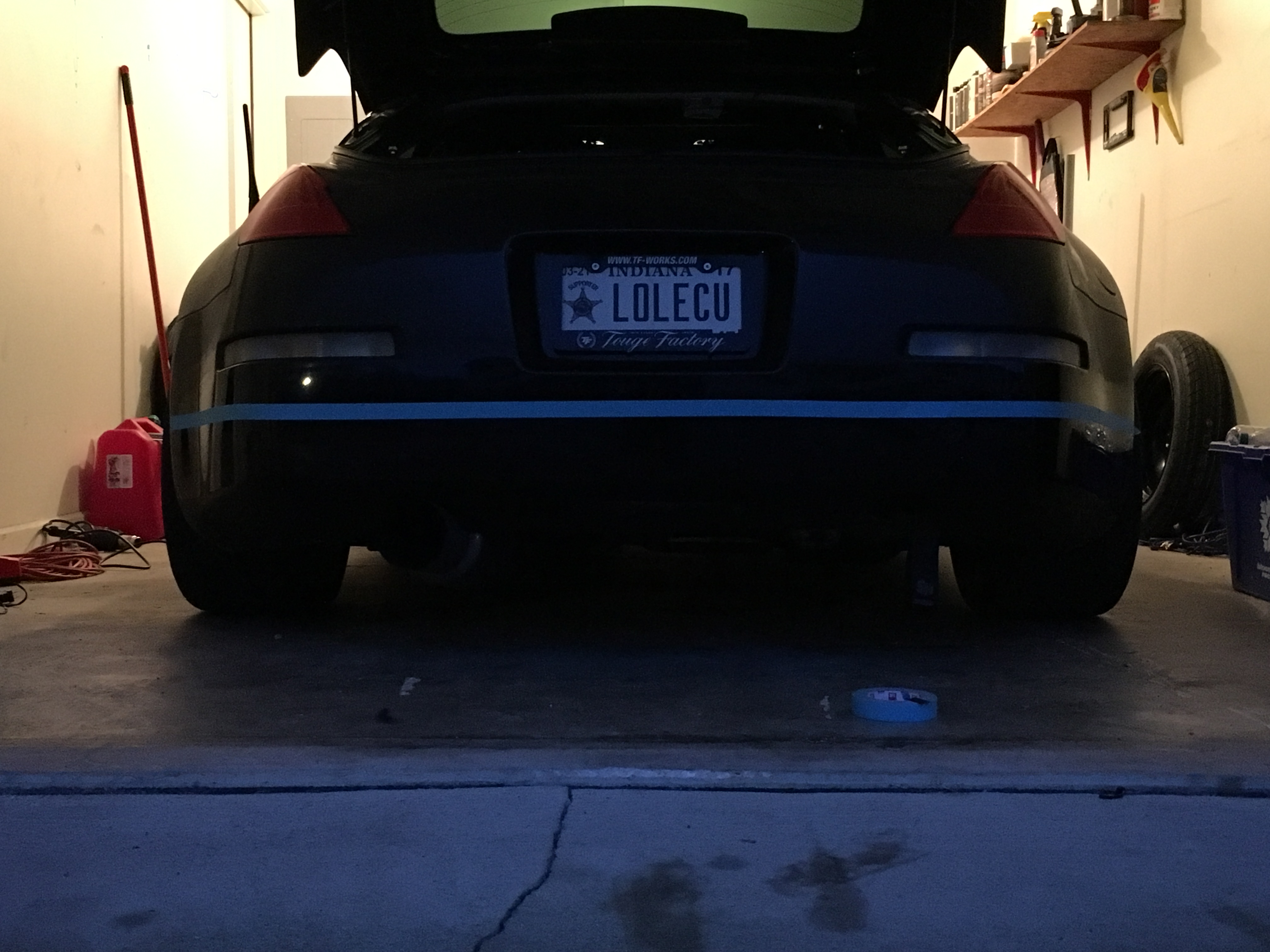

Started to work on the front splitter with my buddy Alex (also making one for his 2015+ WRX). Got mine shaped out and drawn up. Have to do some sanding still to get everything tightened up and perfect (I'm a tad OCD). 5" extension from the bumper line, can't wait to get it all mounted up. This will just be temporary until I get some alumalite and make the splitter out of that.
Here are some pics of the splitter rods that I'll be using and roughly where they will mount on both the crash beam as well as the splitter.
