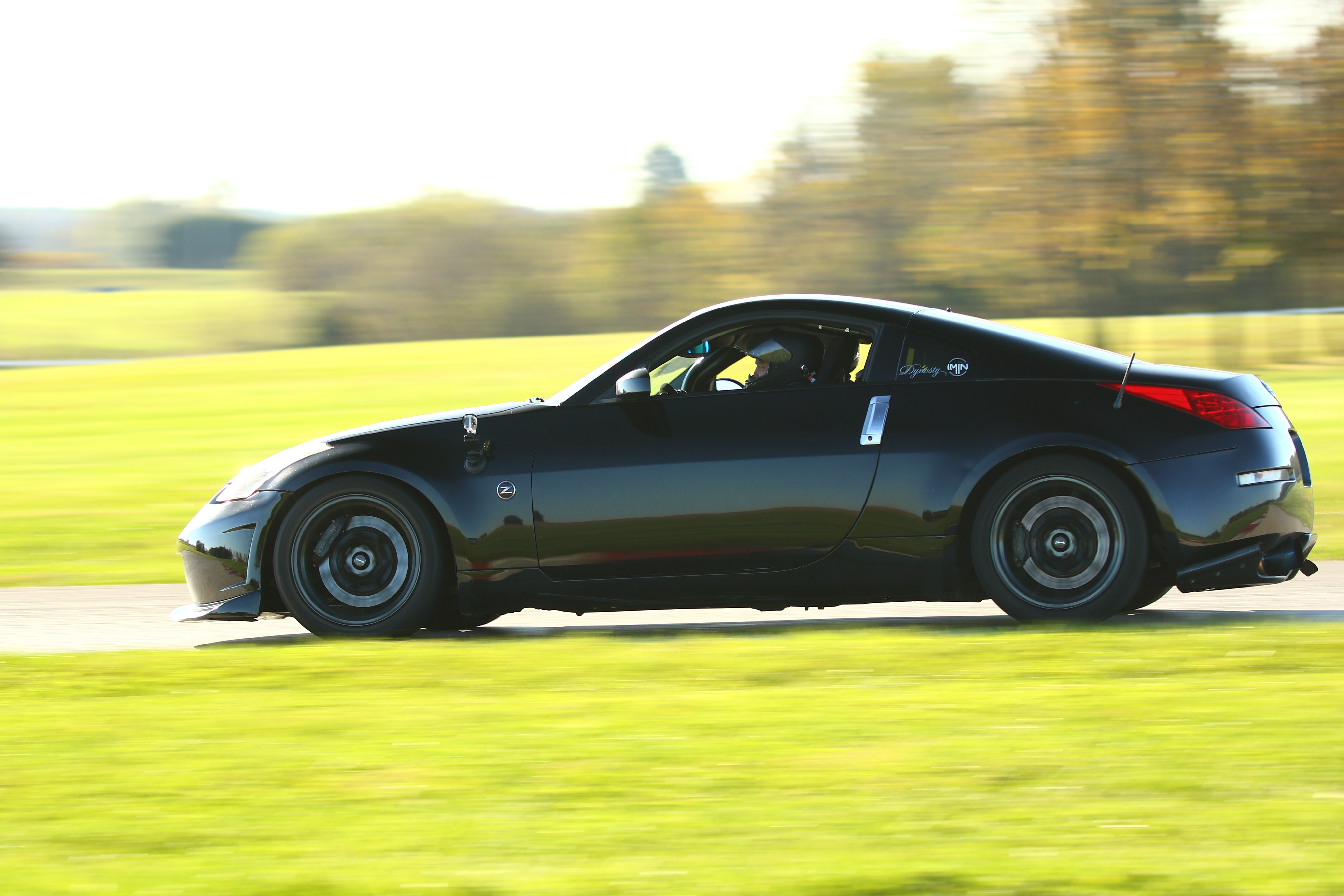

Quick snap from this past weekend.
Track day coming up this weekend, let's see how she performs.

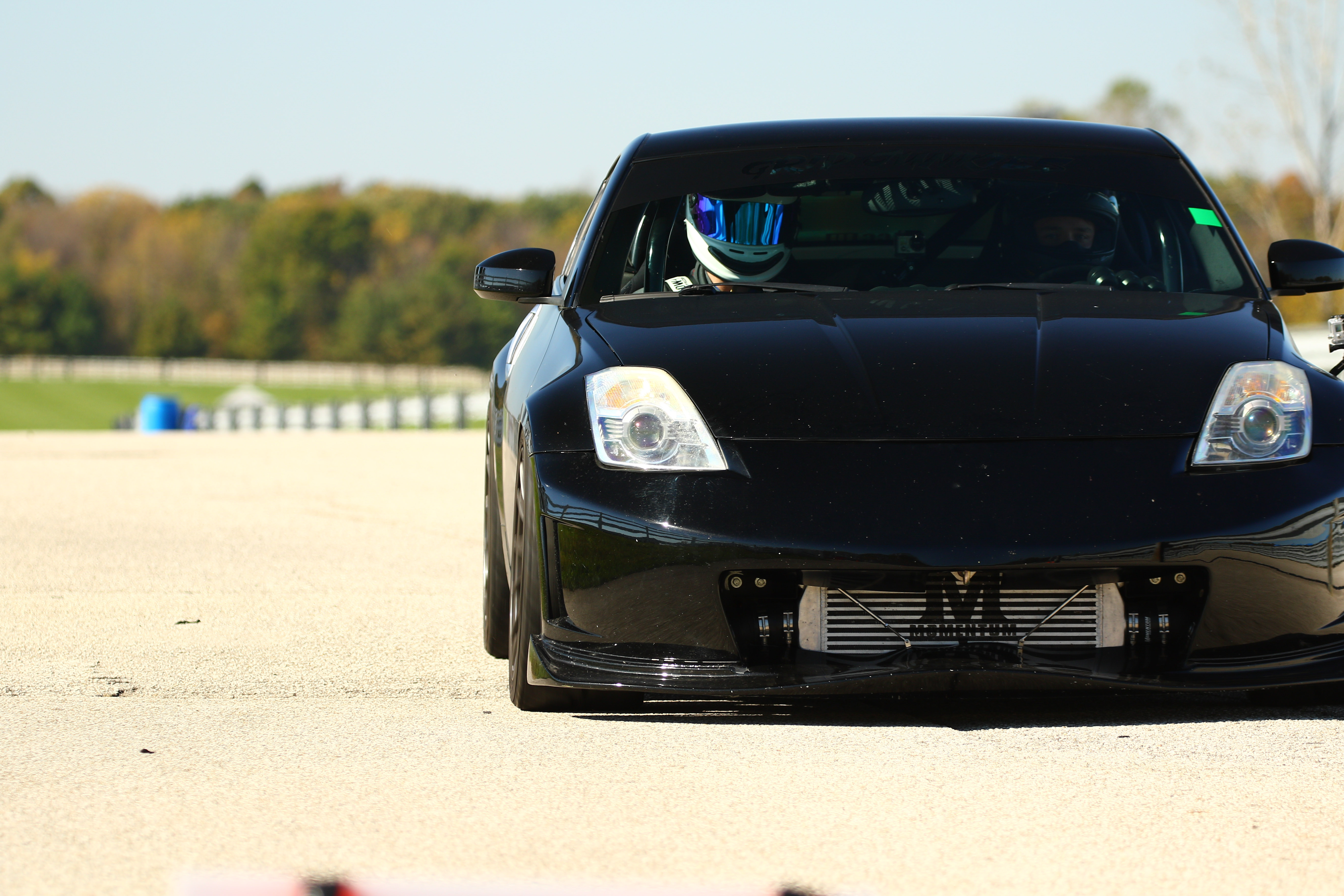

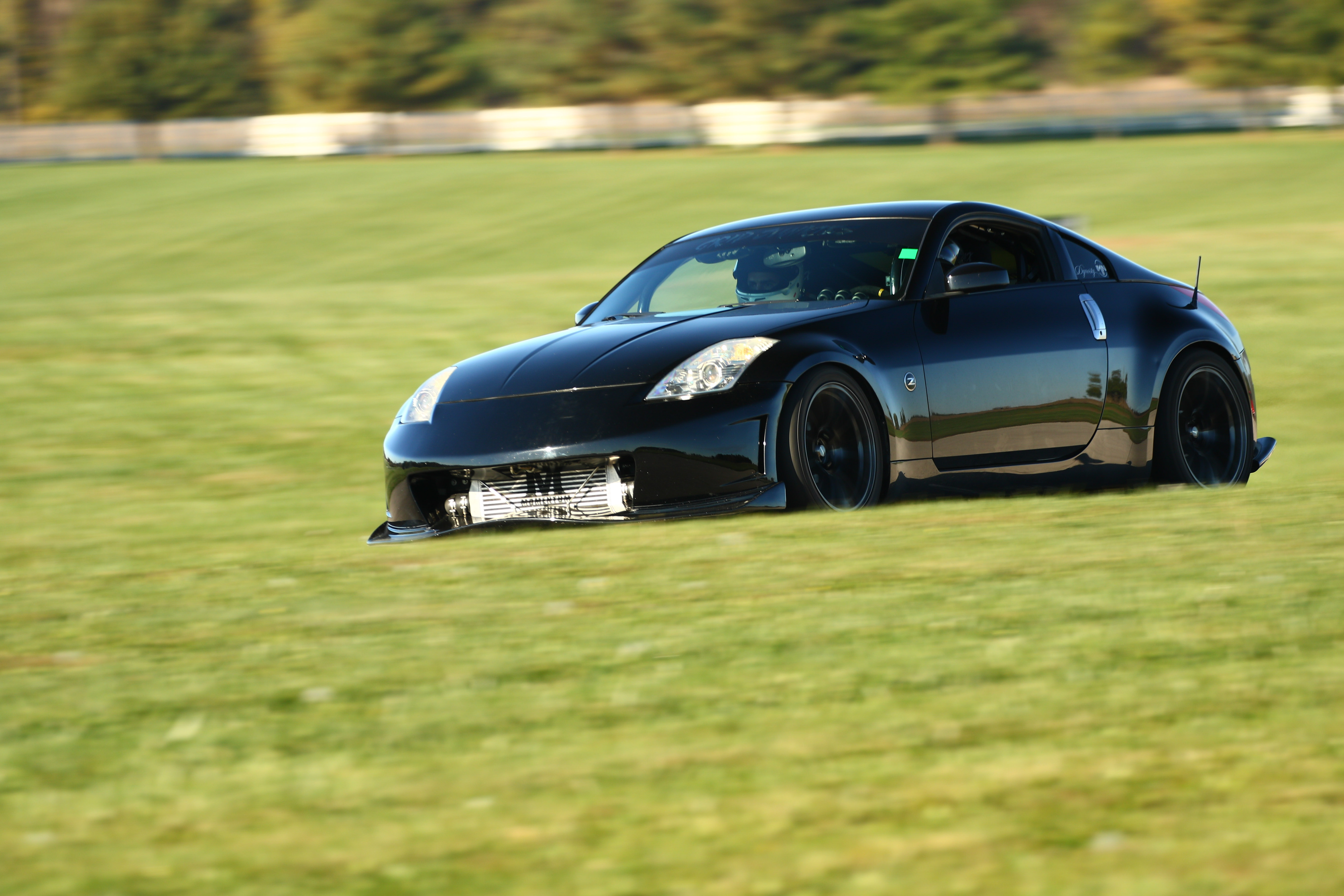

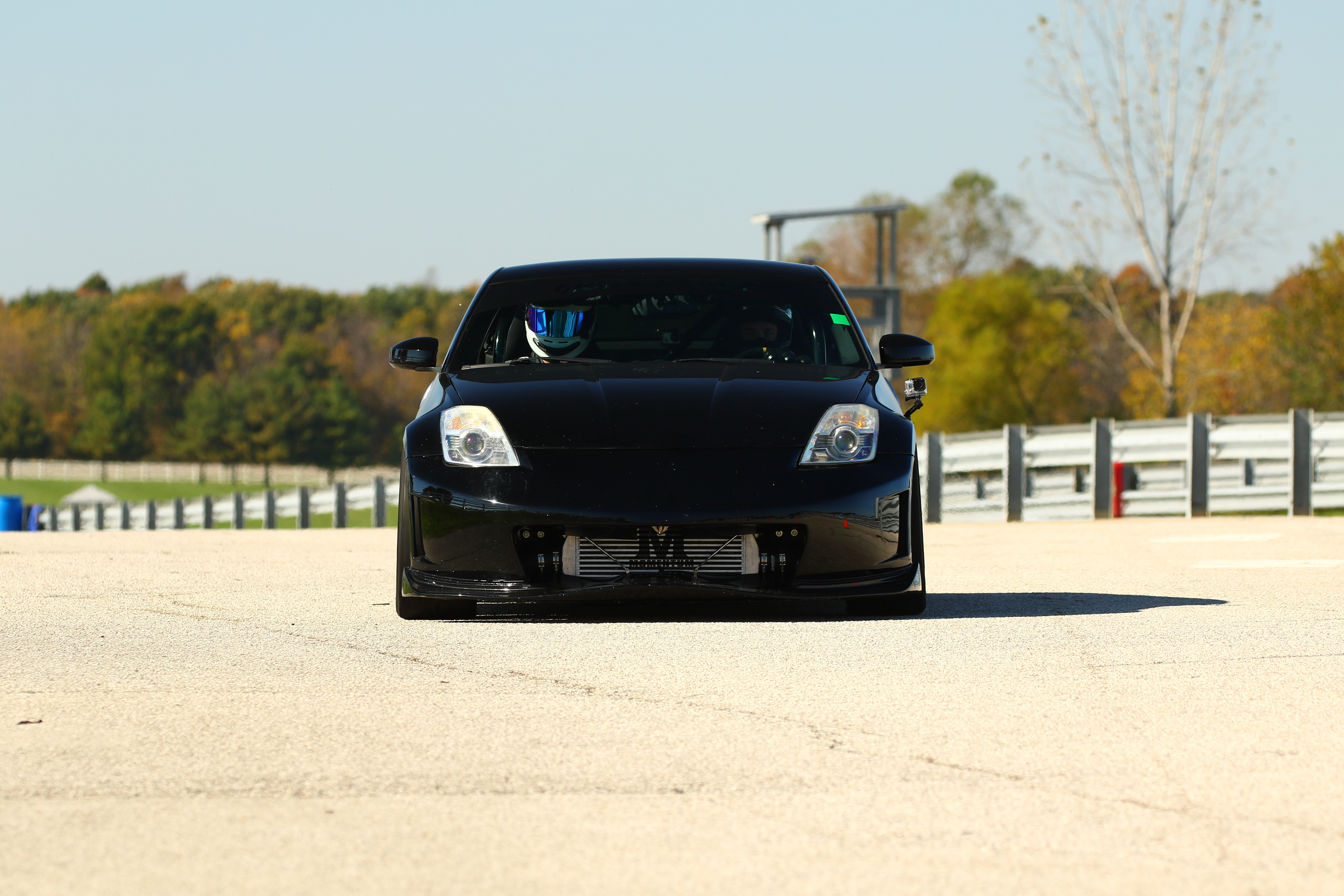

Yeah, they're super loud. Also not nearly as grippy as I had hoped. So much for 'Cheater' tires
I'll be switching tires next season without a doubt, I've got it down to two different tires I'm looking at. I'll outline that as well as my winter plans and more information about my track weekend here.
Some might now know, but this was my first track weekend ever. So I learned way more than I expected to, and driving my car, I had a lot to learn.
Onto the tires and grip... I learned very quickly that these tires do not have much grip at all, they just want to slide around. When they get hot, they don't really marble like you would expect them to, instead they just kind of melt. My instructor who is a close friend of mine drives a track prepped e92 M3 on Hoosiers and he was commenting from the passenger side of the car how little grip the tires had. I then had a friend drive the car in advanced group the next morning and he had the same comment. That being said, the suspension absolutely needs to be set up properly by a shop (I'm not a suspension guy at all). The front was rubbing pretty bad...
Onto my brakes - the Wilwood BP10 pads just aren't cutting it at all. I was getting outbraked by a 2013 BRZ on stoptech pads and rotors with stock brake calipers. But I won't lie - that car was a blast to drive. I was about 5-10 seconds faster in that car than my own, which was interesting. I learned a lot of really interesting concepts driving an underpowered car on the track.
Some pictures, then onto my winter plans.

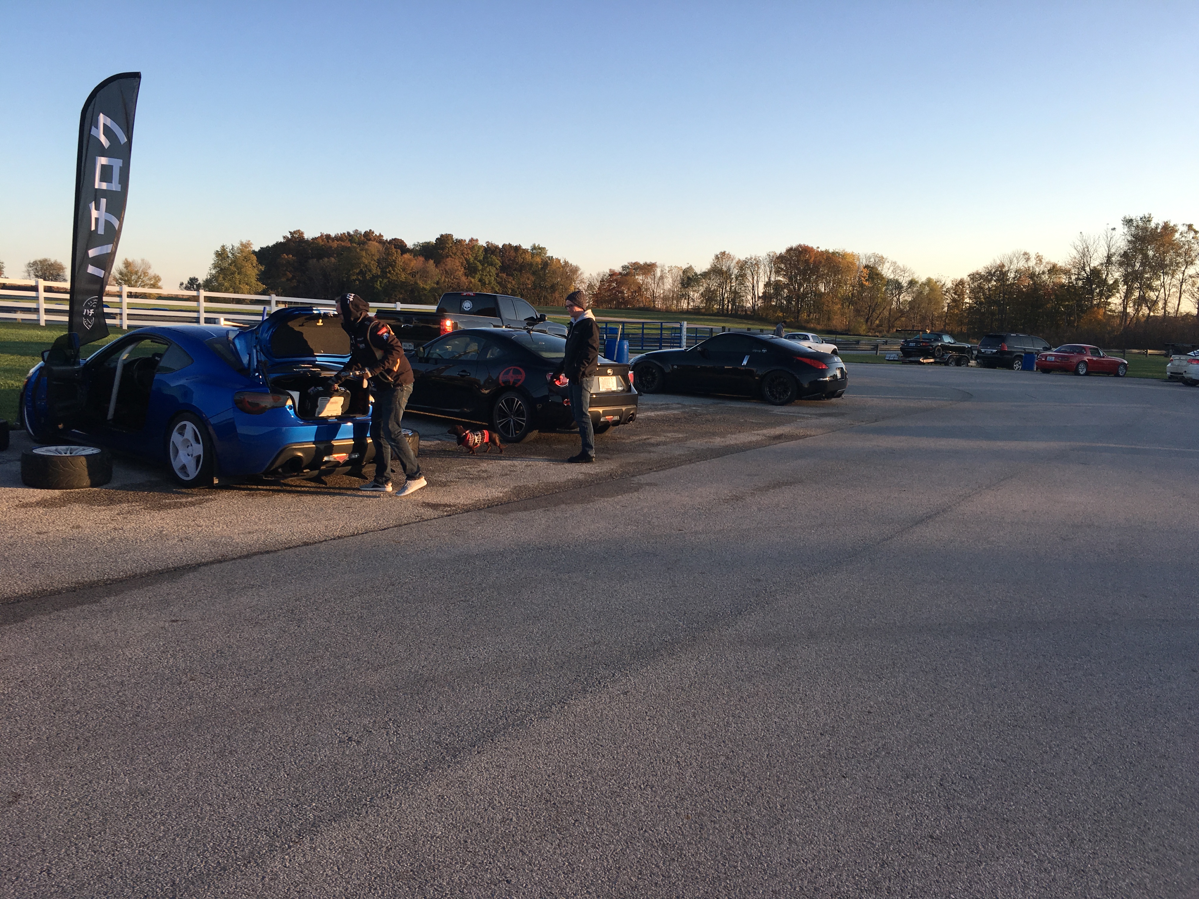

The Grip Junkies crew arrived (blue BRZ), myself, a few others not picture as they were pulling in. This was after grabbing my registration packet.

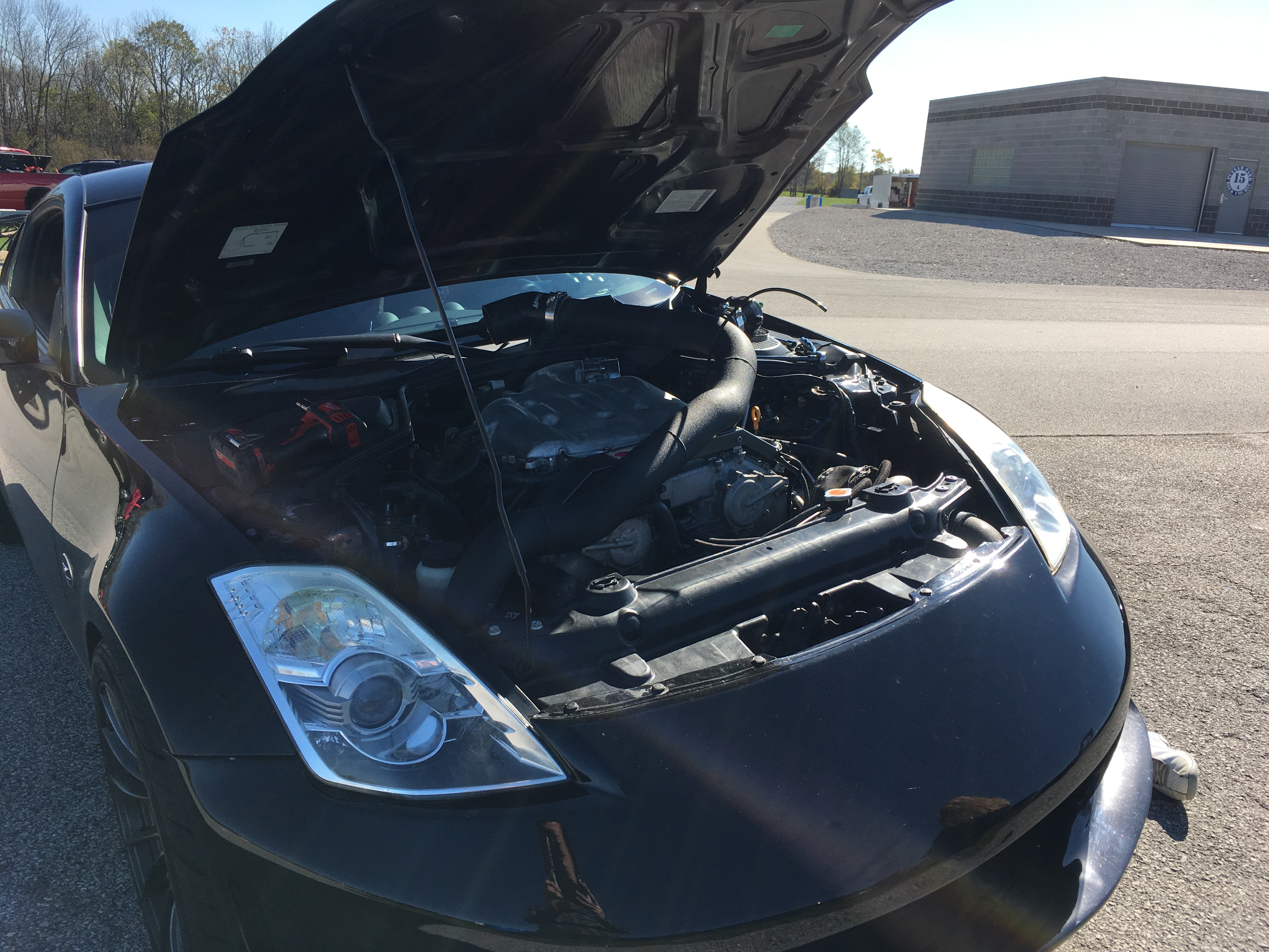

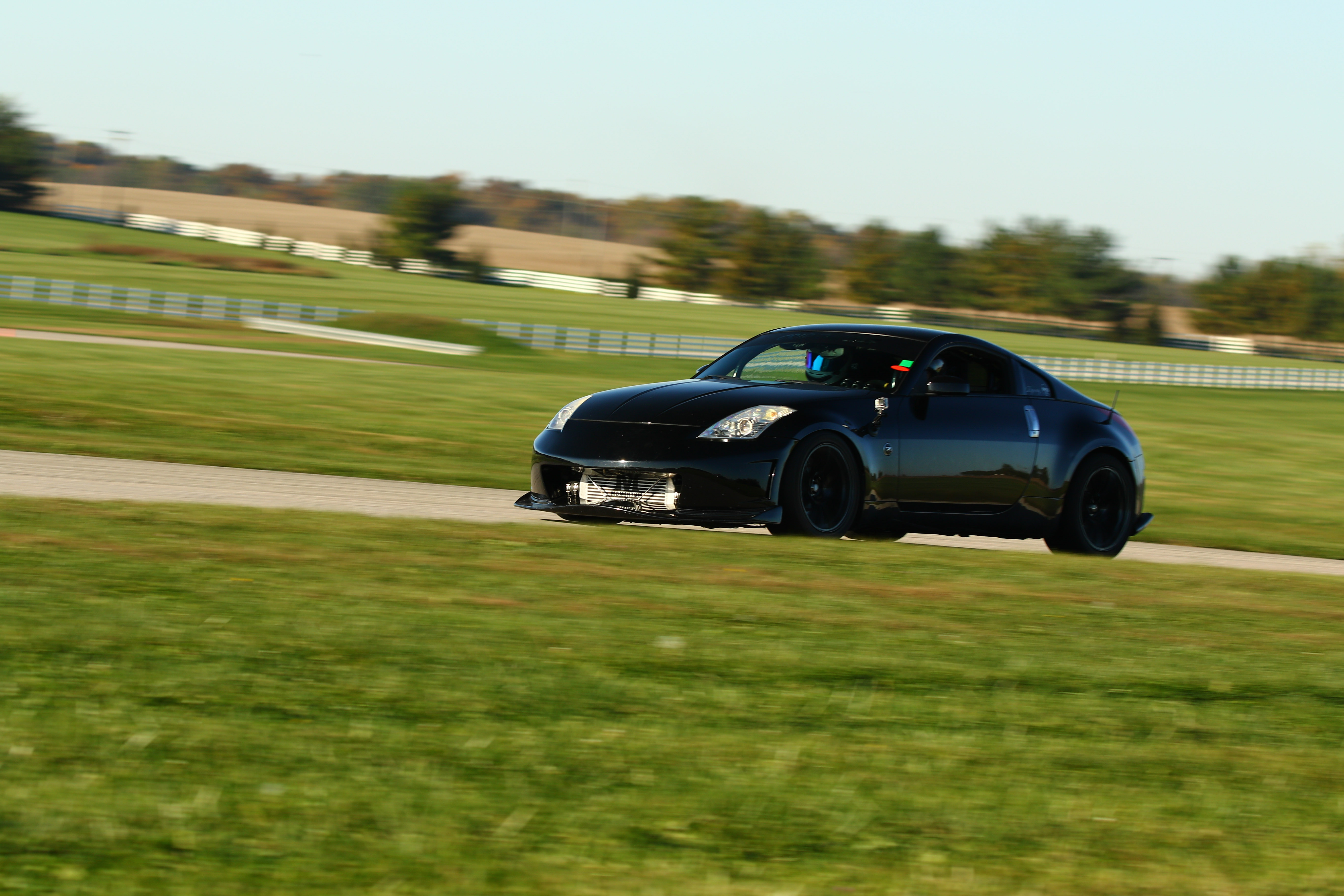

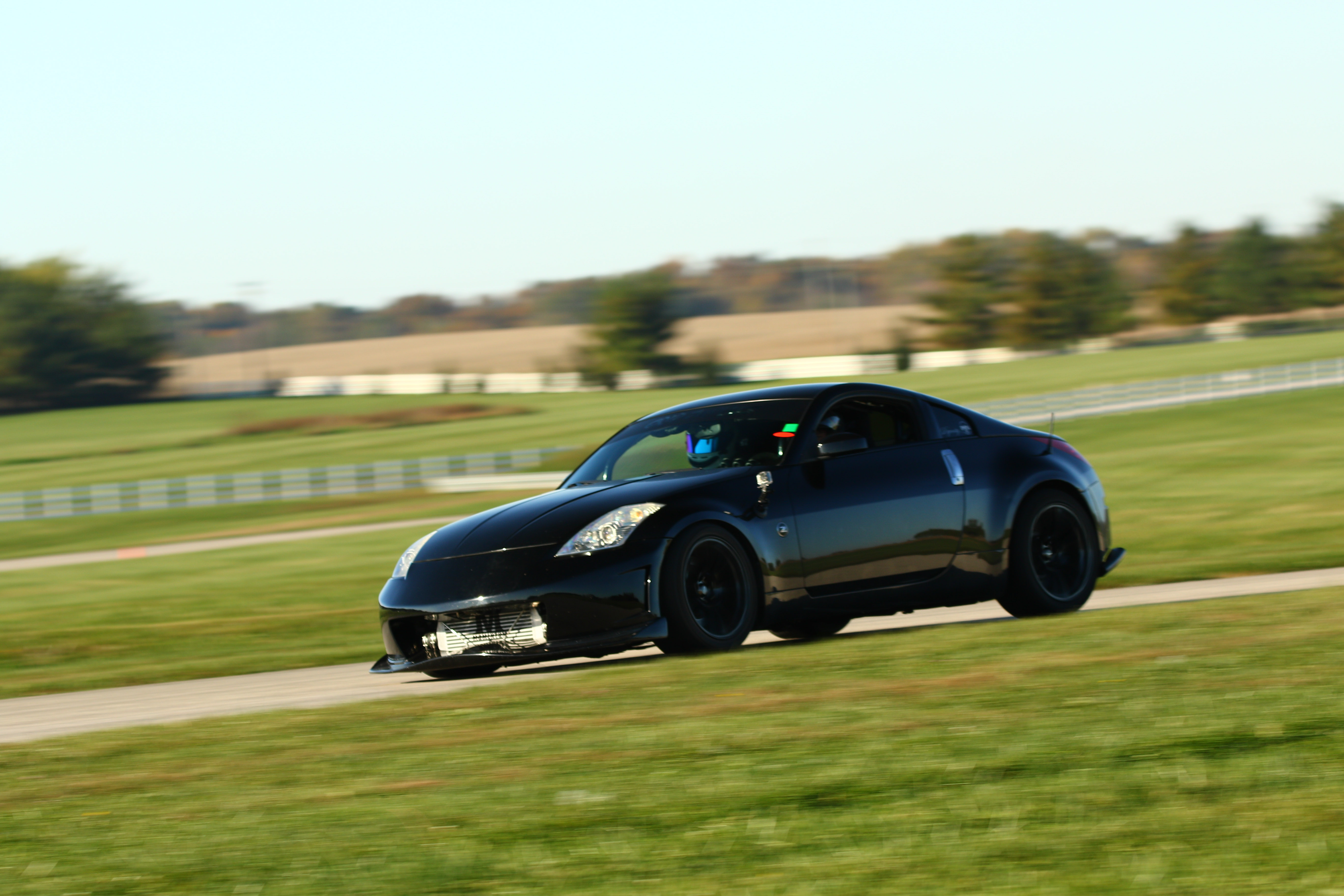

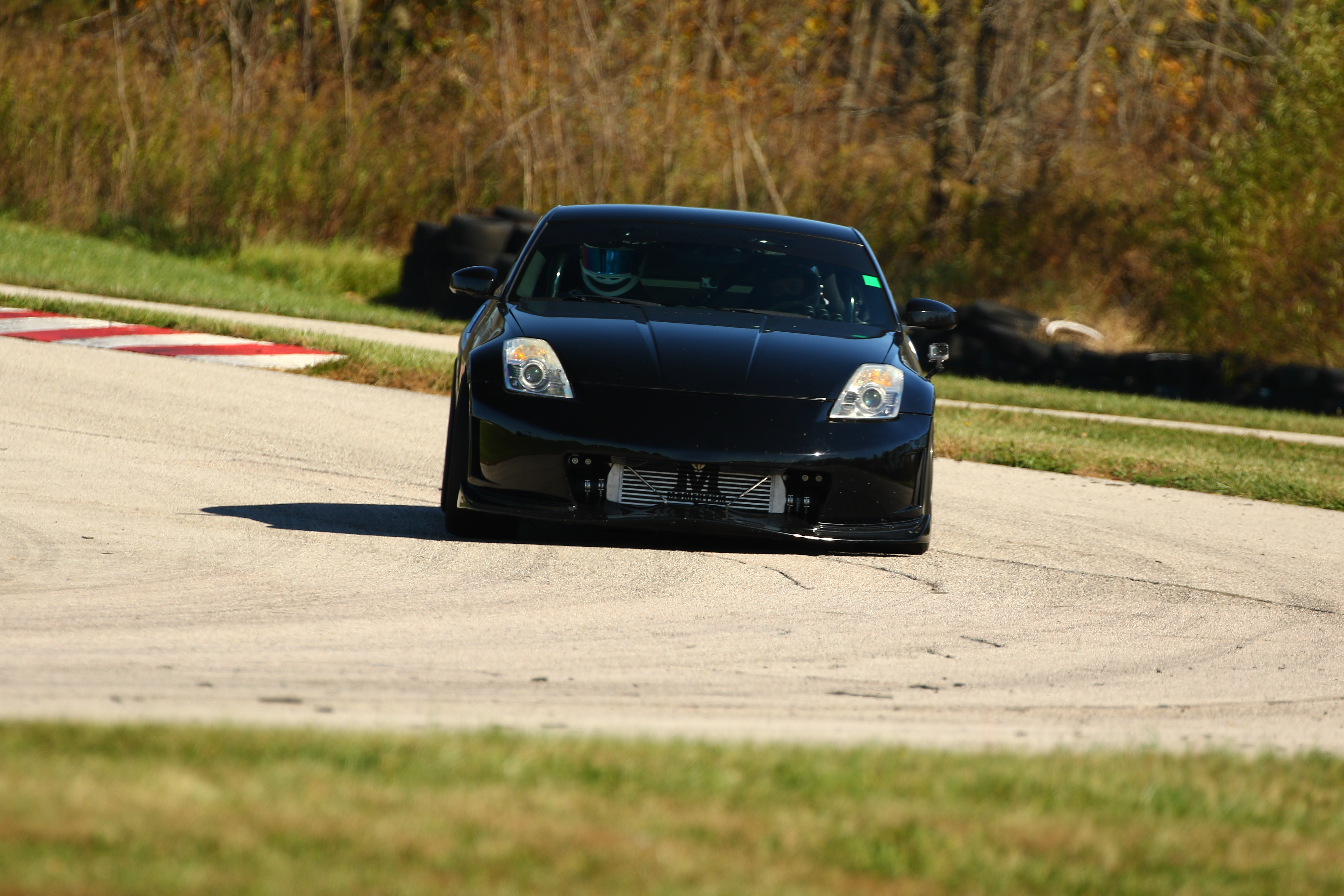

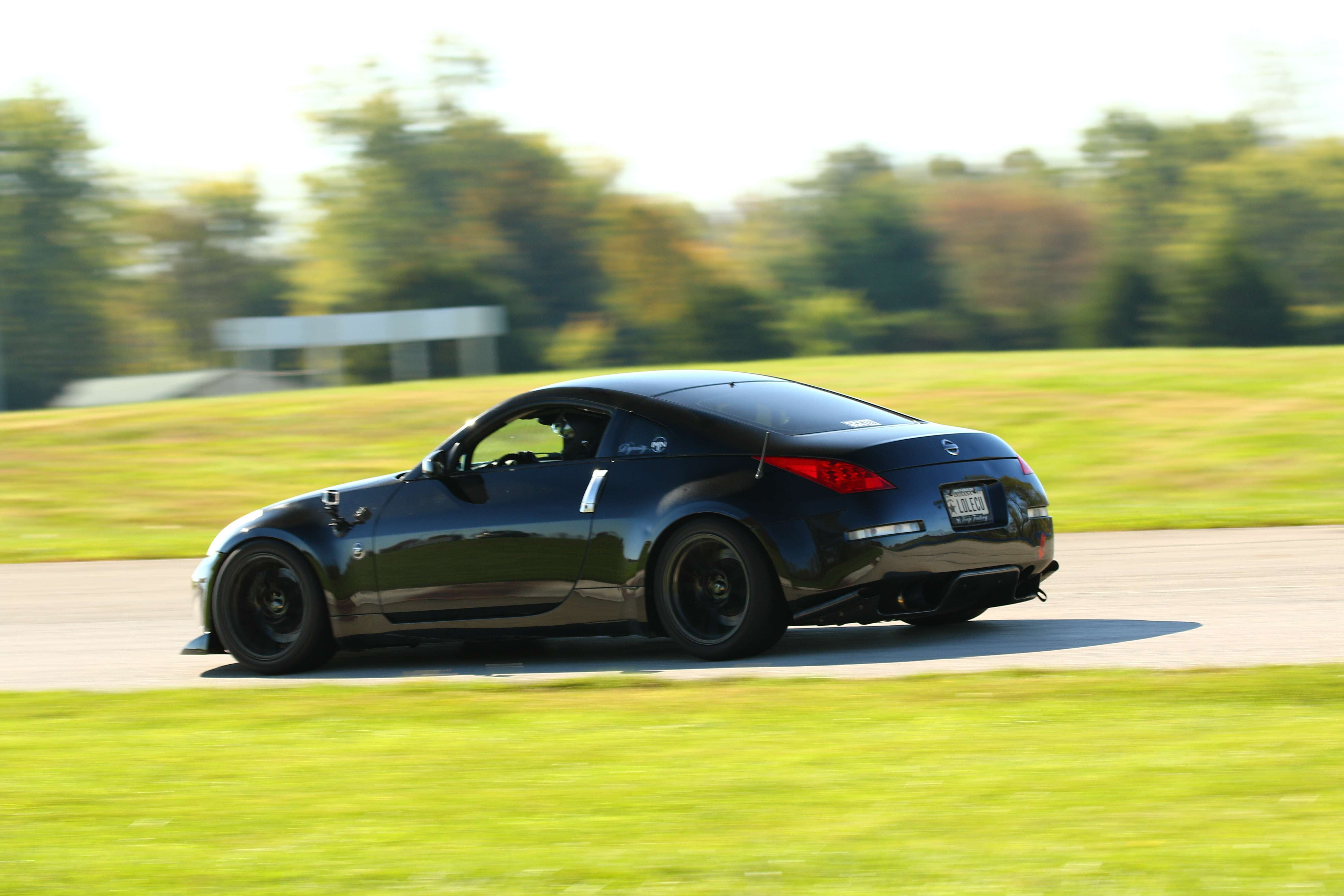

Later in the day, doing some trackside repairs. O2 plug on the OEM header backed itself out. Thankfully I grabbed some others before I left the house Friday night... This took forever to get back into place. Had to disconnect the downpipe from the turbo and loosen some other stuff to move the downpipe enough to get the new plug in.

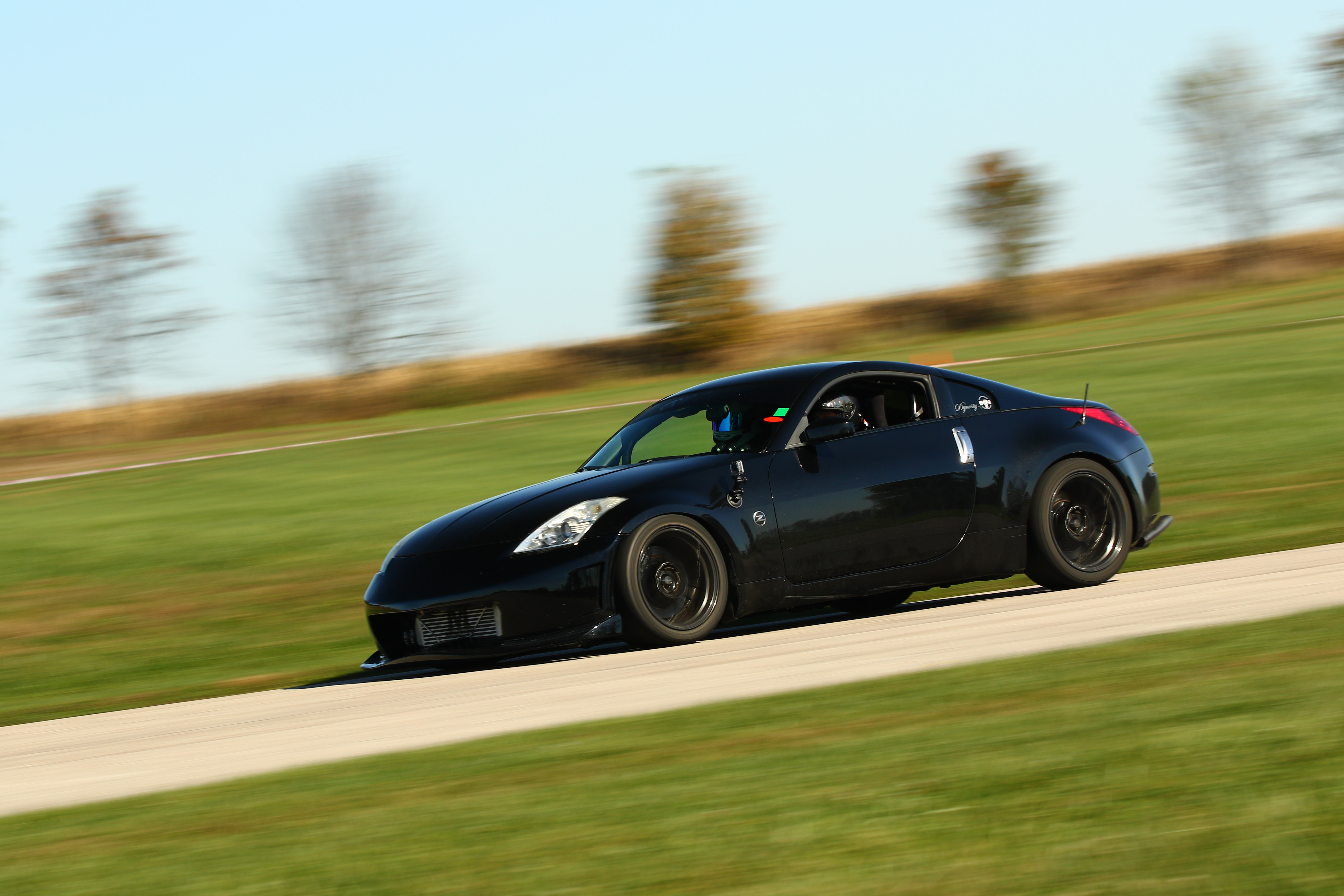

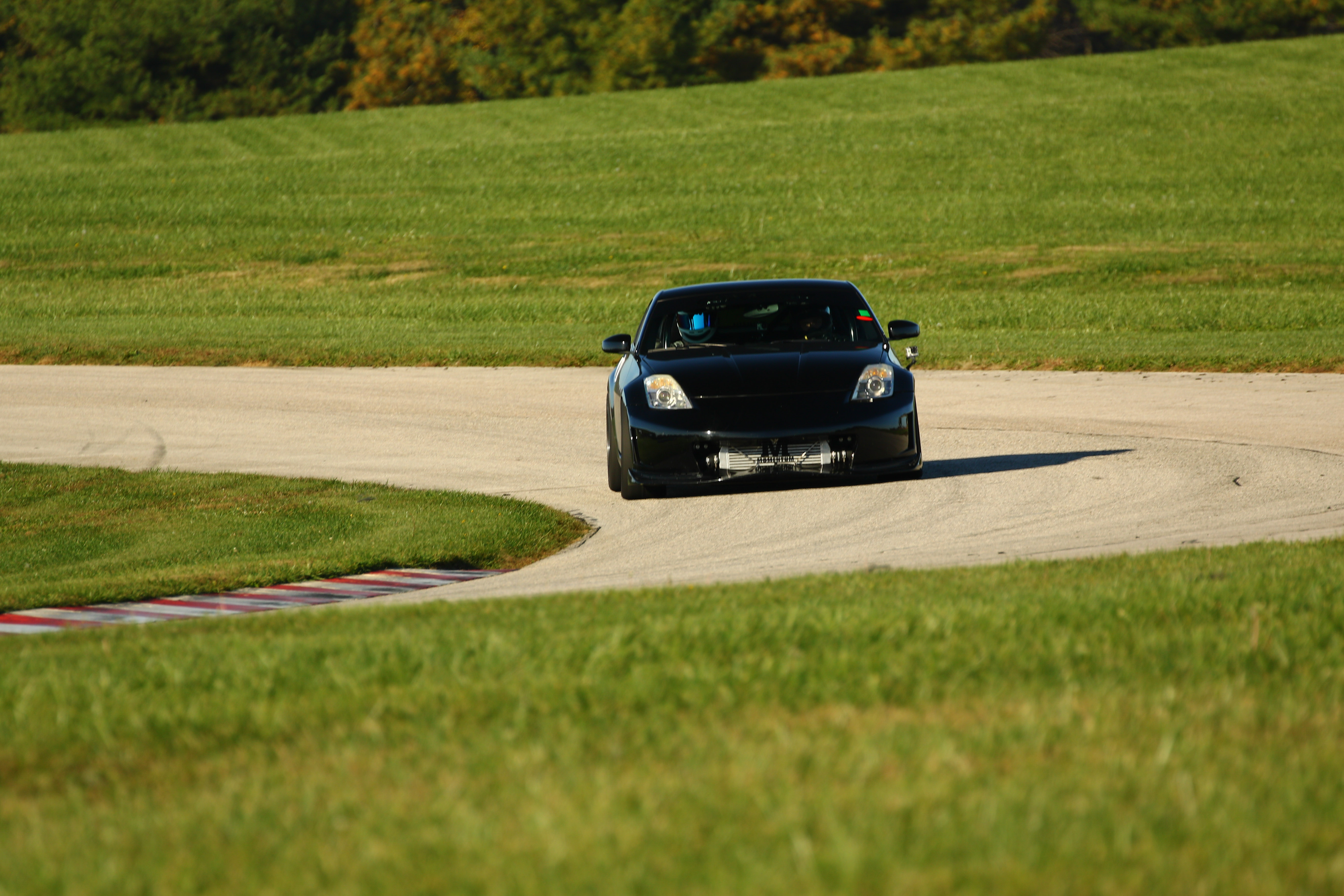

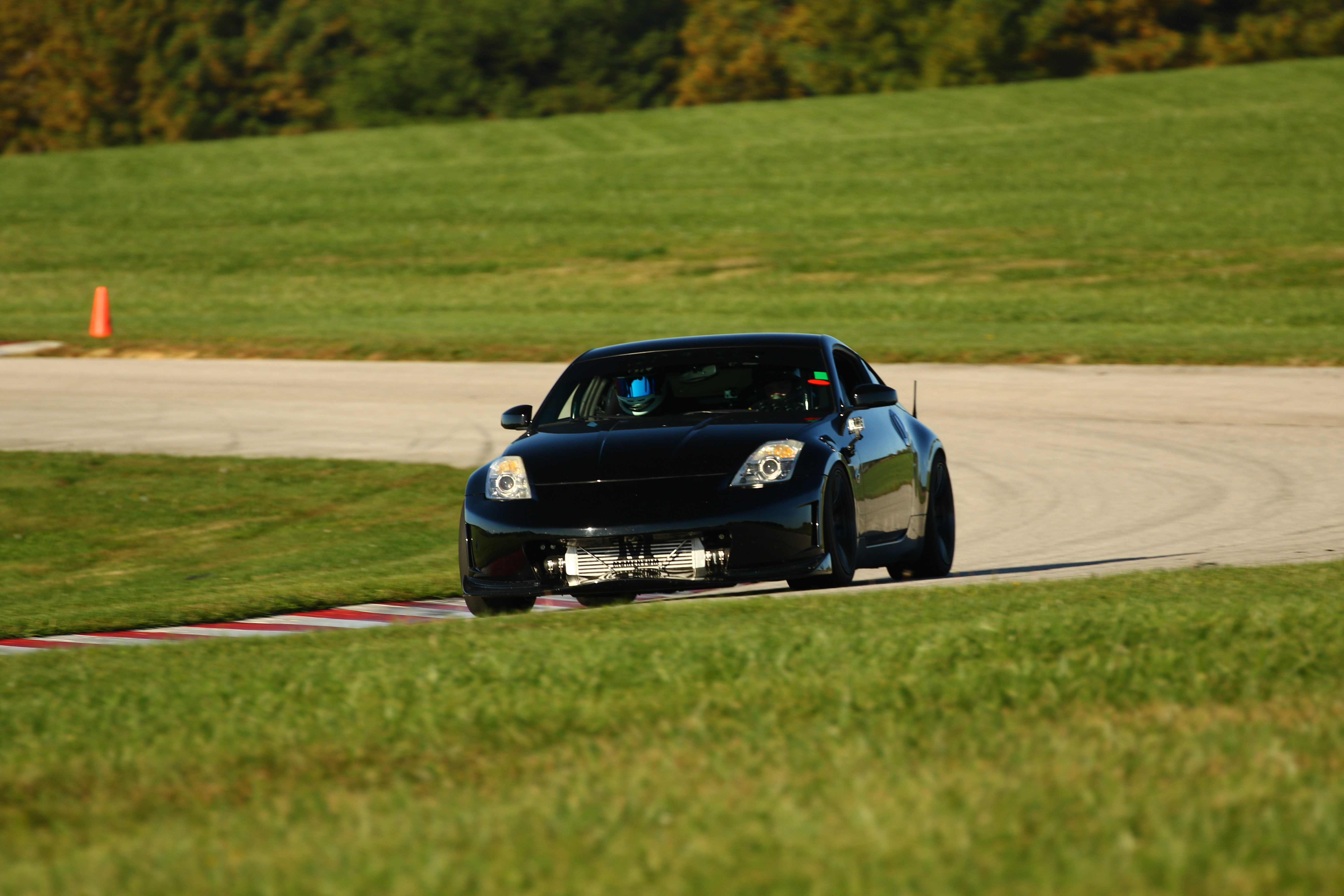

And on track shots thanks to ABI Photography.

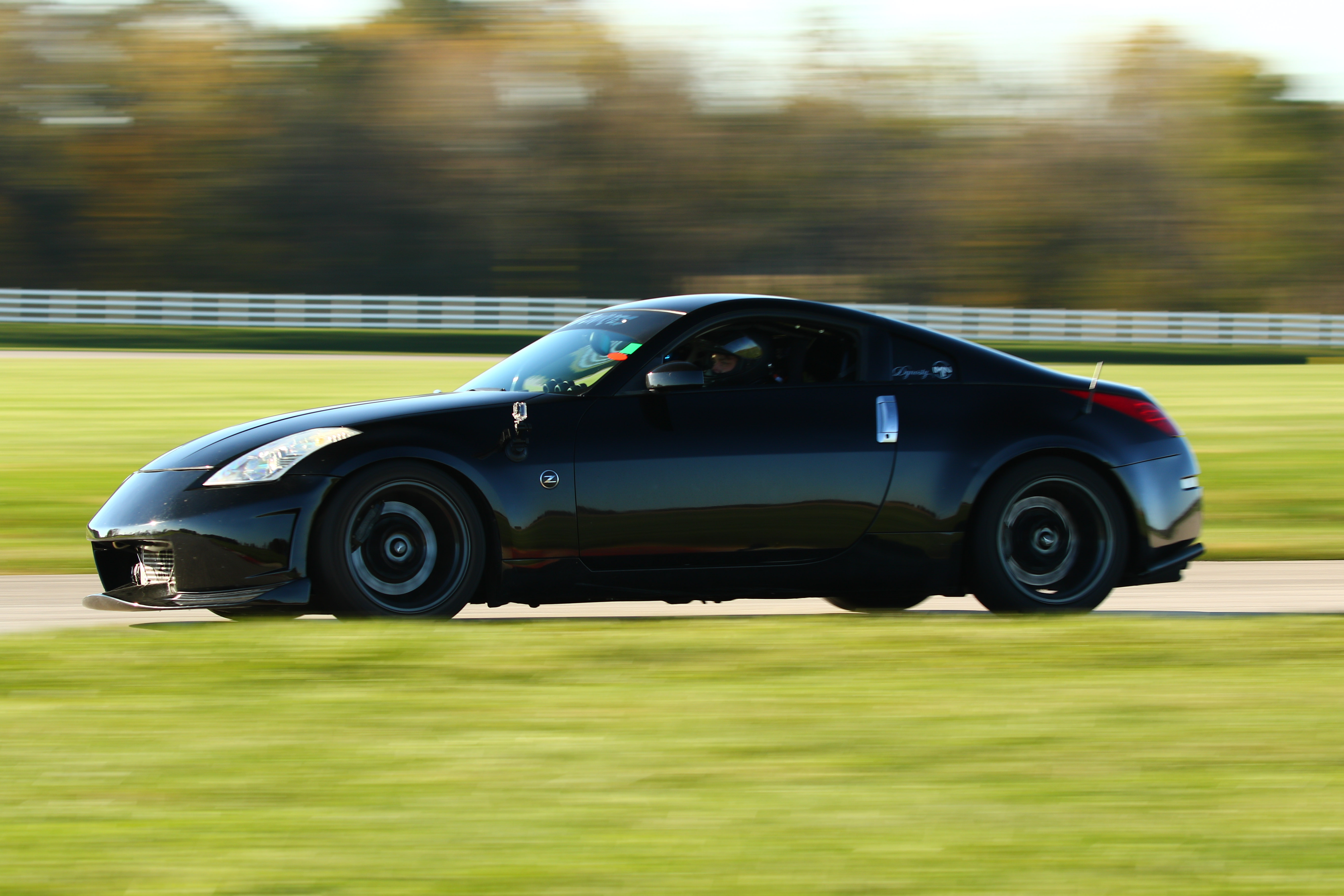

Old Nov 4, 2016 | 09:54 AM
  #217
IIQuickSilverII's Avatar
IIQuickSilverII
Posts: 14,613
Likes: 215
From: Arizona -InP-
to be clear again.. those are some bad *** pictures!

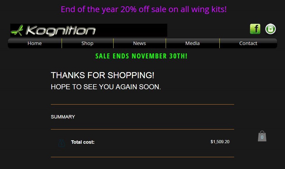

Well, I did a thing last night.
Now the wait... I'll be sure to include install pics, etc.
