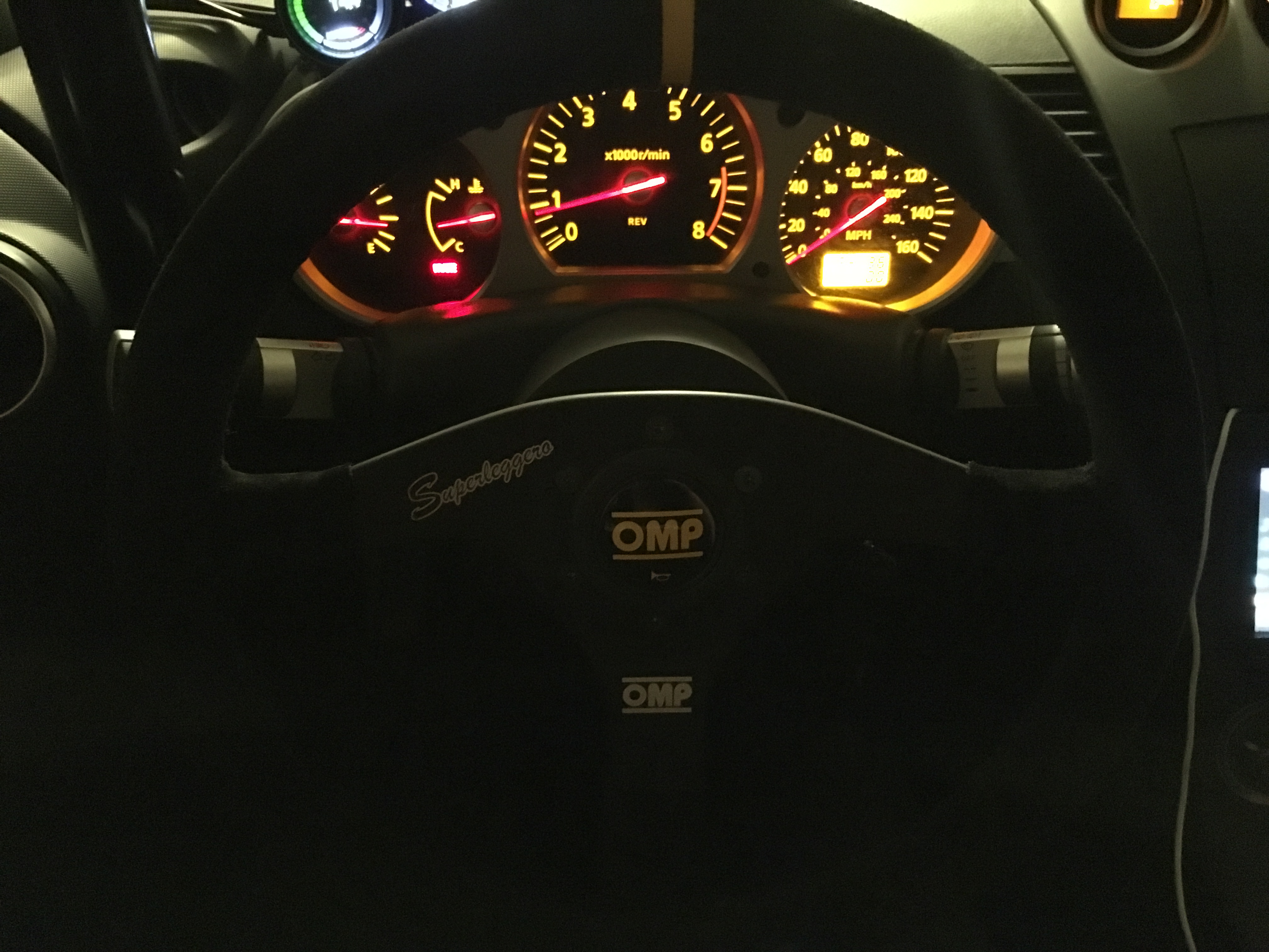

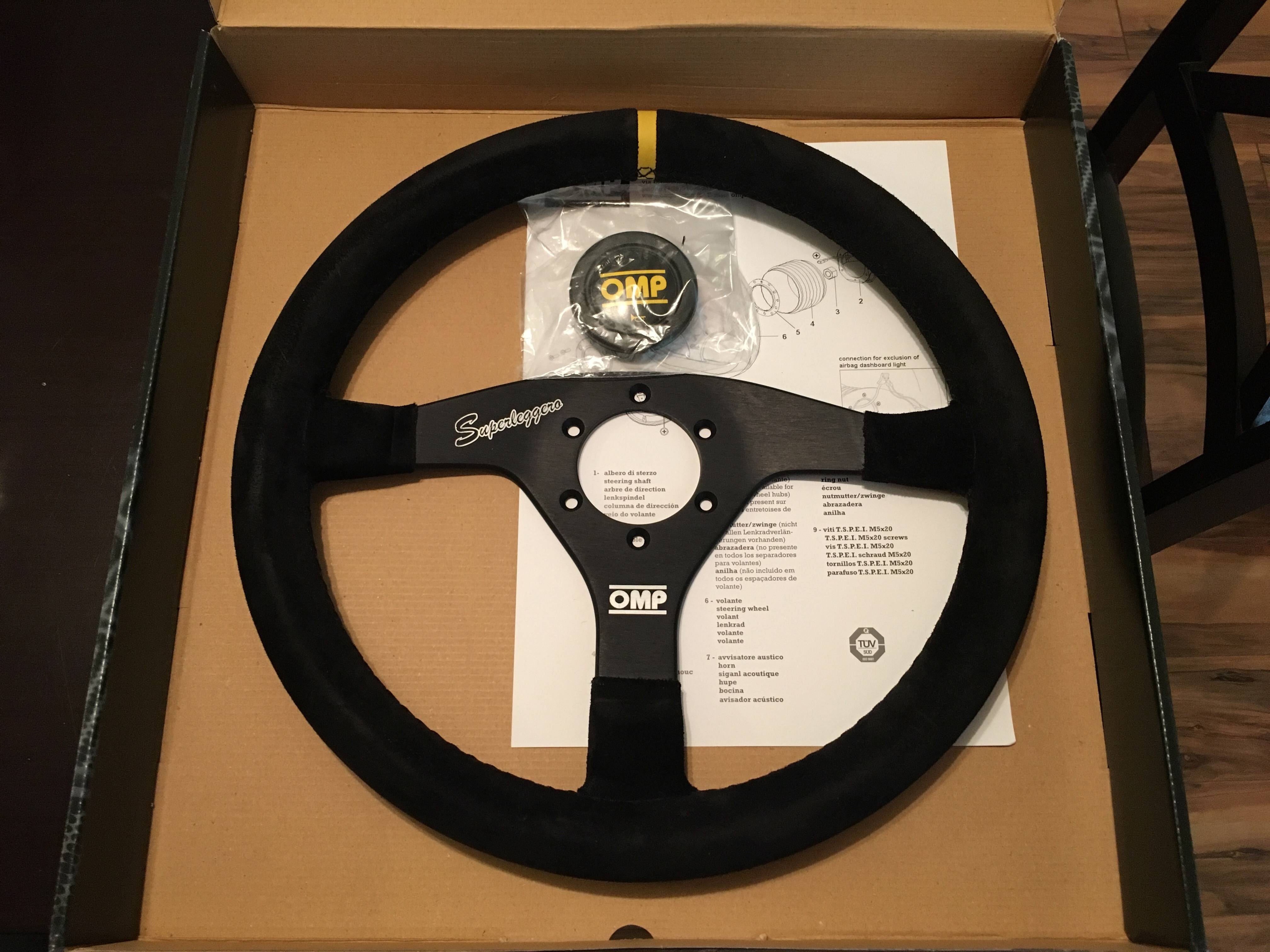

Today, I got my favorite steering wheel so far. I love the way this wheel feels and the simplicity of it. Super excited to get it in the car this week. Works Bell standard hub should be here Thursday I believe.

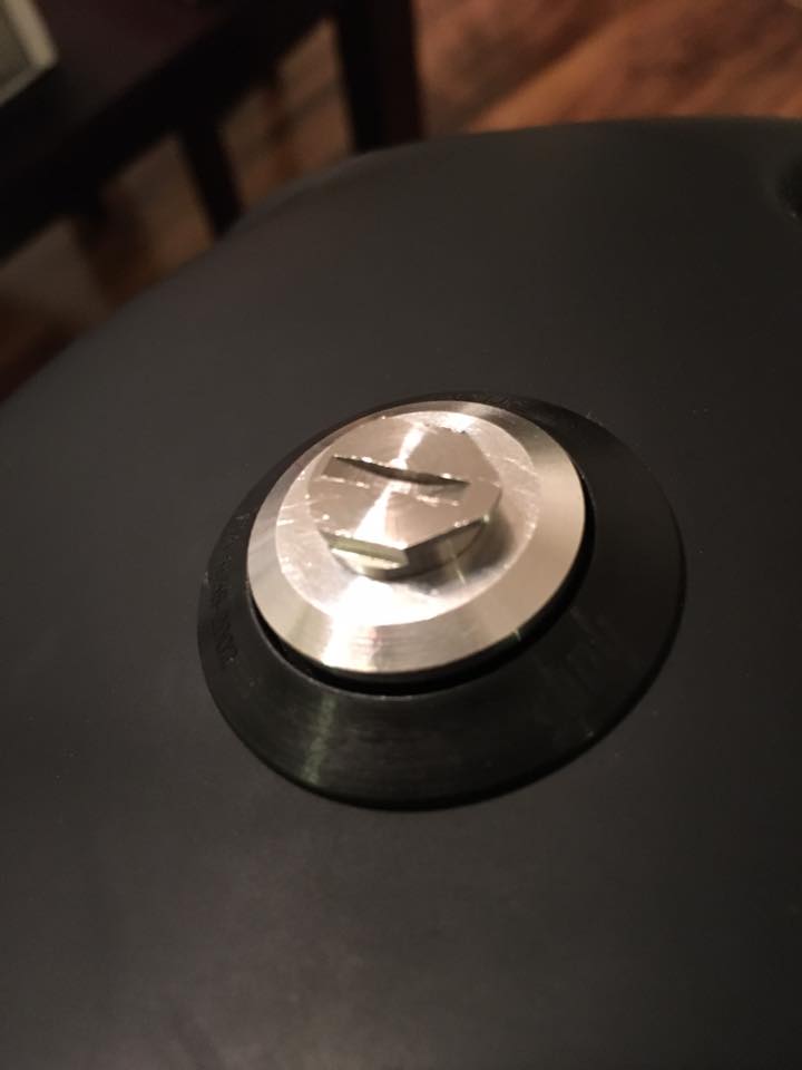

Just ordered a few more parts from Z1 thanks to Russ. Picked up some SPL endlinks, will need to do the rears eventually.. but the fronts are just screaming at the moment haha.
Also had to drop the car off to get the coolant drained and refilled. After doing my steering wheel install, I went under the car and tightened up all of the oil lines, etc. and I mistakenly pulled the filter coolant tube (not thinking, it was 3am at this point) and got an air pocket in there. It was about time to drain the coolant anyhow, so I just let a friend do it while I was at work/school (crazy semester). So huge thanks to Jericho for getting the coolant dialed, running zerex and engine ice at the moment.

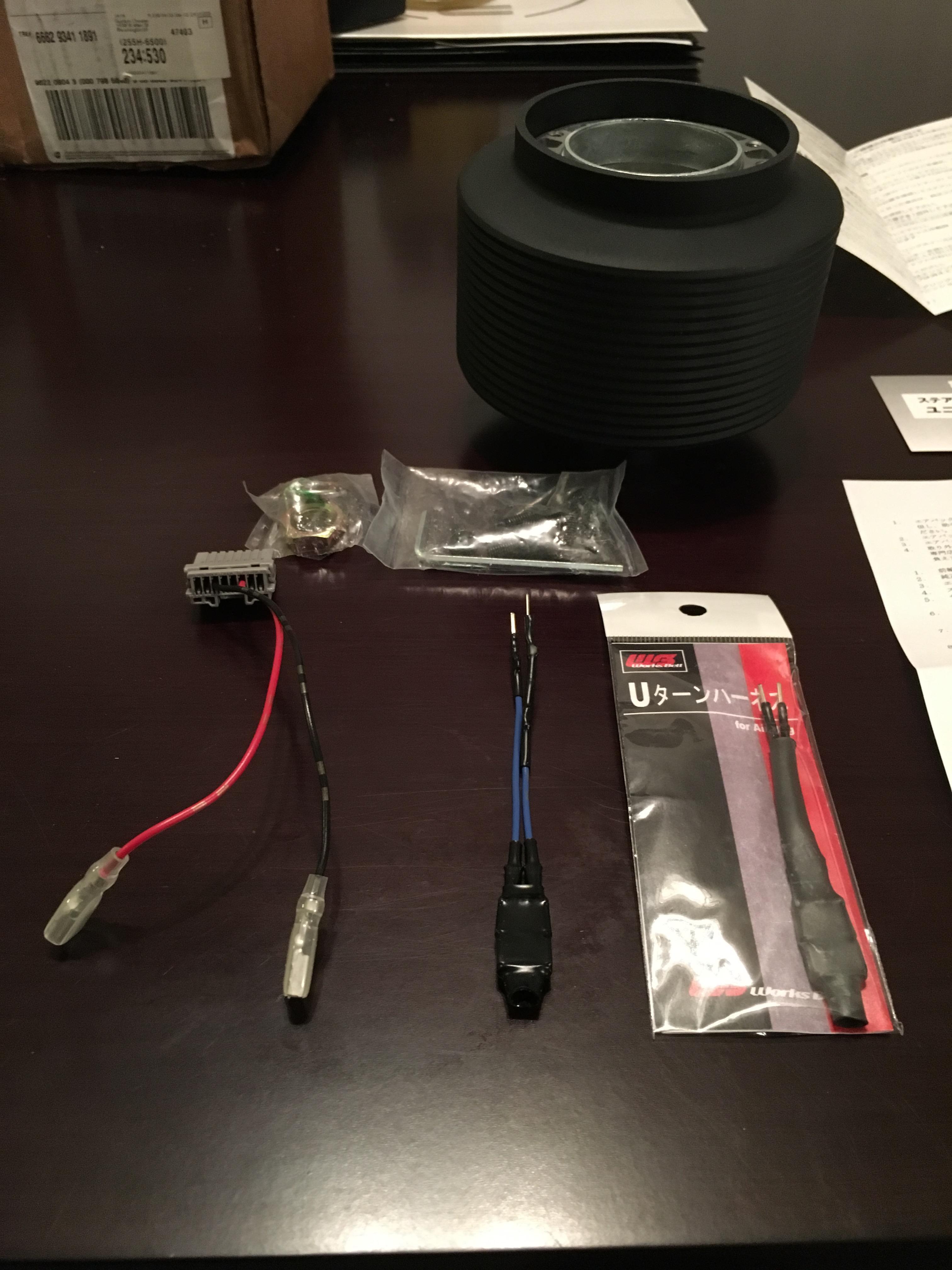

Works Bell hub came in a while back, got around to mounting the wheel as well. In love with the new steering feel of the car.
Dem JDM instructions tho
Removed the bolts for the horn/wheel assembly.
Yank that old sucker off of there!
For anyone doing a wheel install in the future, make sure to bring these black tabs up before pulling the connectors out
Ta-da!

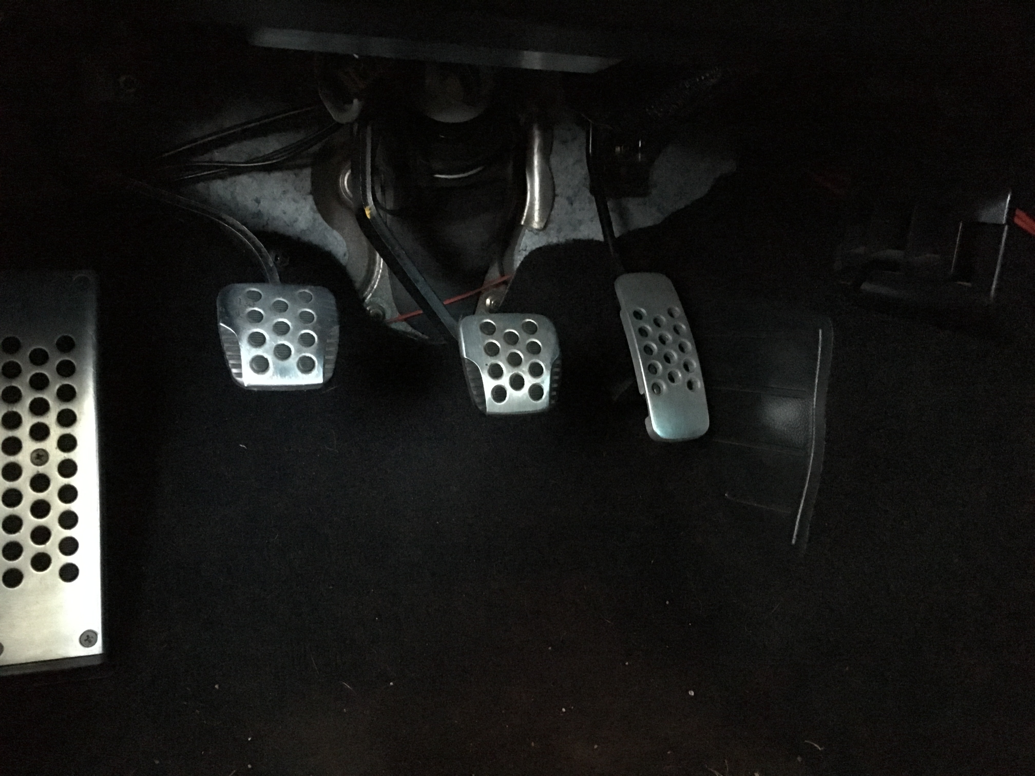

Got my 380RS pedal in today from Z1, huge thank you to the guys for getting this shipped out fast. They shipped it on Saturday, and it was here today.
OEM pedal configuration for comparison.
I've been working on my heel-toe, and while I can do it with the OEM pedal - I would miss the pedal every so often. So I figured for $40, why not just upgrade. Haven't driven with it yet, but I did sit in the seat and attempt to heel-toe though and it was so much easier. Also, super simple swap... would recommend this to other owners.

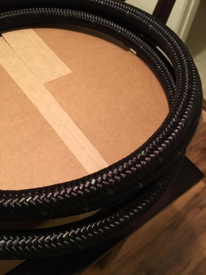

  • Russell ProClassic Hose -10AN Black/Blue Tracer (10ft.) [P/N: 799-632173]

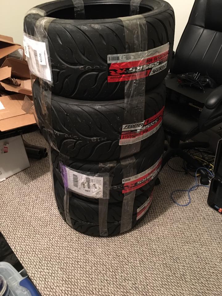

  • Federal 595 RS-RR 275/35/18 (coming from RS-R 265/35/18)

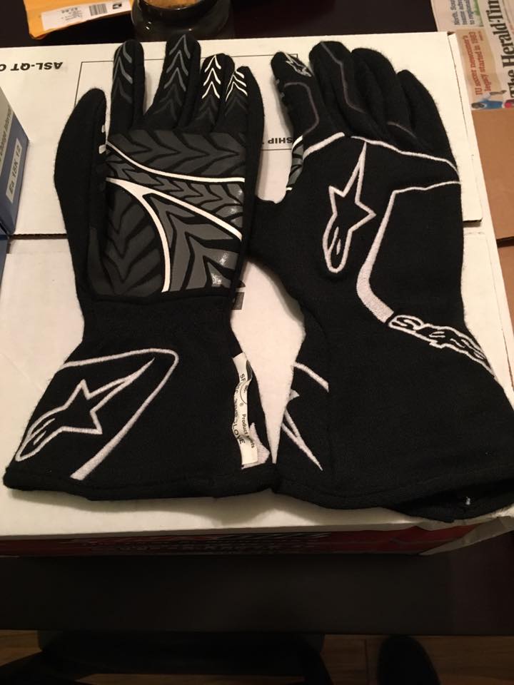

  • Alpinestars 2016 Tech 1 Race Gloves
I've been contemplating a remote oil filter setup just to make things a little easier (thinking about going flat bottom in the future) but I'll wait on that for now.
So, unfortunately... they're no longer producing the RS-R, but from what I've heard - these are just as sticky, if not stickier. They're rater at a higher treadwear to comply with the Street regulations for SCCA though with a 200tw. These are also a bit wider, which I'm totally fine with because they didn't offer the RS-RR in 265/35. Oh well, should look good
Going to wait a few weeks before mounting these. Probably just a few days before my track day.

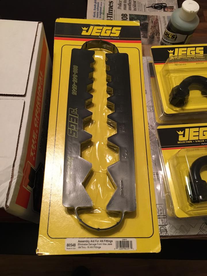

Some lube to help with the installation of the AN fittings onto the hose.
Vise Jaw for helping with installation as well. Keeps the fittings pretty when assembling everything. This was a HUGE help, would definitely recommend this to those of you tackling this job in the future.

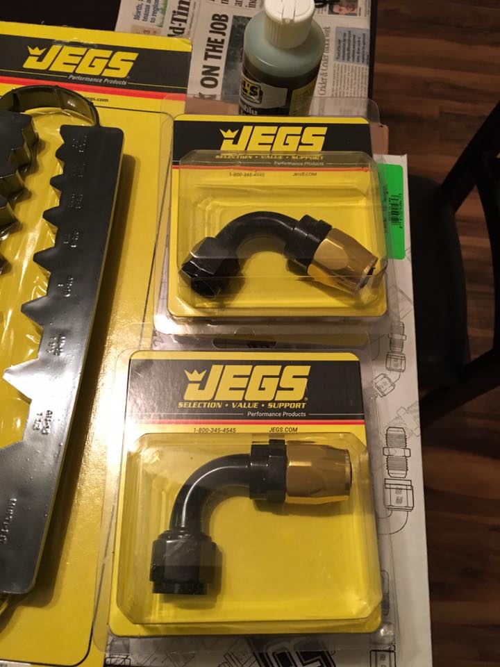

These black/gold fittings ended up looking better than I had thought they would based off of the pictures. Definitely not cheap, but very high quality. I was unsure how they would look with the black hose with blue tracers, but it ended up looking really good I think.
Kind of difficult to see the blue tracers here, but better seen in the second picture. This was some high quality hose, no lie.

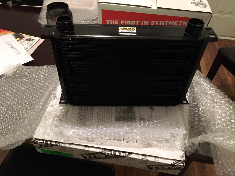

And here is the new oil cooler. I'll definitely be more careful to make sure that this one doesn't leak as well. I'm trying to get my oil temp sensor working so I can monitor my temps... hopefully it ends up working out for me haha

I also picked these up. Wanted to stick with the mostly black theme of course. Love these things so far, super comfortable and great grip on the steering wheel.

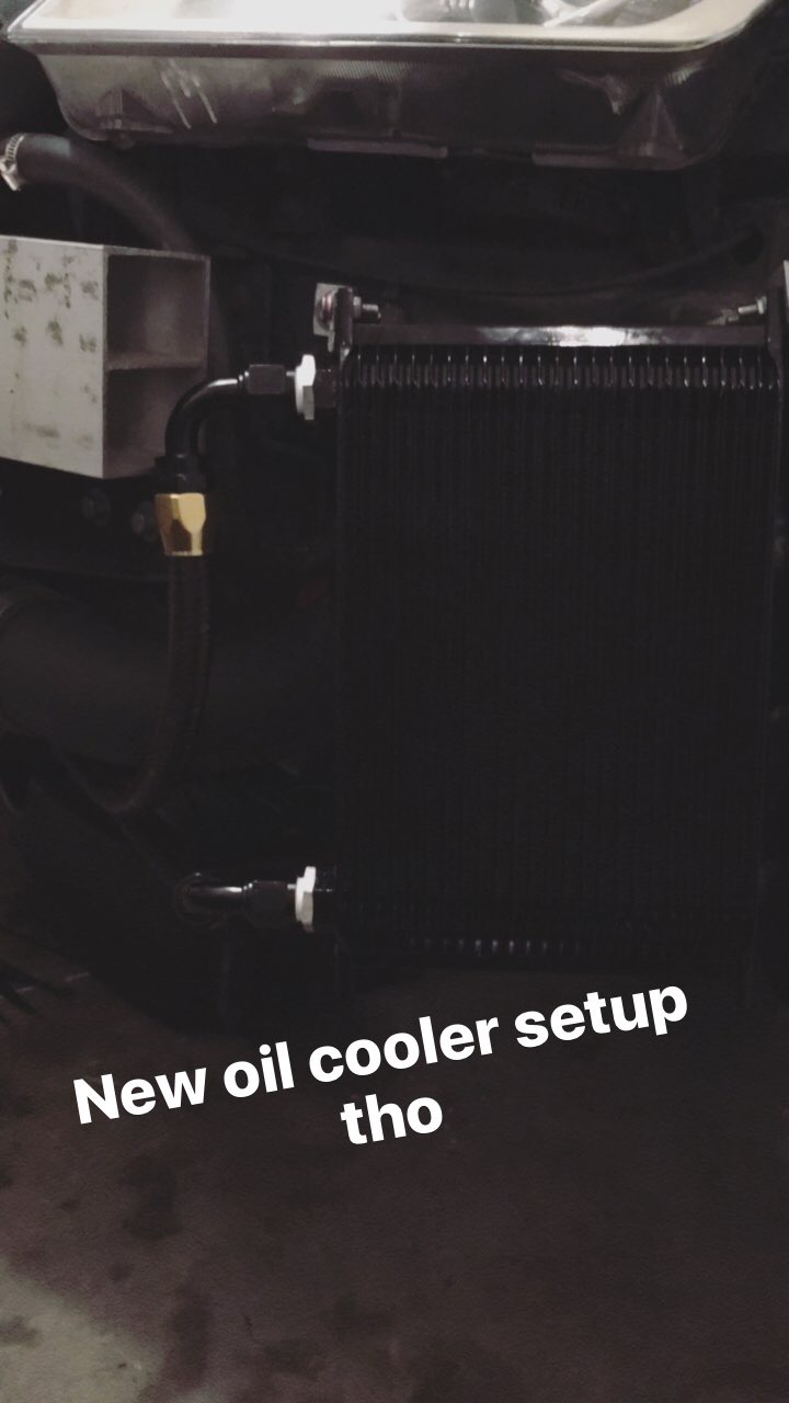

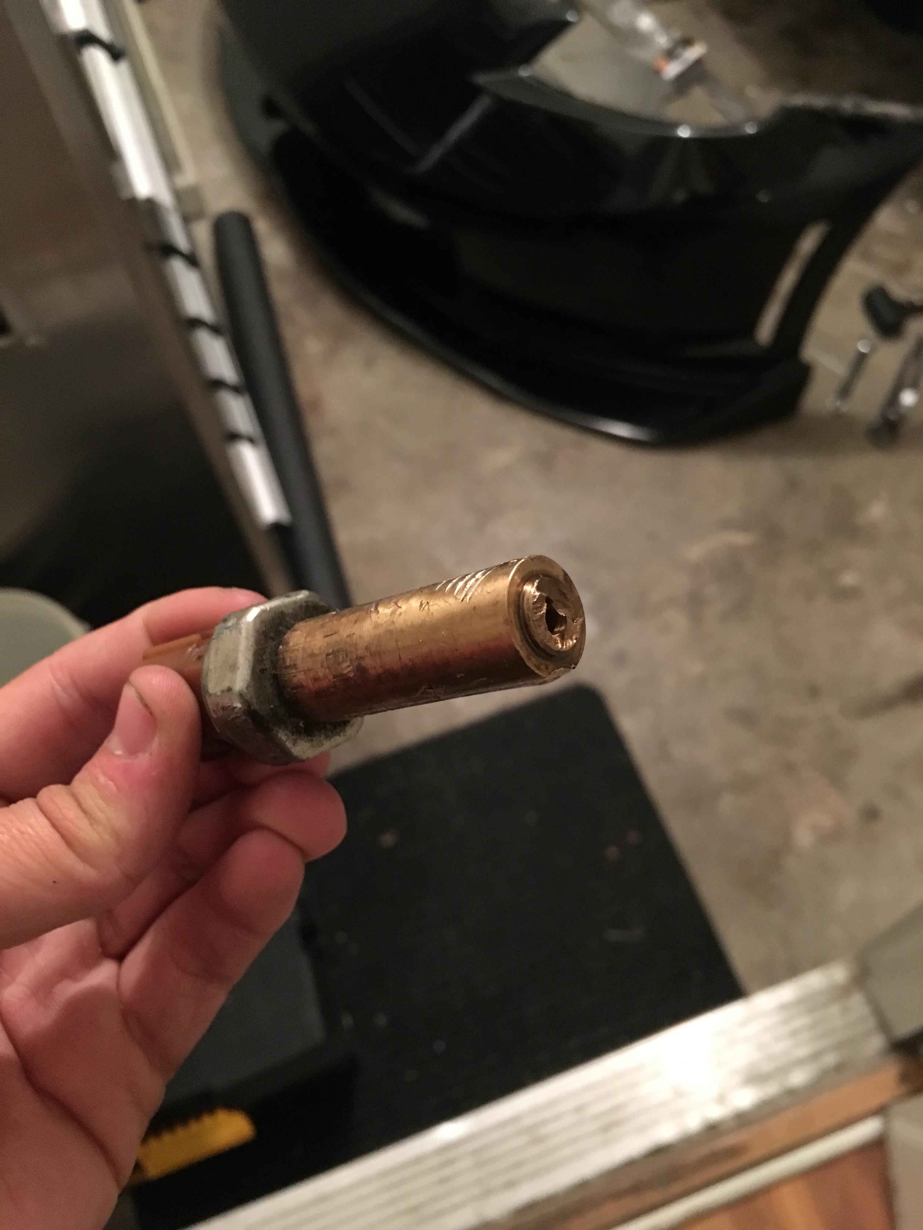

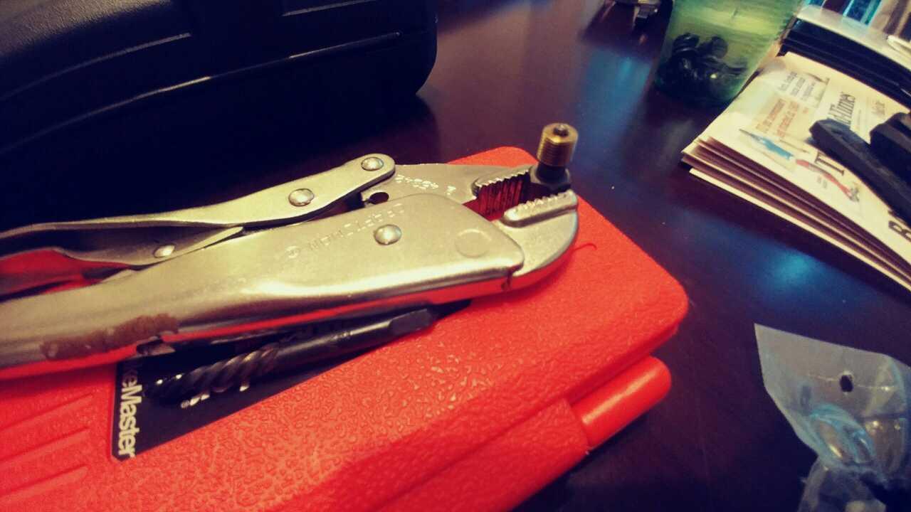

A few oil cooler pics, as well as more information on the oil cooler install/change.

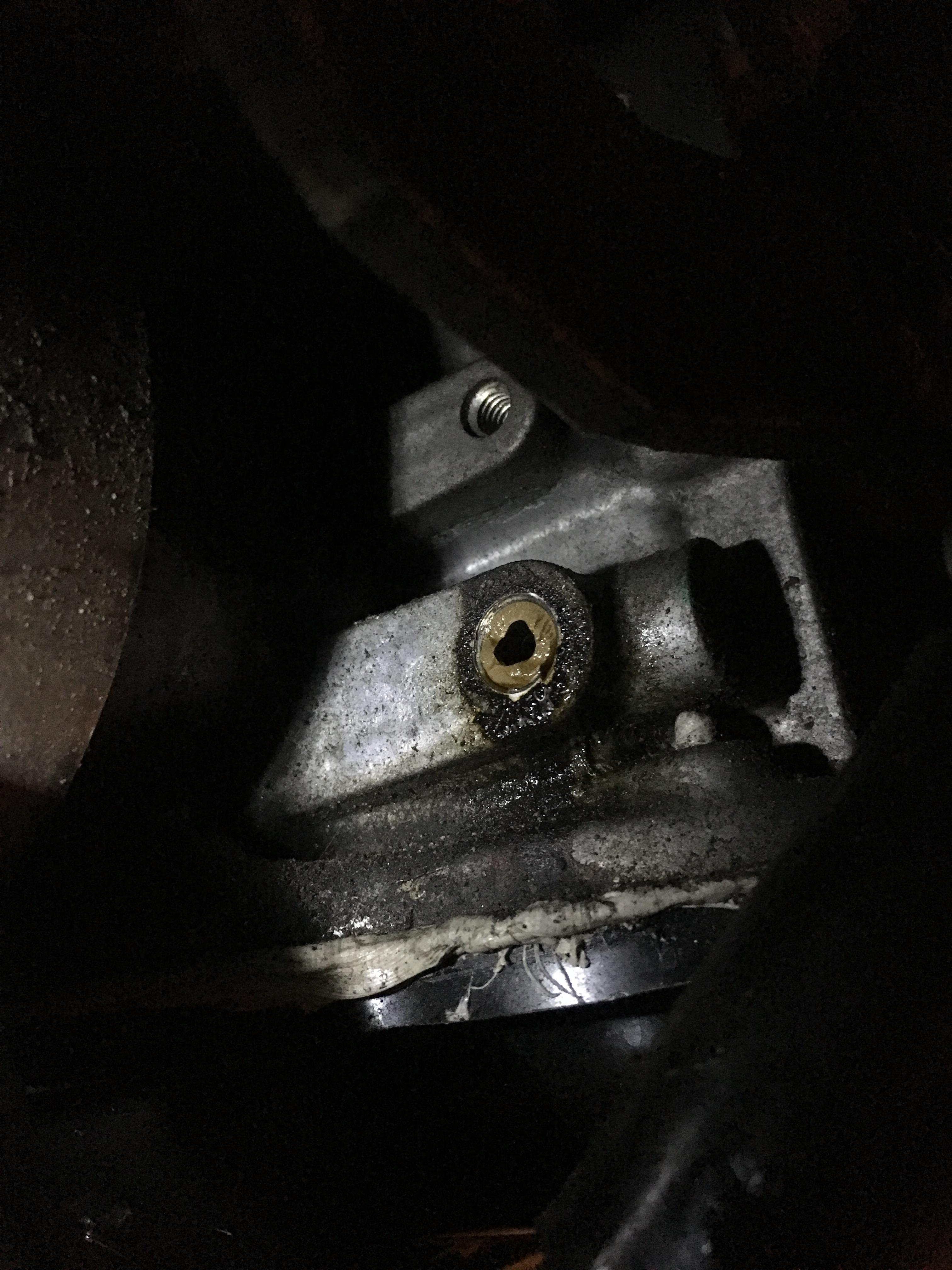

So with the oil cooler install, I wanted to rotate the sandwich plate a bit more so that the AN fittings weren't as low as they had been on my first iteration (AKA why I'm replacing this in the first place *oops*). In doing so, I needed to unscrew the oil feed tee from the block. Well, I found the design flaw in Momentum's kit... they supplied the kit with a brass tee. Brass... c'mon. So I had to overnight a new steel fitting from TrackSpeed. Thanks to the guys over there for getting me sorted out. Threw the new fitting in with some RTV on the threads, same with the oil pressure sensor and the adapter for the oil feed line.
Thankfully this was super easy to get out of the block. This could've been FAR worse than it was haha.

And after that, I was able to get everything else assembled and buttoned up. Fits just right!
After getting everything fitted up and the car cleaned, went for a shakedown. NO oil leaks, and oil pressure is HOLDING right where it needs to be. Need to get my oil temp sensor working still, need to measure the ohms from the sensor itself and get back to Tanabe about that, probably this weekend.

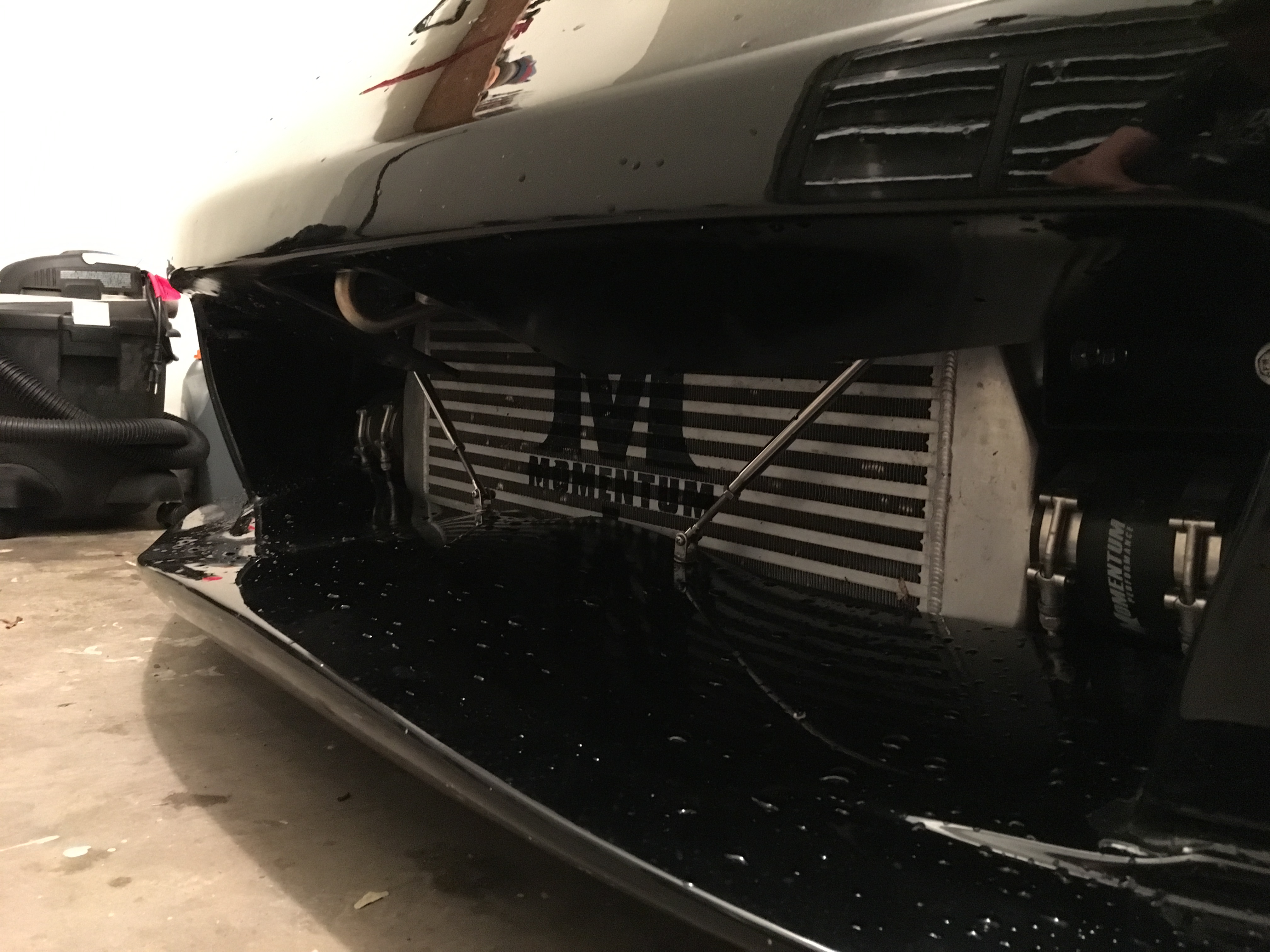

Threw on some support rods to the bumper this past sunday in order to even out the curve in the middle of the bumper. Gives it a great appearance imo, and fixed the issue I was having.

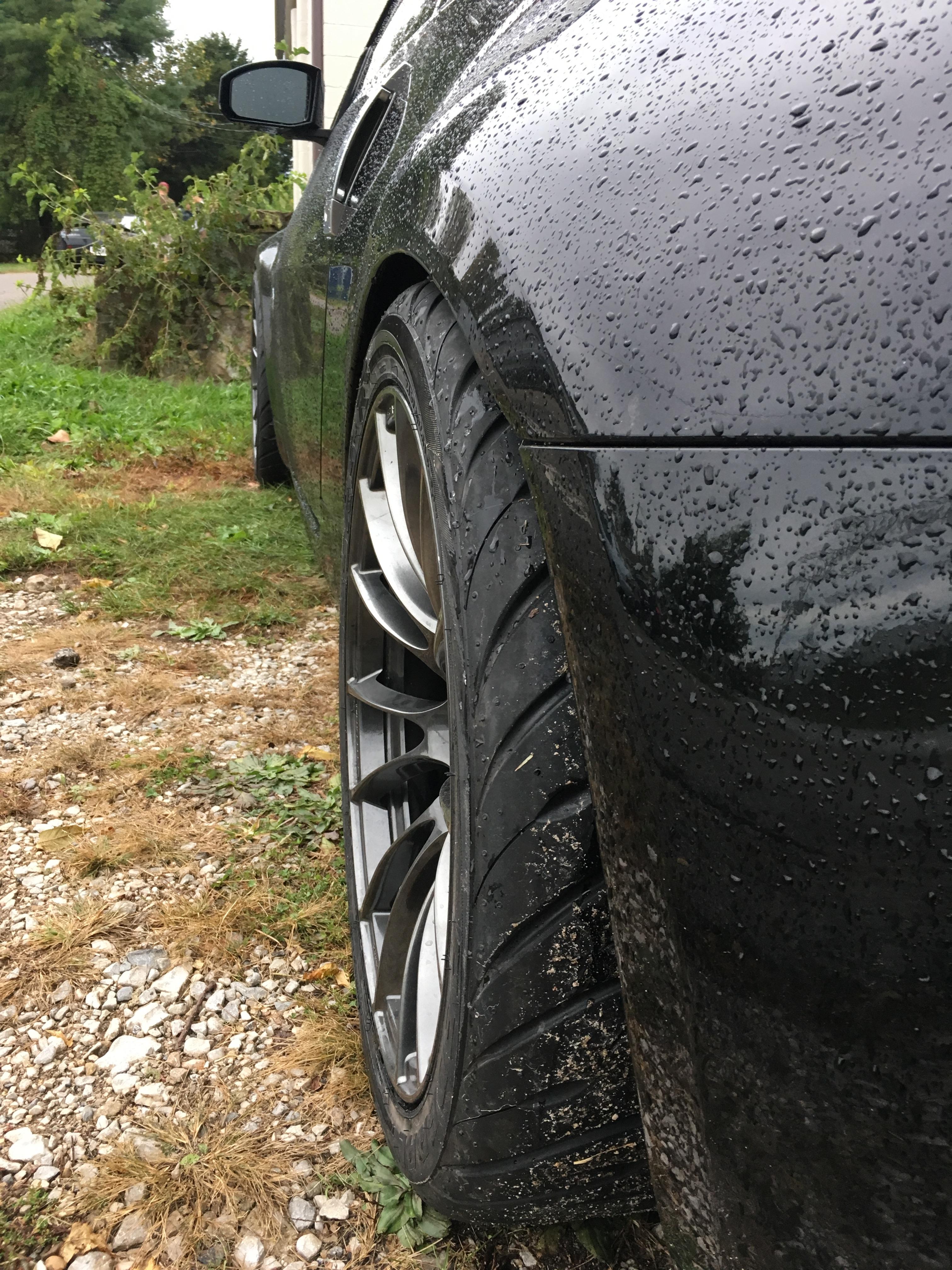

Got my new tires mounted today, and had the brakes bled over once more to ensure everything was perfect. They managed to get a bit more air out of the fluid, and the pedal response is so much better than it previously was. These new tires are SO noisy, but I'm excited to see how they handle on the track. Federal 595 RS-RR 275/35/18 on a 18x9.5 et12. Looking at getting the car aligned this weekend, planning to adjust the front to -2.5 since the new tires are so much thicker. They rub when I hit a bump, so not wanting to deal with the tires rubbing when there's a load on the suspension in a corner. Also adjusting the rear to -1.5 (so jumping back a half a degree) to give a bit more contact for the rear of the car.
