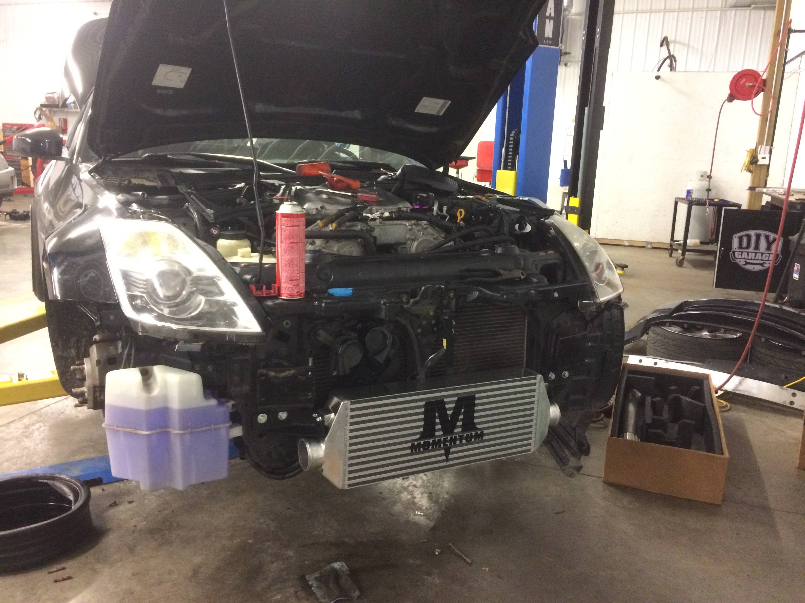

And photo dump from the weekend. To start things off, I started by installing this kit at a shop called DIY Garage in Indianapolis, IN. Tyler and the rest of the staff were amazing people who took care of me and helped me here and there along the road. Without such an amazing place to install my kit, it would have never gotten done.
I had a lot of friends chime in a lend a hand, and I am more than grateful for that. Thanks to those of you who helped, you know who you are!
I wish I had gotten more pictures than I did, but this is all I have, so work with me here haha.
Starting to disassemble the engine compartment to make room for turbo things.

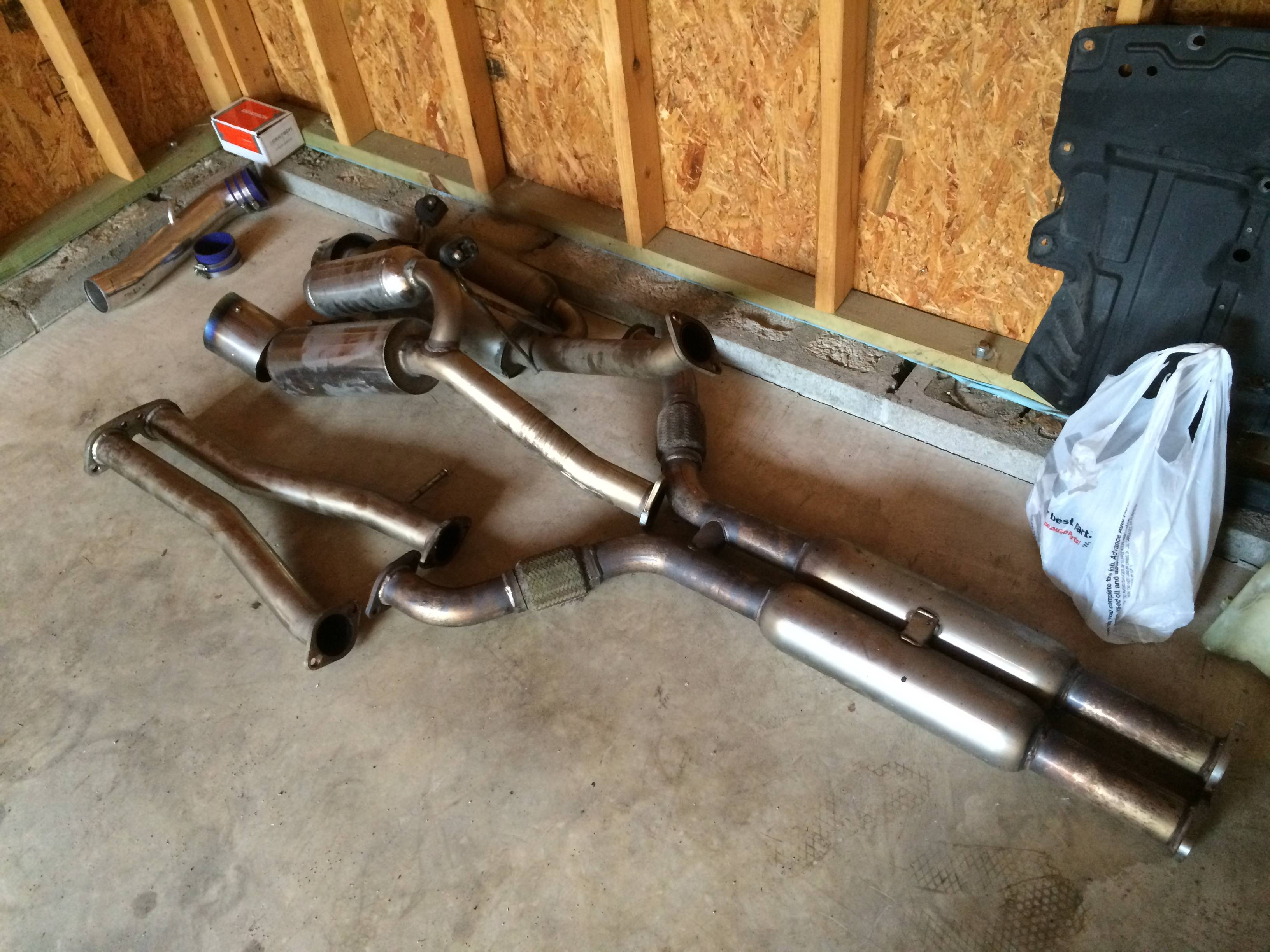

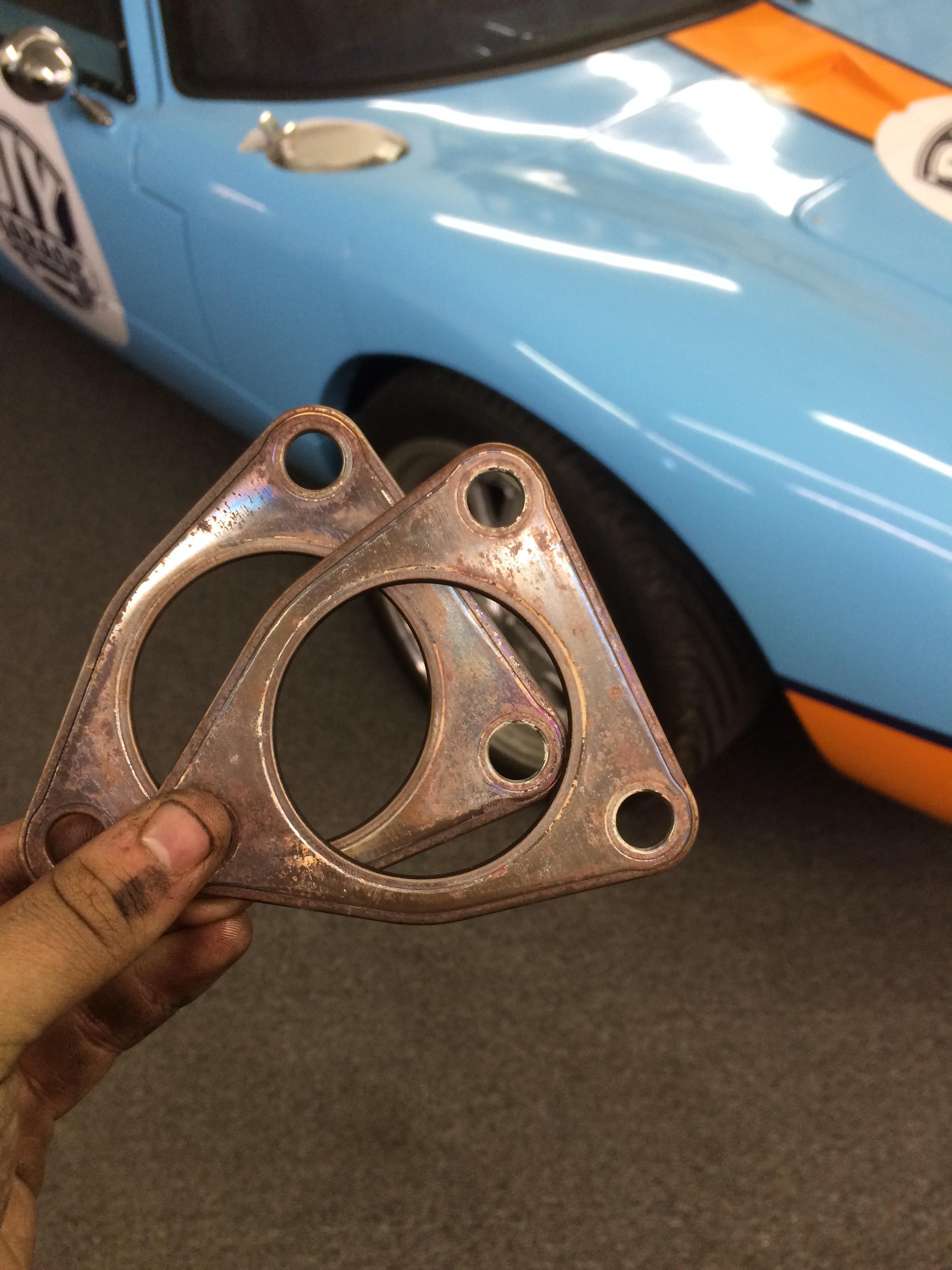

Got the exhaust taken off, went to put the up-pips on to the collector pipes. Thought I had lost the gaskets for it, turns out they were sitting on my cats still. Thank god.
Interestingly enough, I had picked up an automatic transmission kit. I run a manual transmission, the only problem I ran into was that the primary O@ sensor doesn't fit in the up-pipe where Momentum had intended for it to. I didn't have to shave my transmission casing either, so that was nice. Here's an undercar view of how close everything is.

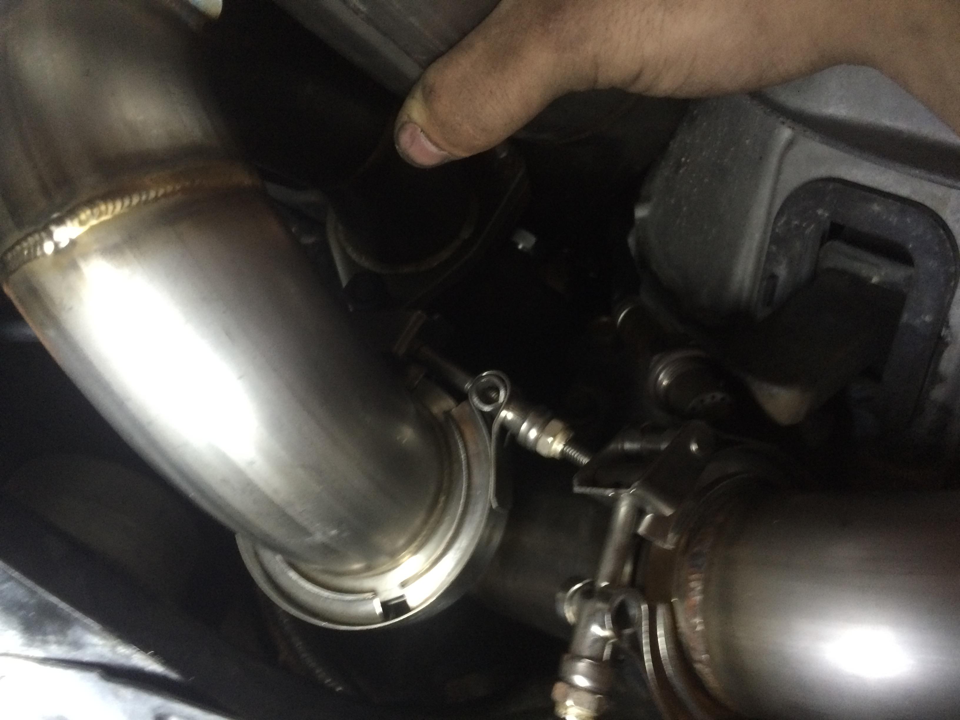

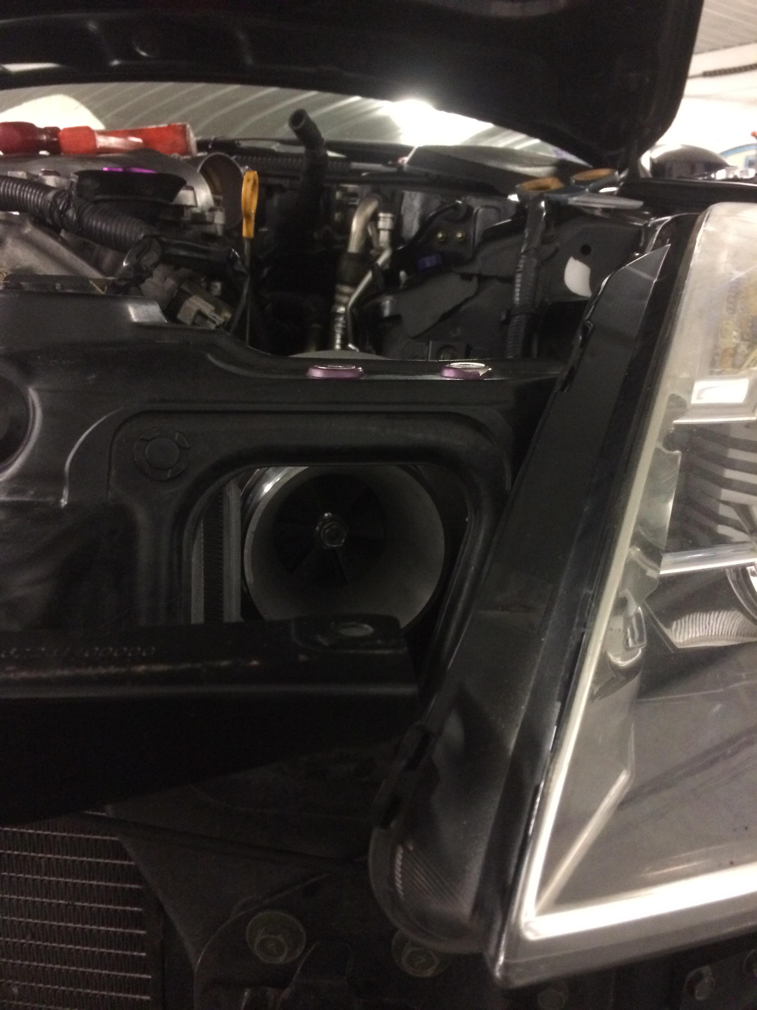

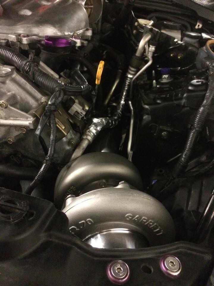

Seriously, getting this freaking turbo mounted.. dear lord. Clock, clock, clock, and then clock again. This was at the end of the night, so I stopped here and took pictures to show friends that I did at least get it mounted into the car finally haha.
Another picture from further away that night after getting the turbo mounted. Intercooler mounted and all lines ran for the most part.

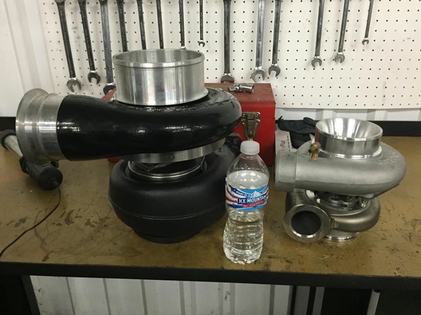

My buddy wanted to compare his turbo to mine. It's really odd, because the GT35R is not a small turbo at all.. I mean, I guess it's "normal" sized. This is going on his 1500hp drag car.

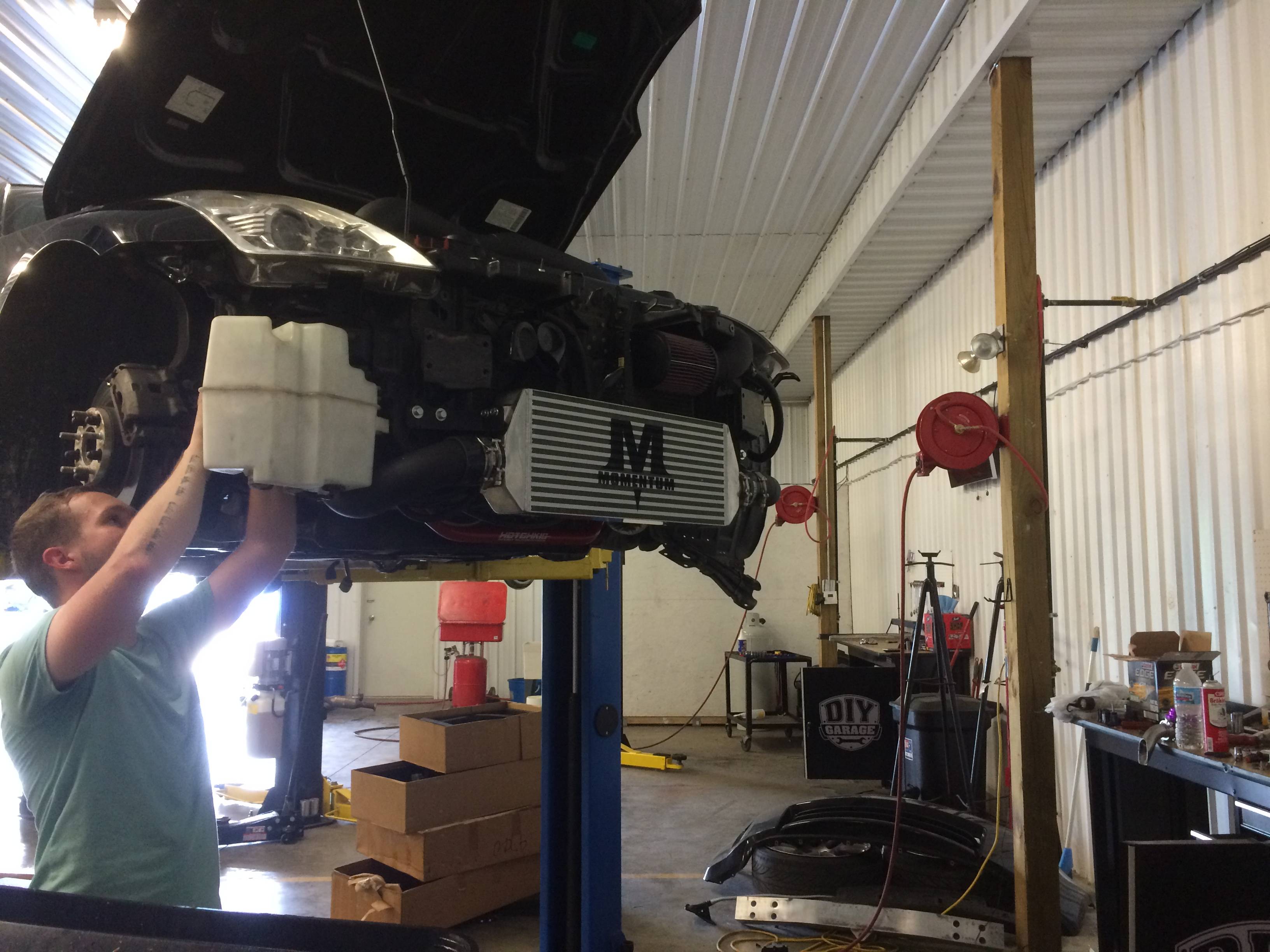

Getting the intercooler piping ran, got the air filter on, working on getting the washer fluid reservoir to mount again after putting the intercooler piping through there. Thanks to Dustin and Justin for dropping by and lending a hand. Seriously great friends. Dustin ended up staying all night with me to help me finish up. What a great friend!

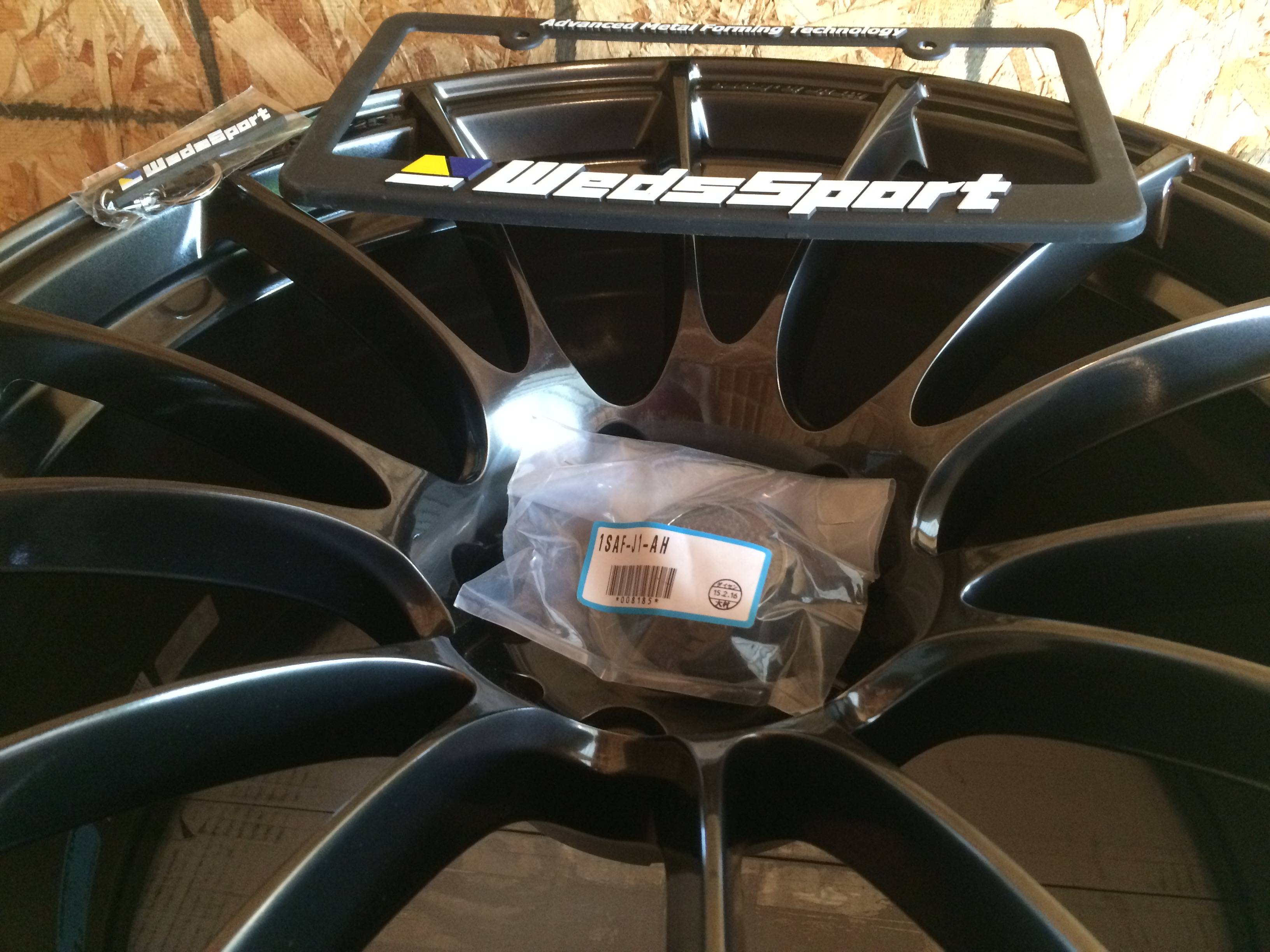

The day I finished the turbo stuff, I came home and the UPS man showed up with some more goodies. These things are beautiful. So lightweight, very quality finish and packaging. Thanks to RavSpec for hooking it up!

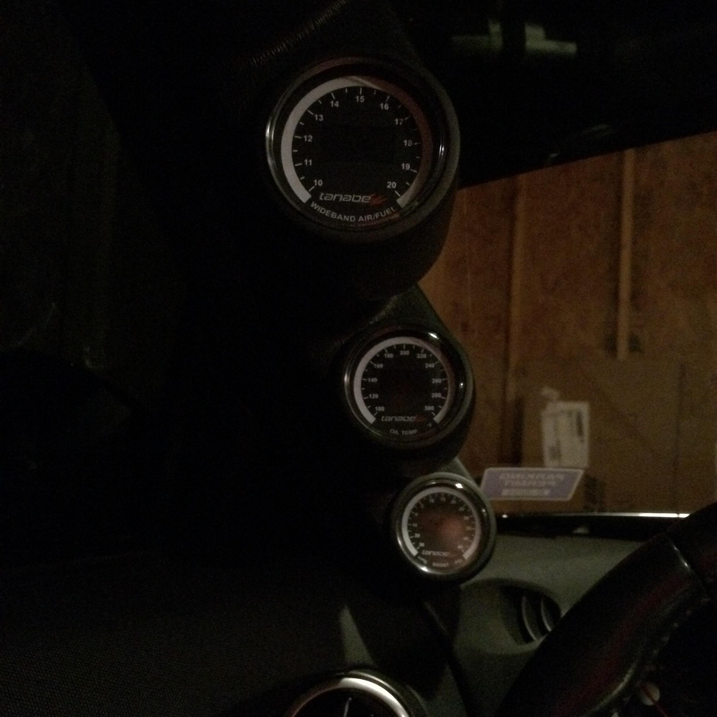

Also, not sure if I posted these or not, but here are all of the Tanabe gauges installed. They're not currently wired up, but will be by this weekend for sure. I used a Glowshift triple gauge pod to install these with. Honestly, the quality of the Glowshift was pretty good. I was expecting much worse, I have no complaints with it, to be honest. John and Premiere Auto Sports LLC hooked me up with the gauges, the pod, and my new coilovers. Such a great guy, highly recommend doing business with him.

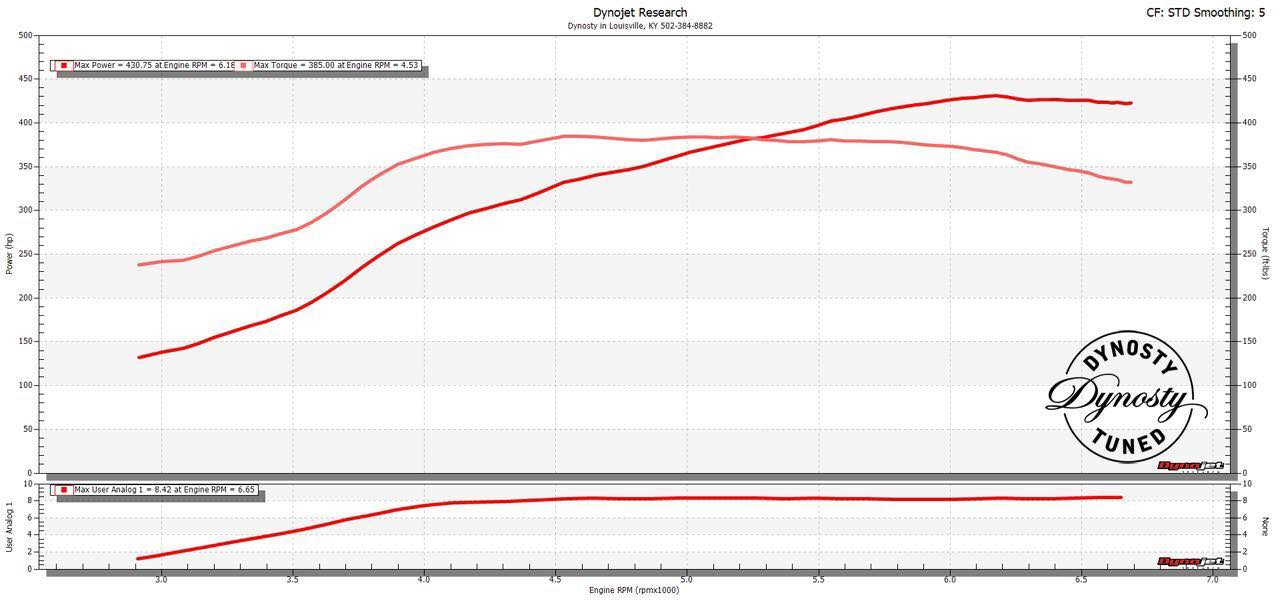

Ended up getting the car back from Dynosty after many nights of no sleep. I had nightmares of my car exploding on the dyno, yadda yadda haha.
This is my first boosted car, and I'm in love with it already. The car is almost obnoxiously loud thanks to the external wastegate. But it's only above 4k when the boost is at peak. And at that point, I don't really mind it because I'm trying to have fun haha. So far I love it, huge thank you to Dynosty and the guys.
Here is my dyno sheet for those interested

Thank you! Motor is not built, it's on stock internals for now. According to Dynosty, the tune is very solid and the numbers are safe for a stock motor. My tune was meant to be able to be bashed on day in and day out and still have a nice running car at the end of the day.
But, nevertheless, I will be saving for a built motor at some point just to ensure everything is 150% safe down the road.
