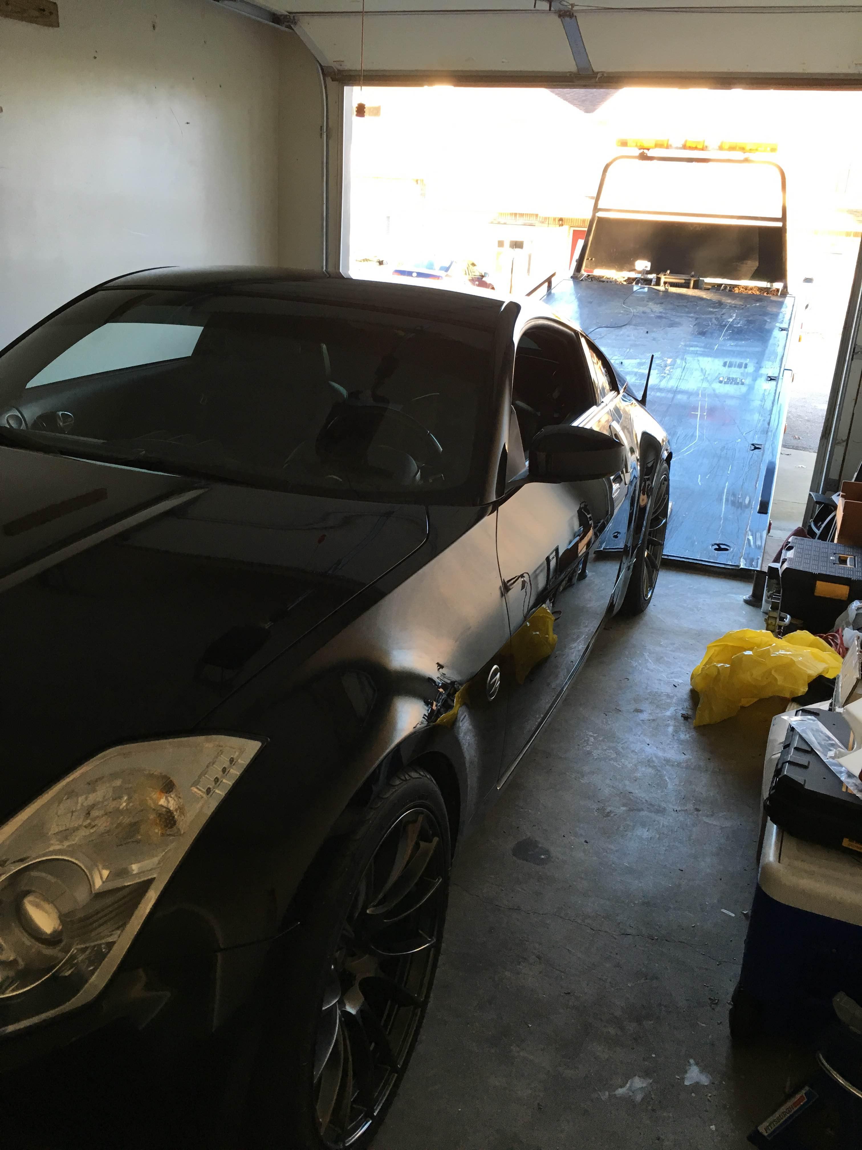

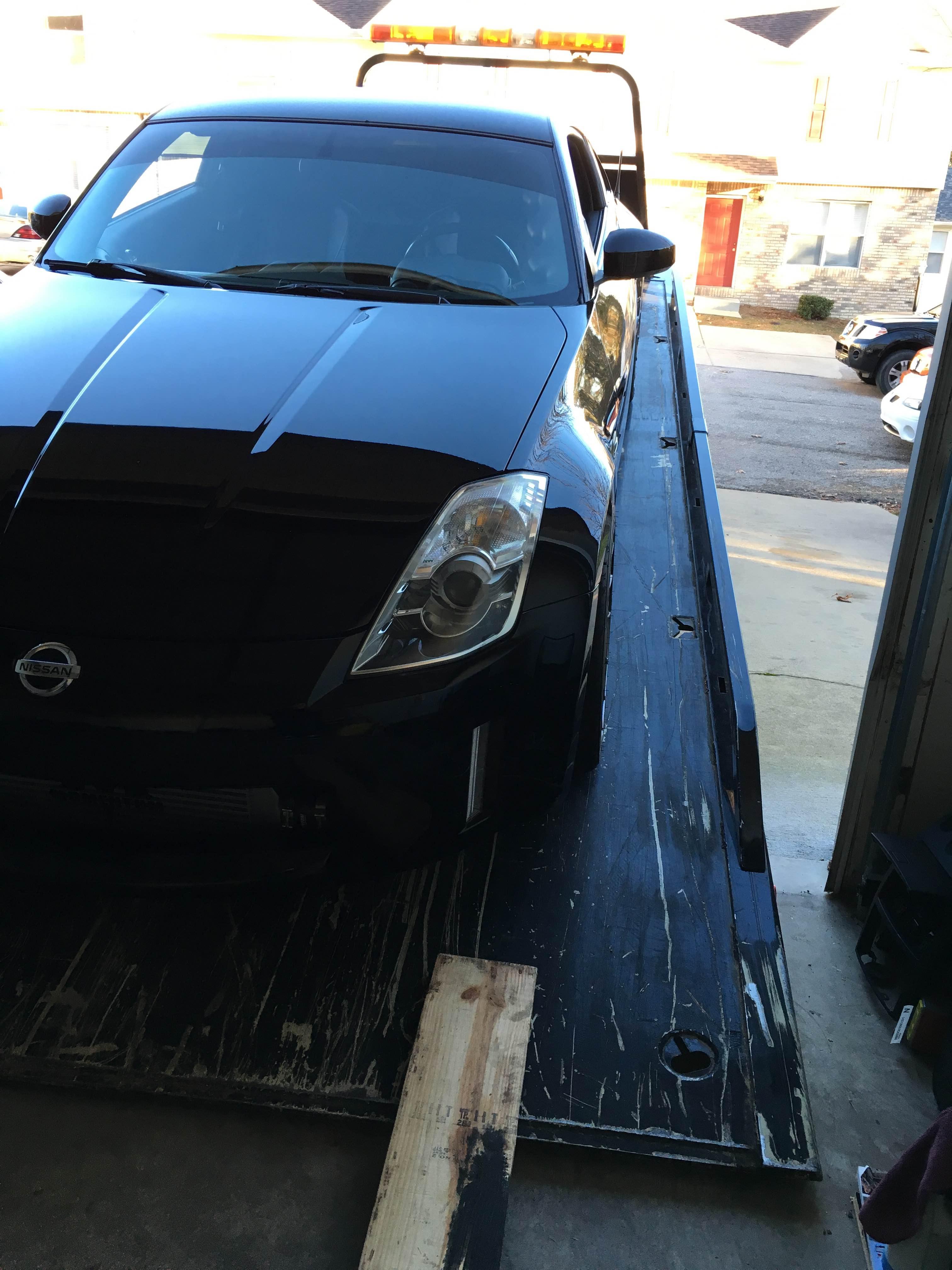

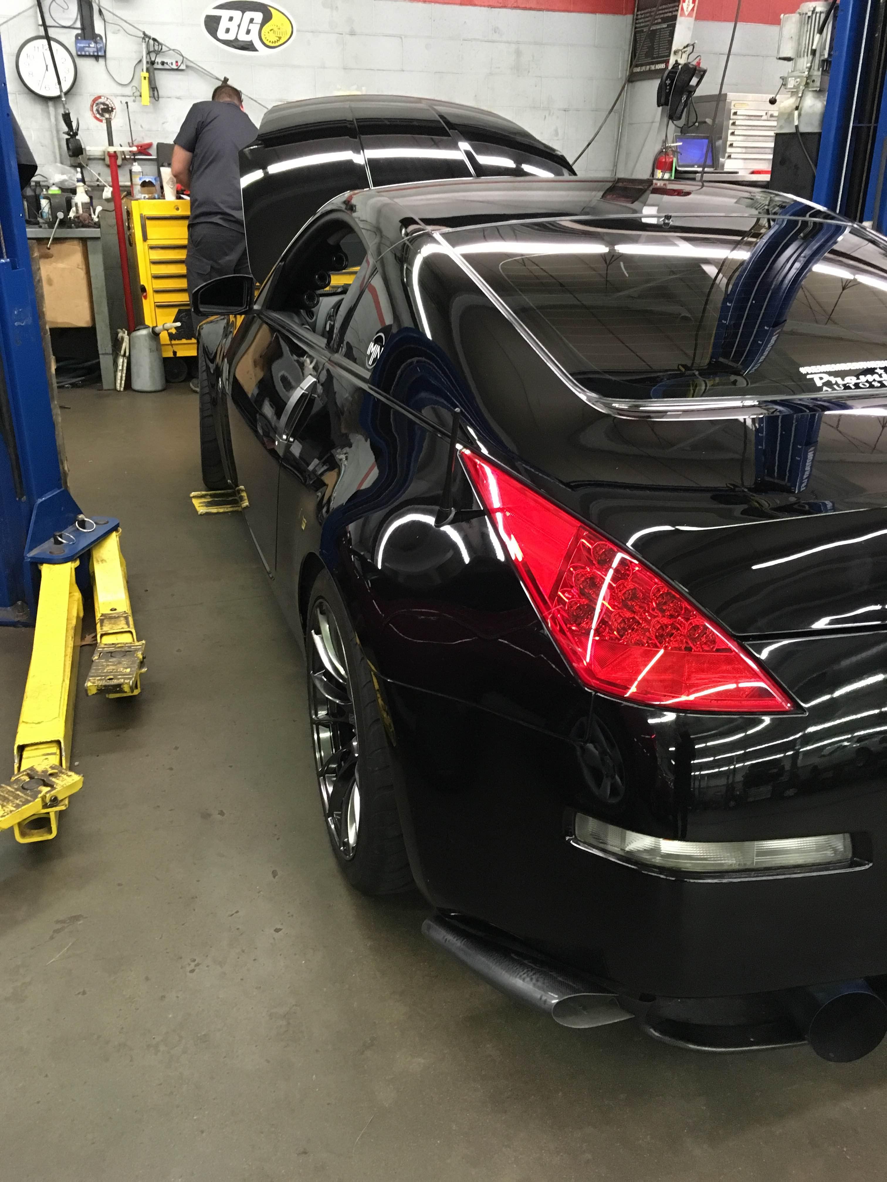

Anyhow, here are some pictures from my trip to Nissan. Now I just need to find a CX ECU and I'll be good to go, or so I think.
As the tow truck backed up to the garage/got the bed to the door.
Finally on the truck after about a half hour!

Sitting in the Nissan shop while we run sensor checks :/

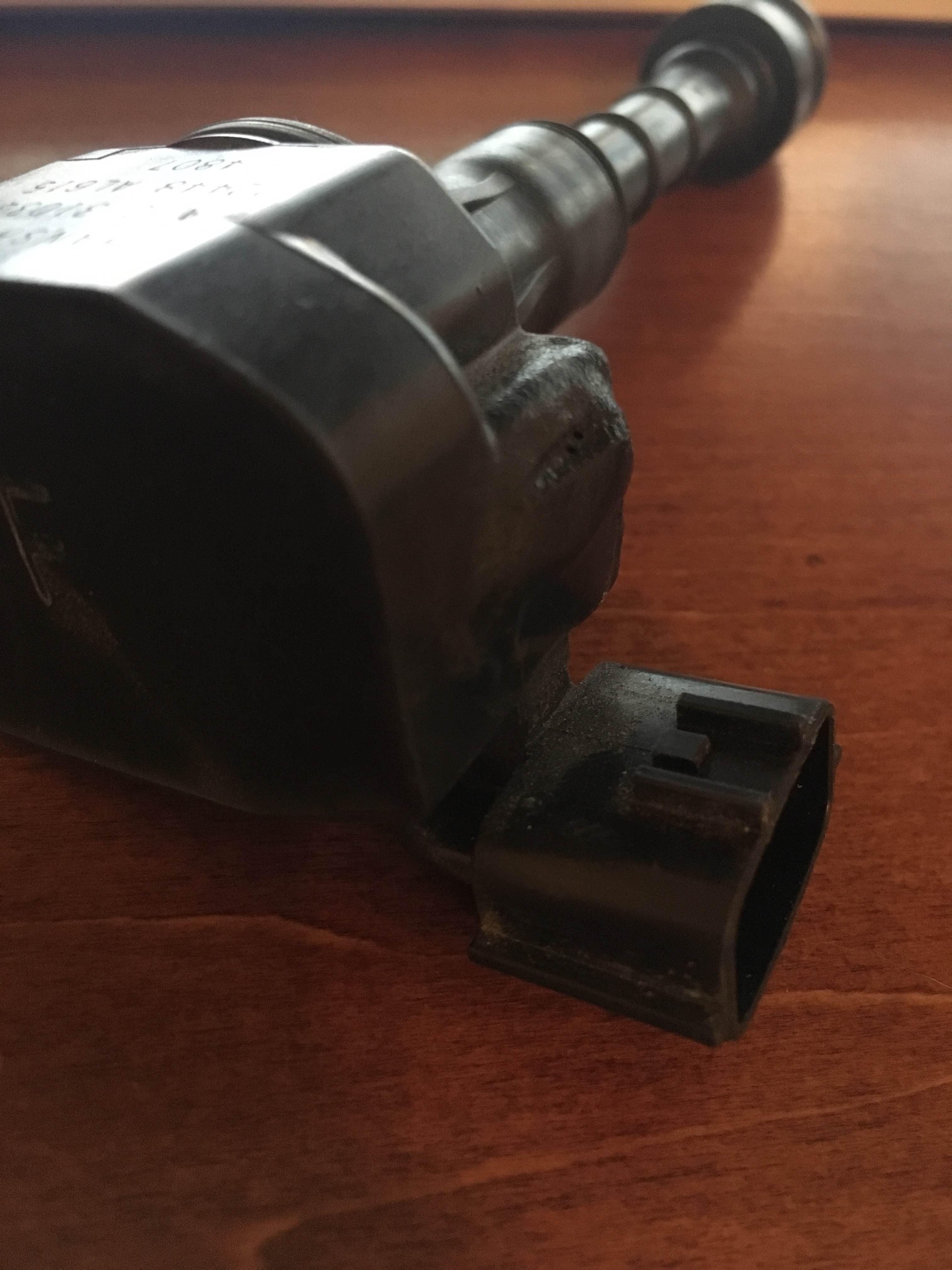

But what is weird is that the ECU went bad on a rainy day, and the ignition coil fried on that same day. So for some reason, I'm led to believe that my car just doesn't like rain. I'm familiar with people using RTV to seal up the grommet heading to the ECU on the passenger side firewall, but is there anything else I should be looking for?

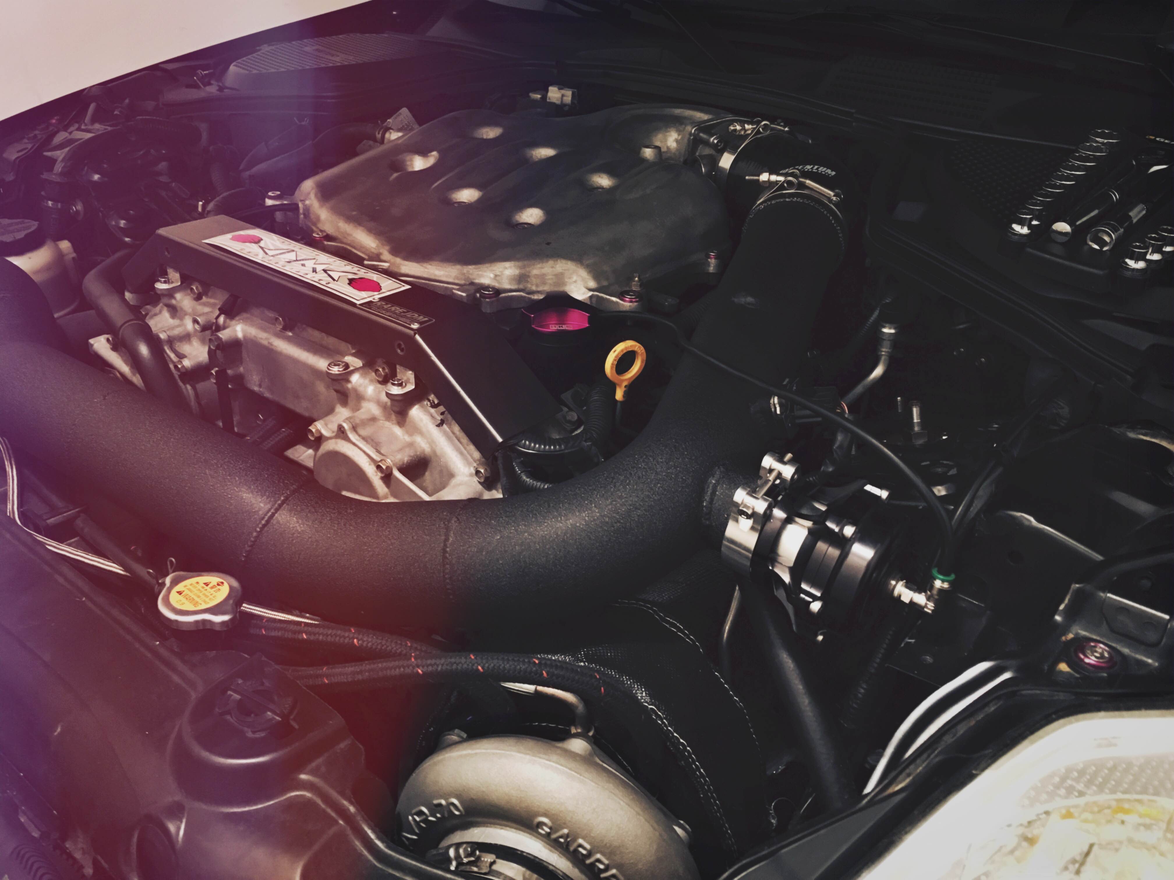

Obligatory pics or GTFO. Including my first pump pic in ~three months, gauges lit at night after a long work day, followed by ignition coil pictures.

Well, today I went and picked up another couple of coils from my buddy at the Nissan dealership. Double checked to see which cylinder was misfiring, and it is cylinder 3. Unplugged the coil to see if that made the misfire worse, and it did not. Which nailed it down to that cylinder. Switched a new coil in there, still misfiring. Seems that the issue is not the ignition coil, which is good (for now).
So next step was to check my AFRs, which are in the 16s at the moment, so it seems like an injector issue at this point. So I tore the top down and switched injector 3 over to injector 1 to check and see if the misfire hops to cylinder 1. Pending that it does, I have a bad injector.

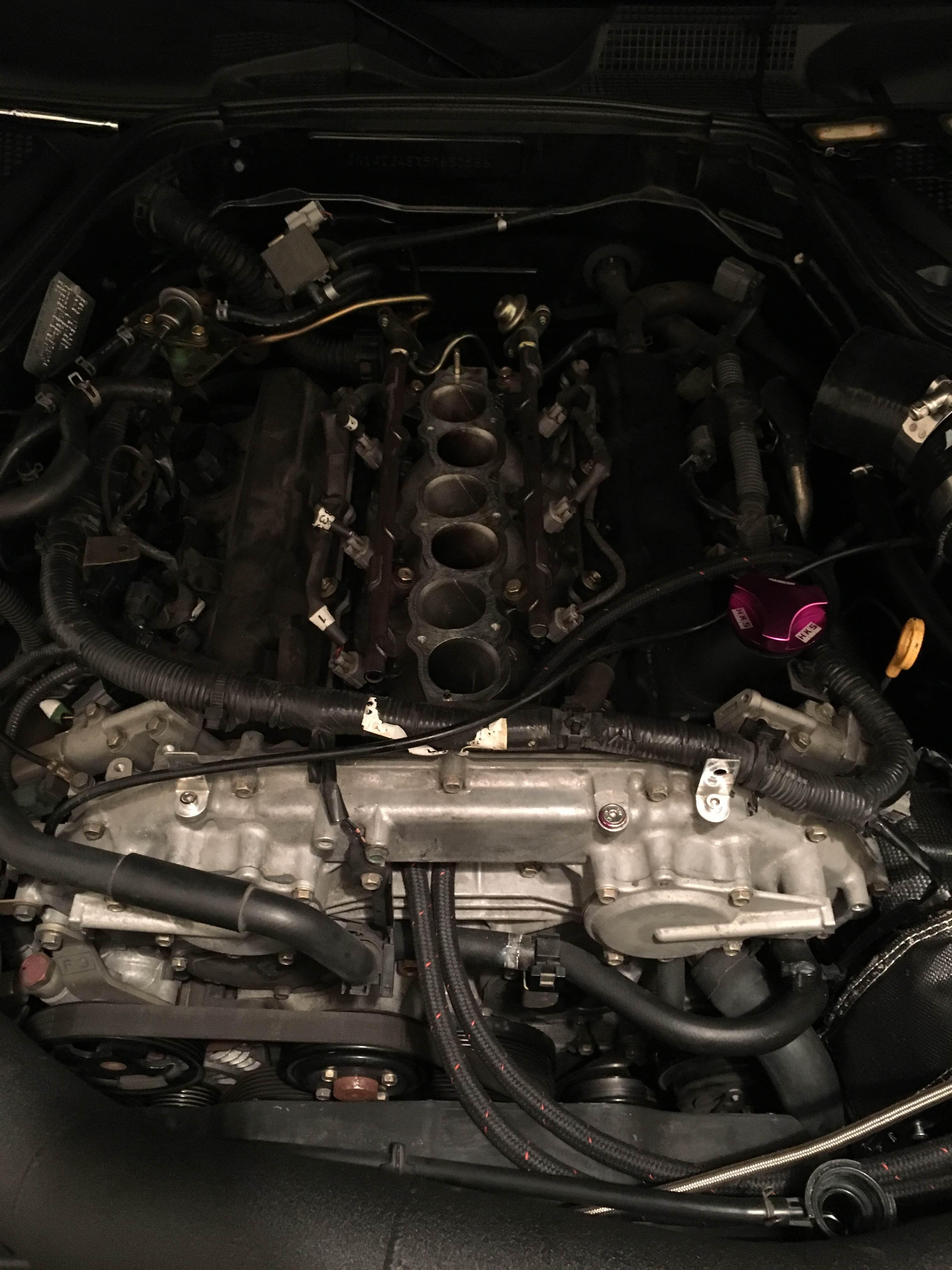

Also some pictures from the tear down/before. Reassembly when I get home from work and then I'll fire it up to test out which cylinder it is.

So some long awaited updates. If you guys follow me on Facebook or Instagram, then you've probably already heard what is going on.
After swapping injector 3 to injector 1, the issue did not hop cylinders. So injector 3/1 are both good. Checked the coil once again, and changed the spark plug just to be certain. Spark was good (after confirming with a spark tester just to ensure that the ignition coil harness wasn't the issue). After confirming that the spark was in fact okay, I feared the worst (it was down to compression or the wiring from the ECU to the injector) so I went ahead and checked compression and the compression was just fine. So now it was time to do a noid light test with the injectors (this is a freaking pain), but I had to do it. After doing this, I did not get any light coming through from the injector harness (which means that the signal is not being sent from the ECU to the injector #3 harness).
Followed the wiring back from injector #3 to the ECU and there are no cuts or obvious shorts anywhere. So my assumption here is that I am getting water coming through the firewall that keeps harming the ECU and shorting things out.
Going to try and get the driver working for injector number 3 and see if we can't get the car running on all 6 again. If not, I'll be saving up for standalone :/
