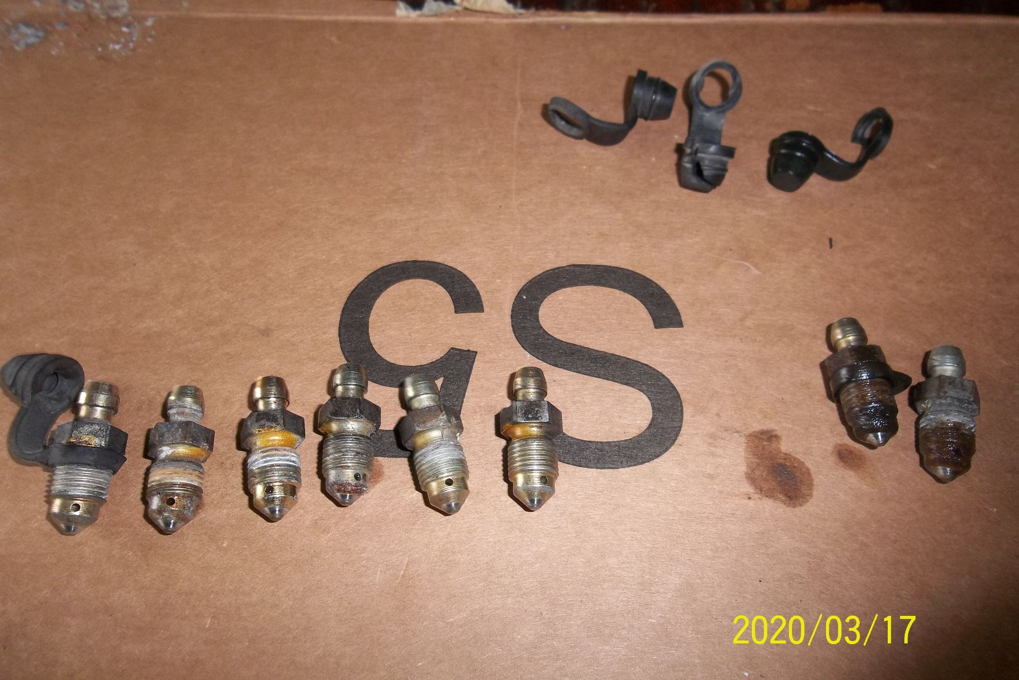

Finally started bleeding my brakes today, first bleeder was going slow, 2nd wouldn't bleed. Pulled it out and the weep hole is rusted shut. Ordered 8 m10x1 speed bleeders. They will have 4 tomorrow and the rest on tuesday at the latest. Didn't bother checking them all. Figured with the amount of corrosion i saw, would be better to just replace all.

New bleeders installed, only 2 were actually bad but used all the new ones anyway. New bleeder caps coming from amazon as well.

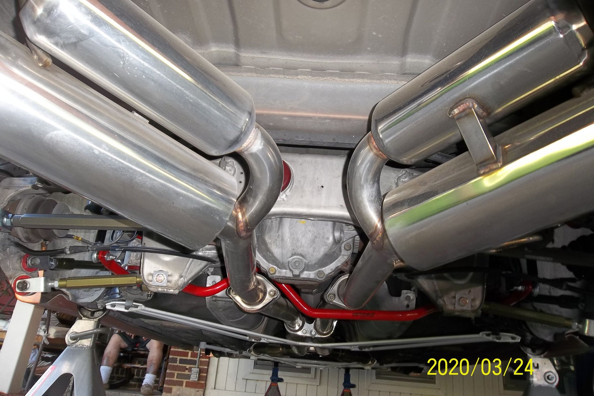

Installed rear sway, toe arms, new spl lockouts and started on traction arms. Had 2 wrong heim joint adapters which are being rushed to me along with a very nice big apology.

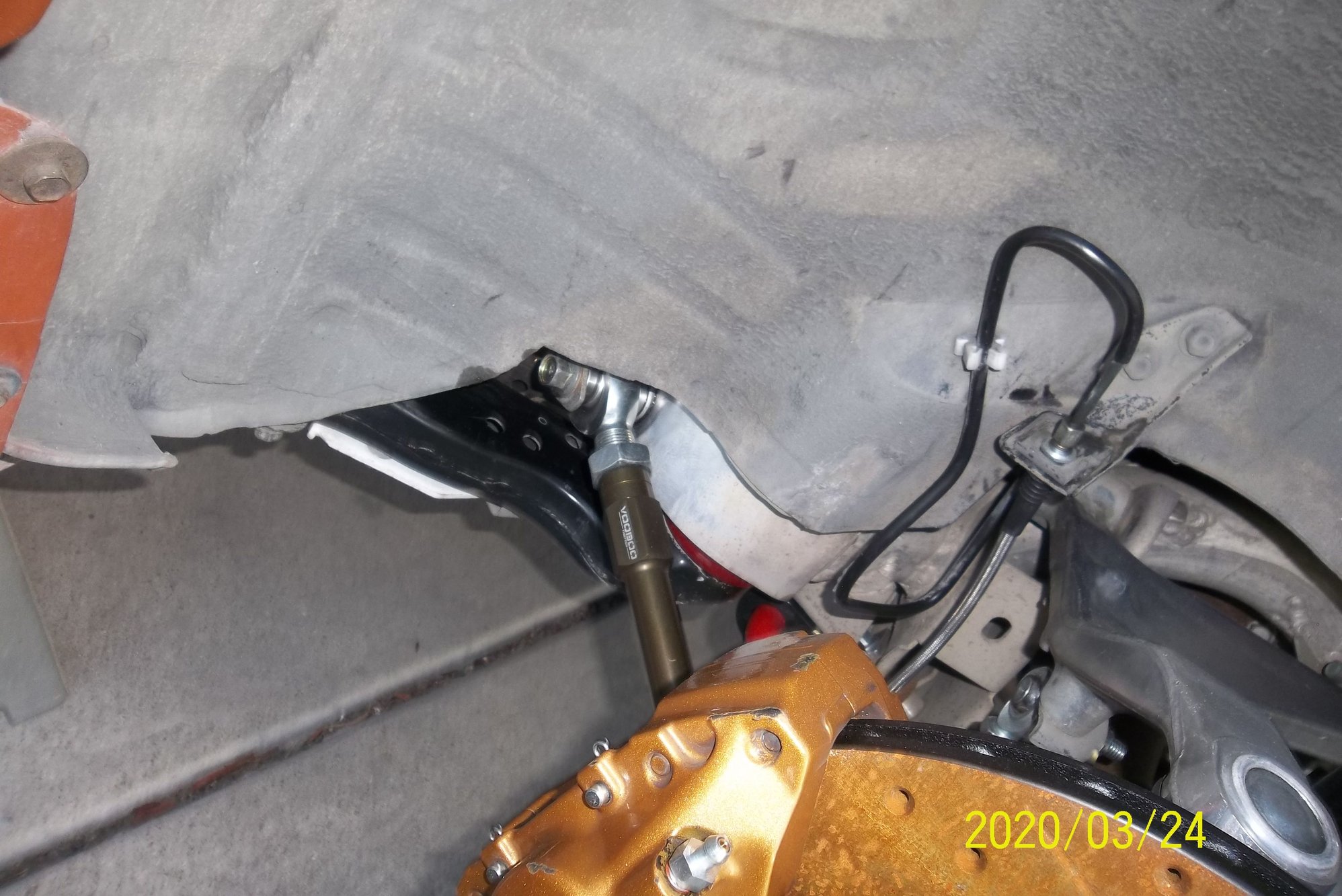

Everything in the back is done other than the traction arms that i had an incorrect part on. Waiting on those parts to come in.

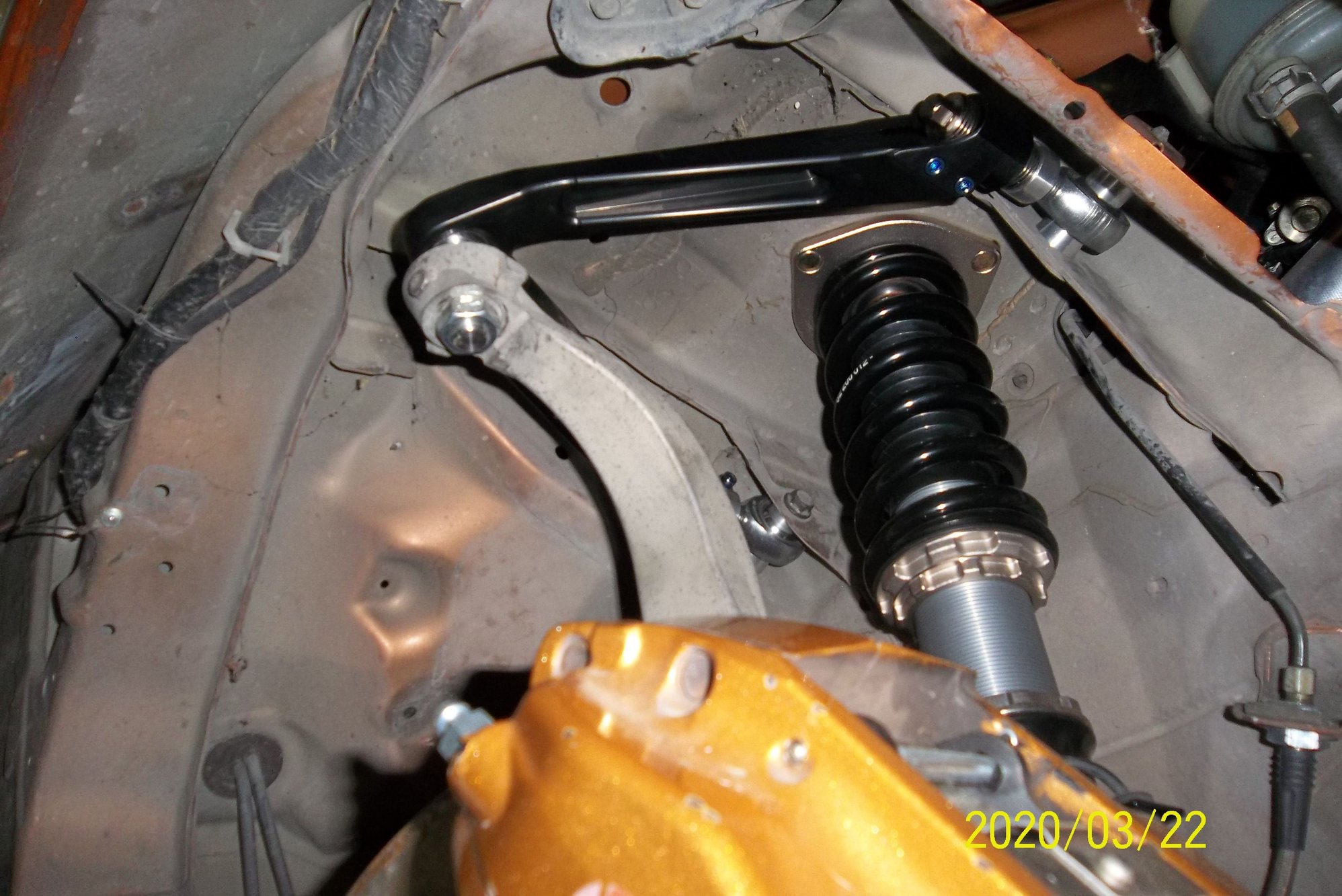

Few more parts installed, forgot to take a pic of the spl fuca and front sway before installing. Didn't get the chance to install the front ultra rev subframe connector due to needing a press to install the spl compression arm bushings. Here are a few pics for now.

Rear traction arm parts came in. Bleed brake system and clutch with the motul 5.1. Clutch fluid was horrible. Will probably bleed out again in a month or so. Time for some pics.
