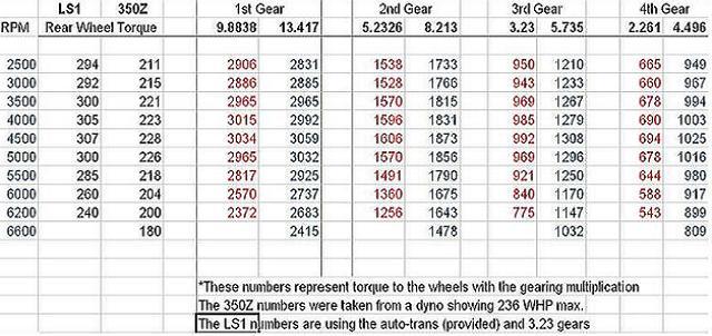

I'll oblige on that. Here you go: My Intake/Exhaust Dyno
While that dyno is not completely stock for my car, it is from when I just had a lid and catback w/2.73 gears. My car is an automatic, the gear ratios go like this (I will only do factory optioned automatic ratios 2.73 and 3.23). The shift speeds for 2.73's are the ones I saw from personal experience, the 3.23's are from a gearing calculation program (www.f-body.org/gears)
1st - 3.06:1 (0-55mph with 2.73 gears or 0-46mph with 3.23's)
2nd - 1.62:1 (55-98mph with 2.73's, 46-87mph with 3.23's)
3rd - 1:1 (98mph-160mph computer limited, 87-142mph with 3.23's)
4th - 0.7:1 (cruising gear with 2.73's, 142-160mph limited with 3.23's)
So, from a little bit of math, total torque multiplication looks like this for automatics.
2.73's 3.23's
1st - 8.3538 9.8838
2nd - 4.4226 5.2326
3rd - 2.73 3.23
4th - 1.911 2.261

Using your numbers and a dyno-sheet from a 350z I came up with this. I do not claim that these numbers prove any point. The 350z is a stock dyno. The gear ratios for the 350Z are as follows:
Gear 1 2 3 4 5 6 Final
Ratios: 3.790 2.320 1.620 1.270 1.000 0.790 3.540
The chart shows the compound ratios X hp torque @ RPM. I hope that this sheds a little more light on what power (WTQ) is actually laid down to the ground in each gear. If someone has better dyno numbers for either car (something better than 500 RPM increments) let me know.
Old Jun 5, 2003 | 10:09 AM
  #59
jooklum99's Avatar
jooklum99
Posts: 166
From: Dallas, TX
This is the chart. (It finally fits!)
