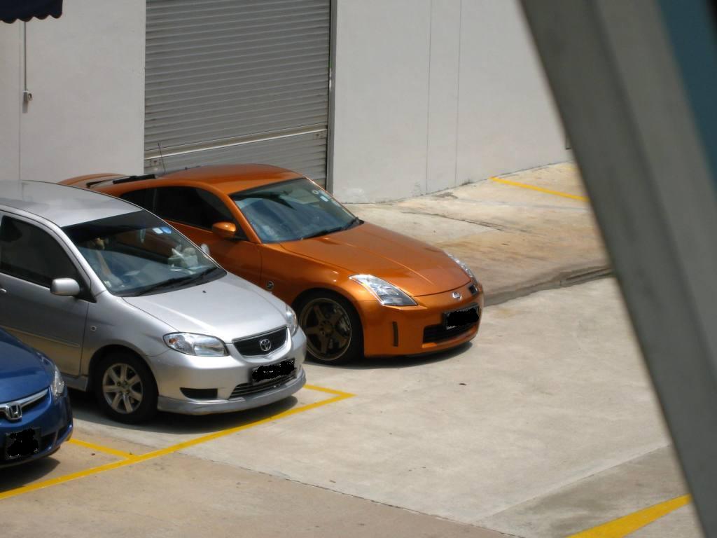

Gabe - I drive it daily to say the least. Here it is outside of my office window today. I track it accross the border in Malaysia at Pasir Gudang F2 track or Sepang F1 track but not often enough. The drive to Pasir Gudang is about 2 hours from my house, Sepang is 3 1/2 hours. The pump gas in Malaysia sucks so I can get a good run around Pasir Gudang and make it home but if to Sepang, I would need to be sure I can get higher octane with the maps I have for fuel mixture.
Attached Thumbnails All N/A Build up's, number, mods...Post 'em up-20-jan-10.jpg
