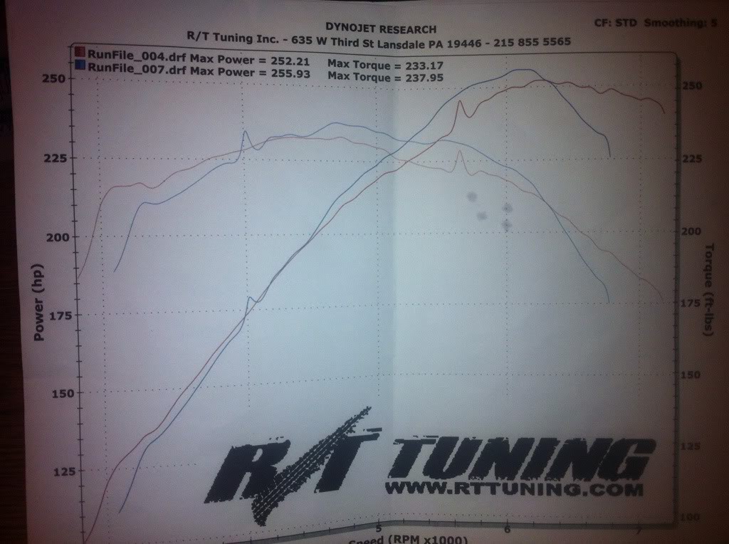

300whp with kinetix and supporting mods.
High 11s 1/4 mile. He does state a custom intake manifold, so im not gonna claim its a kinetix, hopefully 2bad240 adds to this thread.
and an oldie from Shin Beats....
Originally Posted by Shin Beats
I went to RT Tuning with the following mods.
TD exhaust
AAM test pipes
K&N filter
**Kinetix Velocity Manifold**
Vince had a car with the same mods, different brand (aside from the MD spacer,) in his logs and he compared my dyno with his. Both Z's were 04 5AT.
Here's the dyno results. Kinetix Z is in red:
Attachment 435598
As you can see the spacer DOES make more peak horsepower but that top end greatly benefits from the Kinetix. It helps the DE motor not fall flat on its face after 6000 RPMs. The kinetix actually makes more torque up until 4200 RPMs as well.
For my purposes, I like the Kinetix powerband better and think the Kinetix car will beat the spacer car through the 1320.

Cool graph, never seen that post before. With a proper plenum, there should be no reason to fall off that hard after 6.2?k.
