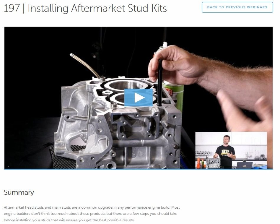

If you can or have interest in headstud / mainstud installation HPA has a webinar on them - unfortunately it's behind a paywall and you'd have to be a member but they put out all kinds of high quality stuff.
