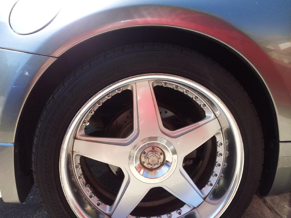

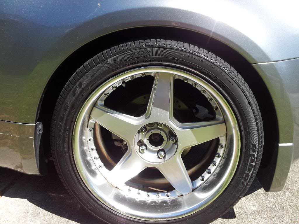

Sorry to resurrect an old thread but I have the same problem and there was never a resolution posted.
My left rear is rubbing the arch but the right seems fine. I can easily get two fingers between the tyre and arch on the right but can't do the same on the left.
Left - Eagle F1 - P285/35ZR19 90YY
Right - Potenza - P285/35RF19 99W
The previous owner clearly wasn't bothered by buying matching tyres and I want to get this sorted. How do I find out what the offset is?
I've measured the drop from the arch to the rim and the left side is half an inch shorter than the right. Does that indicate a problem with the springs?
Rob

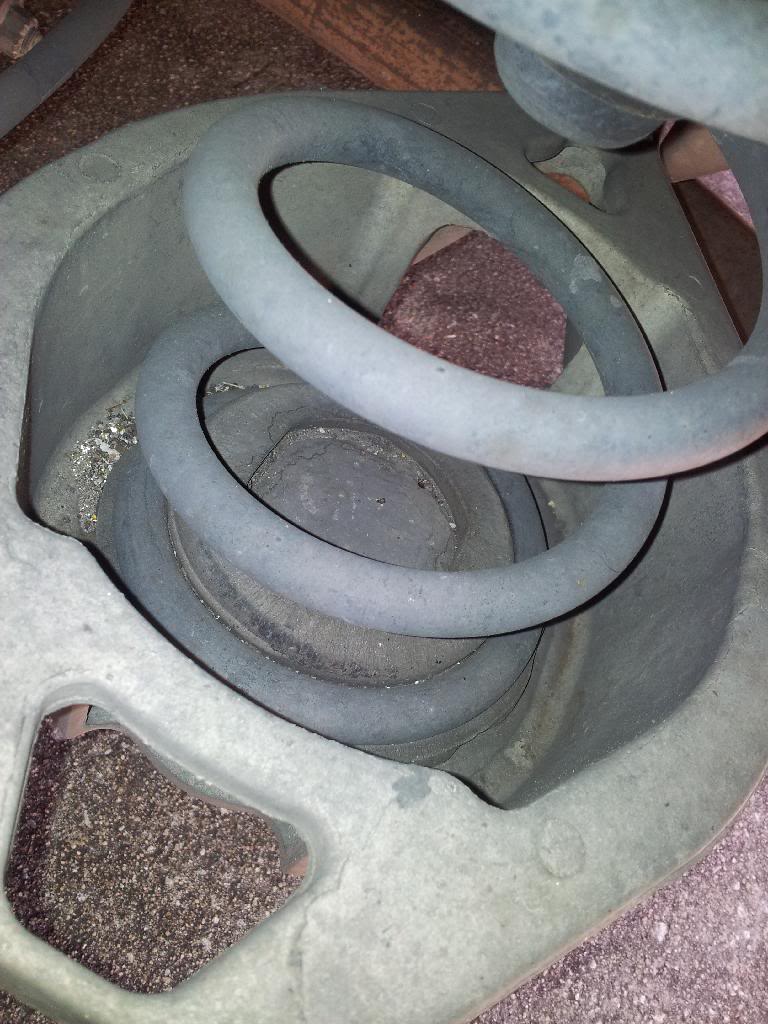

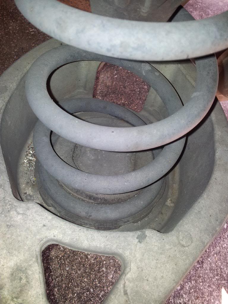

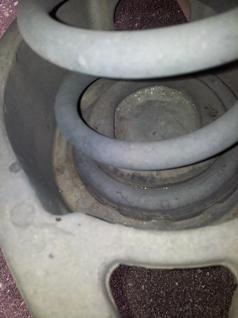

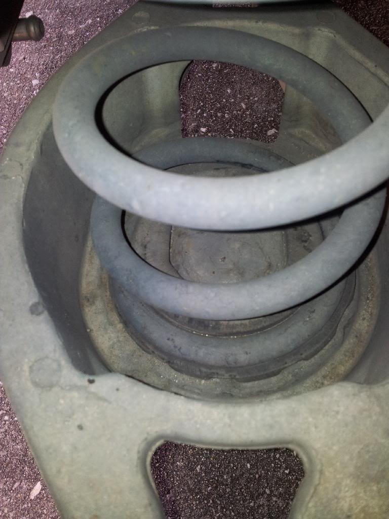

Old Mar 19, 2014 | 10:28 AM
r3dg3cko rob's Avatar
r3dg3cko rob
Joined: Jan 2014
Posts: 54
From: Orlando, Florida
Couple of shots of the right hand side - this side is ok.
These are from the left hand side - that's making the noise.
They look the same to me but I'm not 100% certain what I'm looking for tbh.
Old Mar 19, 2014 | 10:53 AM
travlee's Avatar
travlee
Master
Joined: Jul 2011
Posts: 49,725
Likes: 9,296
i would check/replace the rubber spring mount up top... to make sure they havent been altered and also make sure that the spring is seated correctly in the bucket

I just measured the distance from the top of the spring to the bucket and the left side is 1/2" shorter.
Old Mar 19, 2014 | 05:27 PM
travlee's Avatar
travlee
Master
Joined: Jul 2011
Posts: 49,725
Likes: 9,296
i would just buy some aftermarket ones and replace,..call it a day, not sure if maybe one got chopped or wore out...

Went to Firestone today as one of the tyres was leaking through the sidewall. kept pumping it up but it was going down slowly over the next 48hrs.
The guys there said a bit of beading would fix it and for $40 i figured that was a bargain but alas it was not to be the tyre spade went straight though the wall! So I now have two brand new bridgestones on the rear setting me back $400
On the upside however the guy at Firestone suggested a narrower tyre as the ones on the car sat very wide and sure enough a 275/35/19 and it's no longer rubbing!
So that's positive at least. I just need to sort out the miss-fire issue now - The previous owner thought it was an injector issue so maybe some cleaning agents in the fuel will be my next step.
Cheers for all your help!
