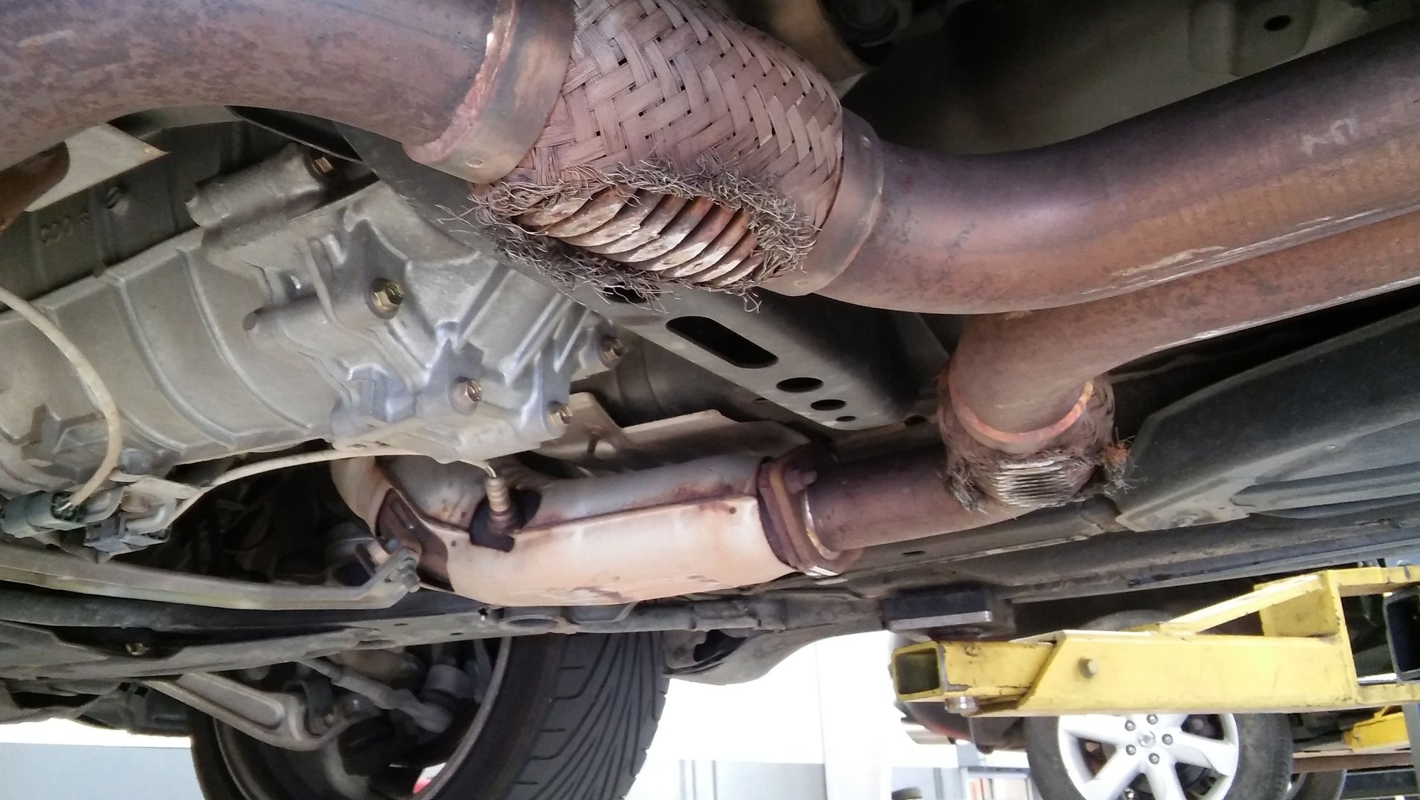

Only thing is I could not possibly drive the Z to you on this busted control arm. It will barely get to 60 mph without sounding like the car will collapse!
I may have to take you up on the clutch regardless. That is a steal!!! I was just about to order a complete kit + flywheel for almost $800 and just pay someone to put it in.
I wont even go to dealer for a keychain man!
I did put some tires on her today. My buddy runs a shop and he gets good deals on tires.
see:
This is the driver's side. The passenger side is not too far about to come loose. <br/>

Yeah that ball joint aint looking good. Not seeing where it's broken though? Did they show you or am I just missing it? Or is it literally the ball joint about to break out of its socket? (hard to imagine but possible) No problem bud, I'm a mobile mechanic, and I work well on Z's cause I had one and am currently re-doing one from the tailplate to the trunk plates, to the floor pans, to the engine and front grille. And everything in between, i know the cars top to bottom lol. Lemme know a good weekend for you and I'll see if it's an off weekend. Can also get you a hook up for those parts a helluva lot cheaper and walk you through installing one if you want so you can drive it around safely. Like I said, you got my cell # lol.
I think i have another pic but it is not even connected really. I was trying to look at and snap at the stealership. It is scary when the mechanic says he never done one before and says yeah that will be $600 to fix. HUH?

My buddy and I jacked the car up and looked and low and behold I did not need lower control arms. Just the balljoints (common) on both sides. CrossDrilled and slotted rotors/ceramic pads installed.
Changed the plugs, clutch (going in before end of week), valve cover gaskets. Other than that, that was it! Dont listen to the dumb stealerships!!

are you sure that the lower inner control arm bushing isnt blown, that may be why they stated it needed to be replaced
if it looks like this, then it is blown
