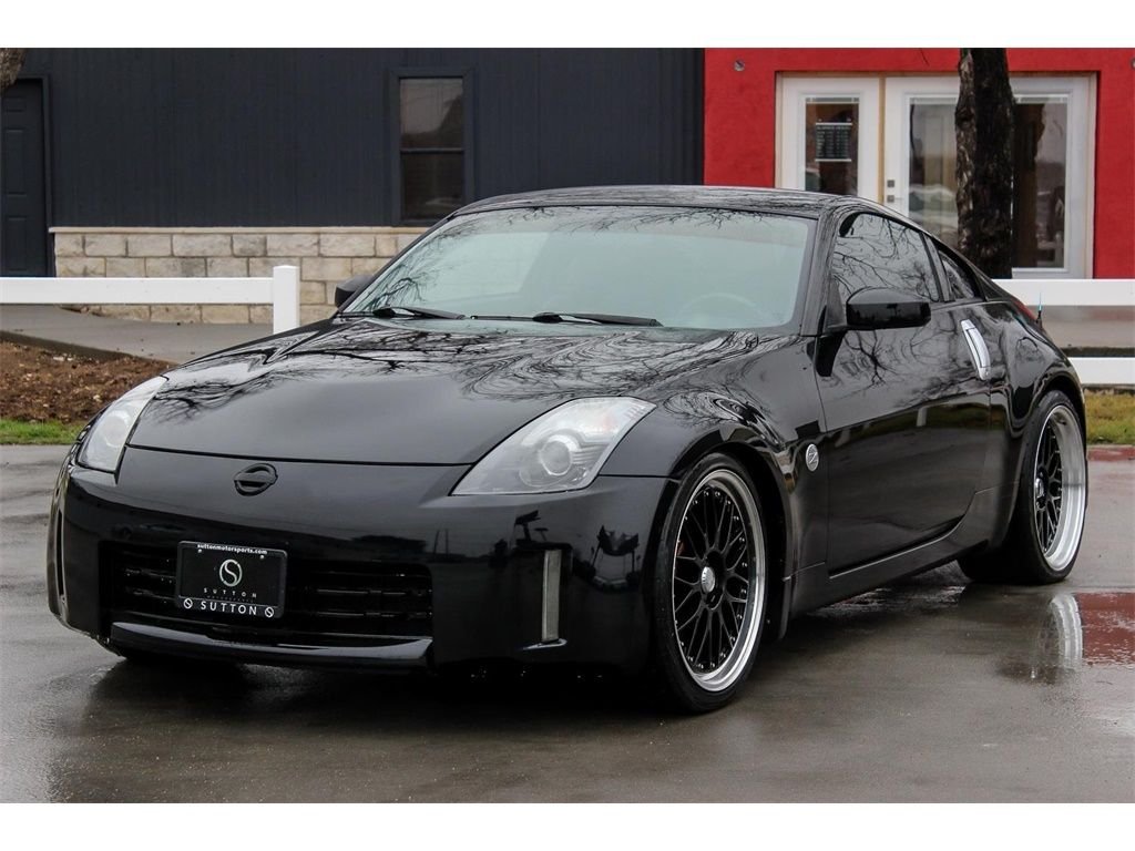

Hello, wanted to introduce myself! My name is vic .. just recently bought a 2007 350z! Also just had one question, what do ya think of me running 18x8.75 in front and 18x9.75 in rear? Just gonna be a weekend car not much of a daily! The car currently came with 20s and not much of a big fan of those lol

Hmmm, must be XXRs..... only wheels that come in quarter sizes. Acknowledged best size combos are 8.5/9.5 or 9.5/10.5 so in between works. Watch the offsets. +15 on the 8.5/9.5 to +15 or +22 on the 9.5/10.5 (or interchange). Note those are Enkei specs.... which I note for a reason.
Welcome.
