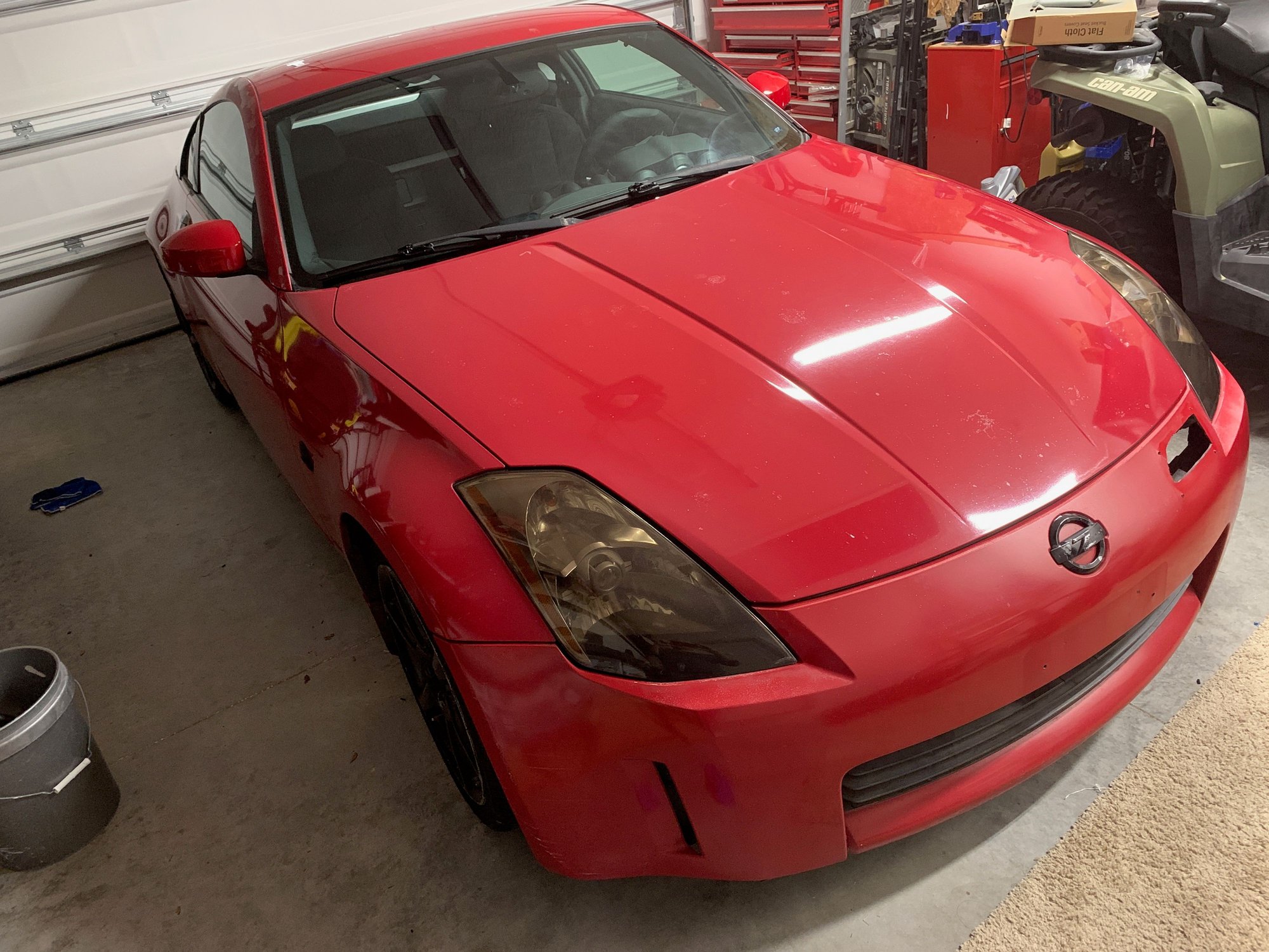

Last Sunday I took delivery of a 2003 Coupe touring, Red, with a slushbox 124K miles.
the only external "damage" is clear coat peeling, someone tried to break into it year ago and chipped a piece of plastic(<nickel sized-ish), and a couple < dime size rust bulbs.
There are a few issues to work though but nothing a DIYer can't tackle. So for a17 year old car in very good shape. Well the front bumper was off following the previous owner replacing the headlights and loosing the screws and a tear at the bottom in the lower corners of the air inlet grill area. I got the bumper before the car epoxy and a little bit of enginuity then I had the screws on standby and on receipt of the car had the bumper on in 10min. but he lost the front wheel well liners..meh those are cheap.
