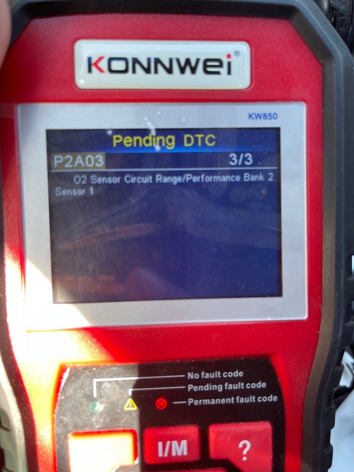

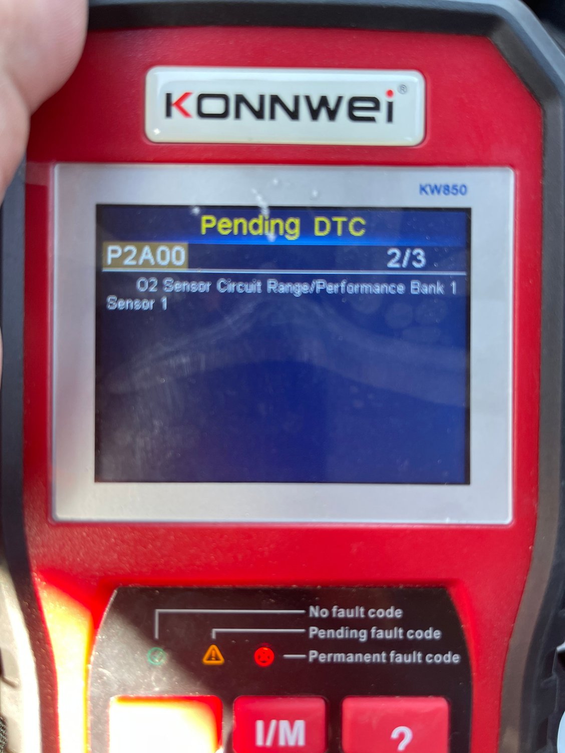

Hello I have the same issue with the p0850
park neutral switch. I replaced the thesensor but still cel goes back on.
I also have this other 2 codes pop but haven’t fix it
