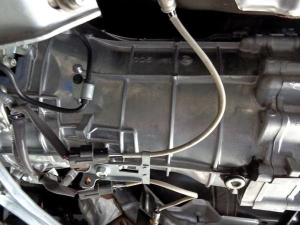

CD5? Oh, I see the confusion.... CD5 on the outside of the case is the case type. JK41 lives inside a CD5 external case. As on the case of my '08 Niz...
So it's a rebuilt trans so no fluid to start. Gottit. In any event, can't see any benefit in mixing the fluids. Probably no harm but no real point. Sounds like someone put in some MT85 to top off the box and because the trans didn't blow up, posted how "good" it was on social media and it became a "fact". Hahahaha.... You have the MT85, just use it straight.
