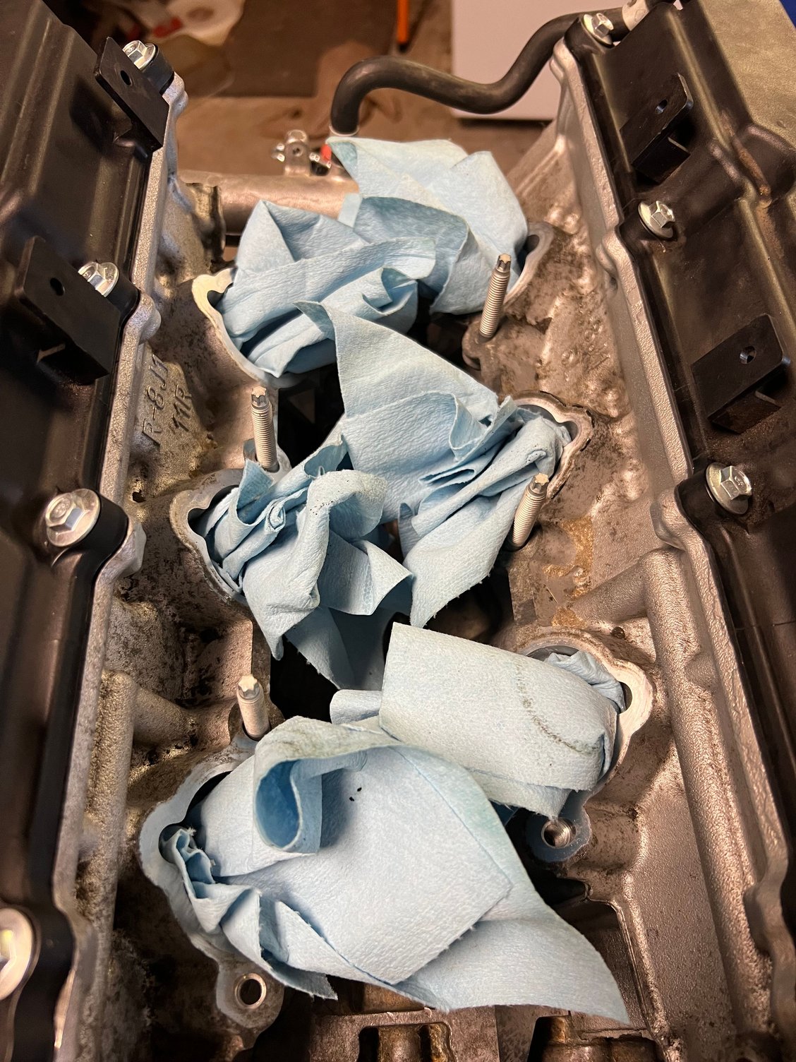

Does anyone know the torque specs for these studs, cannot find anything online about them?
Old Jul 14, 2023 | 05:50 PM
i8acobra's Avatar
i8acobra
Posts: 8,035
Likes: 1,340
From: Phoenix, AZ
They don't have a spec as they're part of the assembly. Just bottom them out, the nut tightened to spec keeps them from backing out.
Old Jul 14, 2023 | 09:07 PM
bealljk's Avatar
bealljk
Joined: Apr 2010
Posts: 6,504
Likes: 1,325
From: North Denver
Just hand tight … you will torque the nut that goes on them.

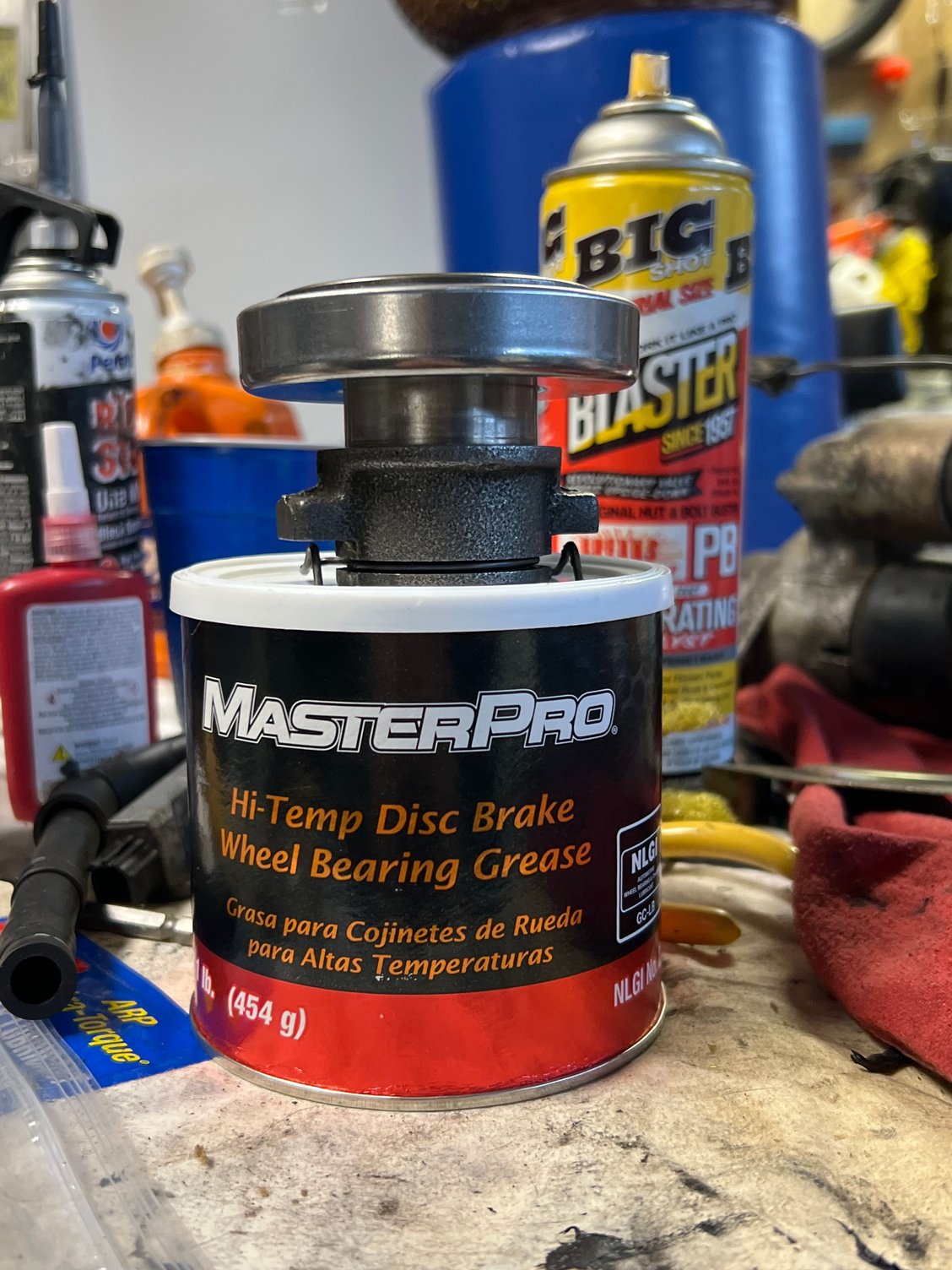

I was watching videos on how to replace this and saw them putting some sort of grease on the sleeve (just a thin coat). I was wondering if this stuff is what I should use and if adding that thin coat to the sleeve was ok?
Old Nov 25, 2023 | 08:39 PM
bealljk's Avatar
bealljk
Joined: Apr 2010
Posts: 6,504
Likes: 1,325
From: North Denver
Thats the style of grease I use - I dont overthink it…
