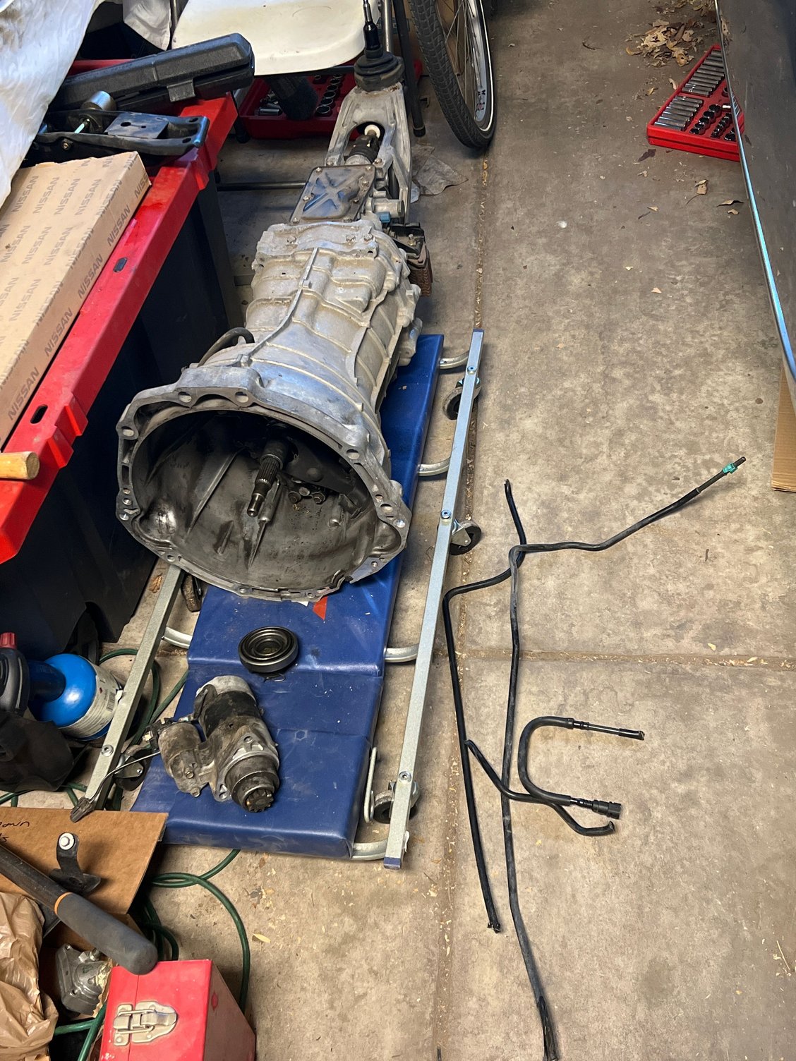

It’s been a minute since I posted the progress but as of today I got my transmission out of the car, the block is at the machine shop for a hone and decking, and my fuel line is finally out…. Though it is unusable. I’ve got my clutch and flywheel on the way and once I get that in I’ll begin the assembly and balance. She still has a long way to go, but I’m making progress!

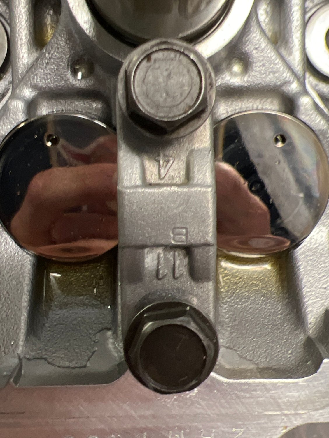

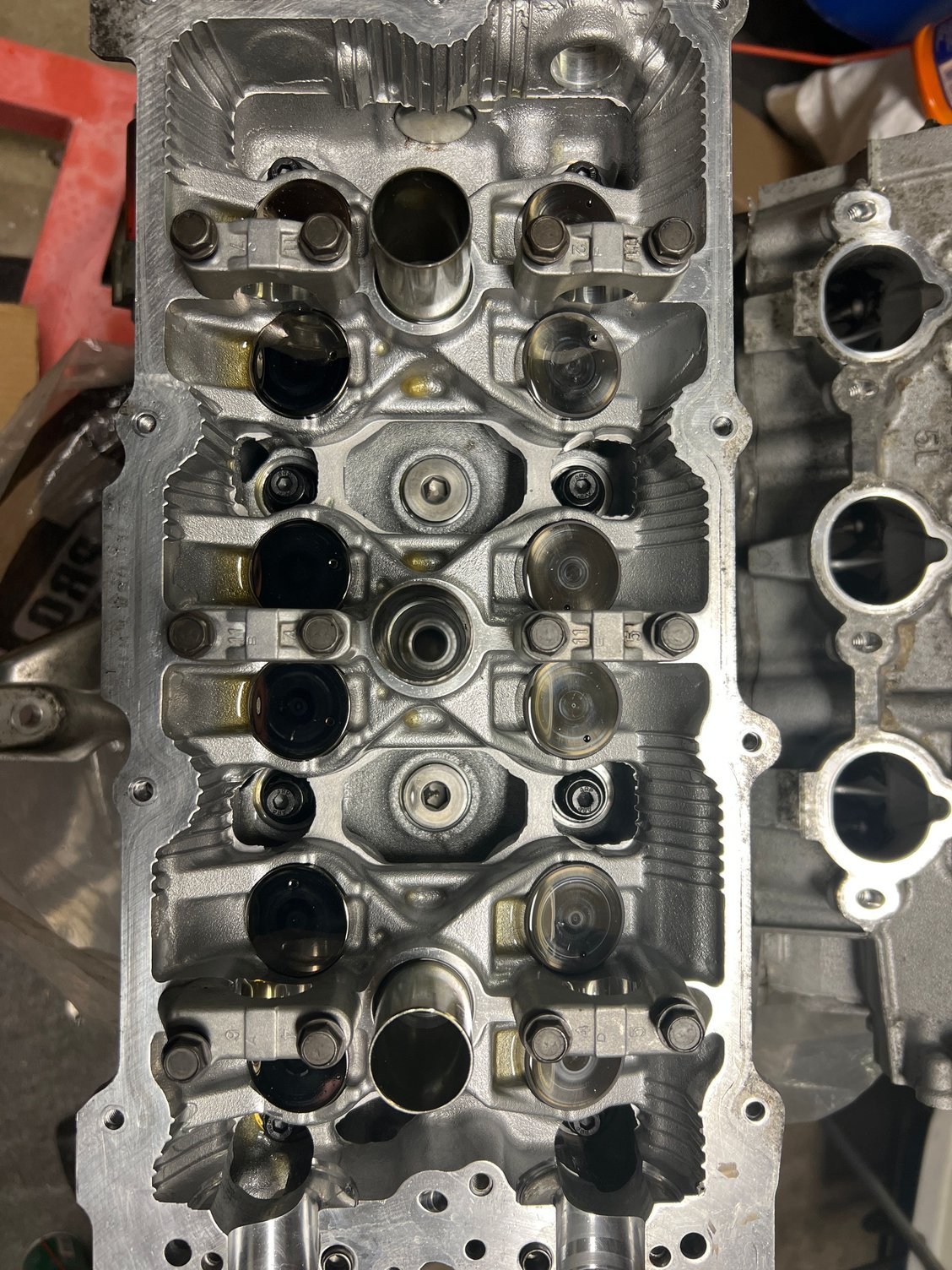

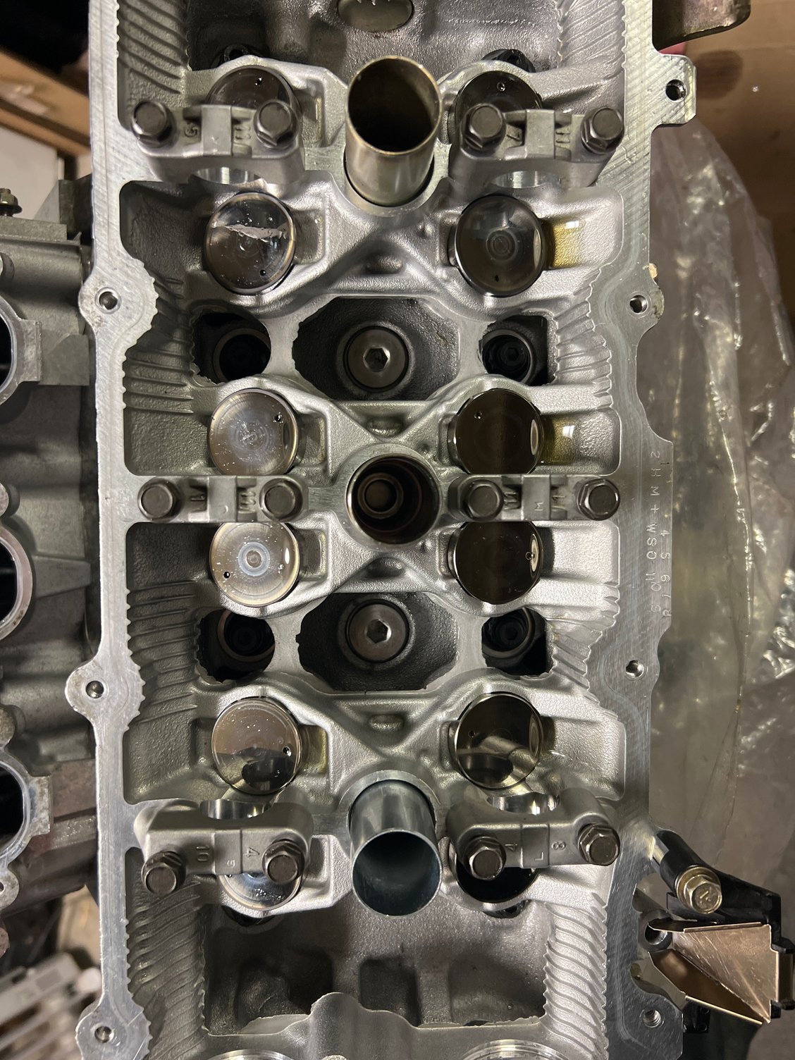

Default Cam cap position
Hey guys, I’m test fitting my cam caps with what the service manual says and had one question, does it matter where the different numbers are facing? And if so what is the order?

Nissan stamps all the cam caps with lettering a-p, which are still visible on my caps, so I should be good on that end, I’m just wondering if they’re directional or if it doesn’t matter where the numbers face

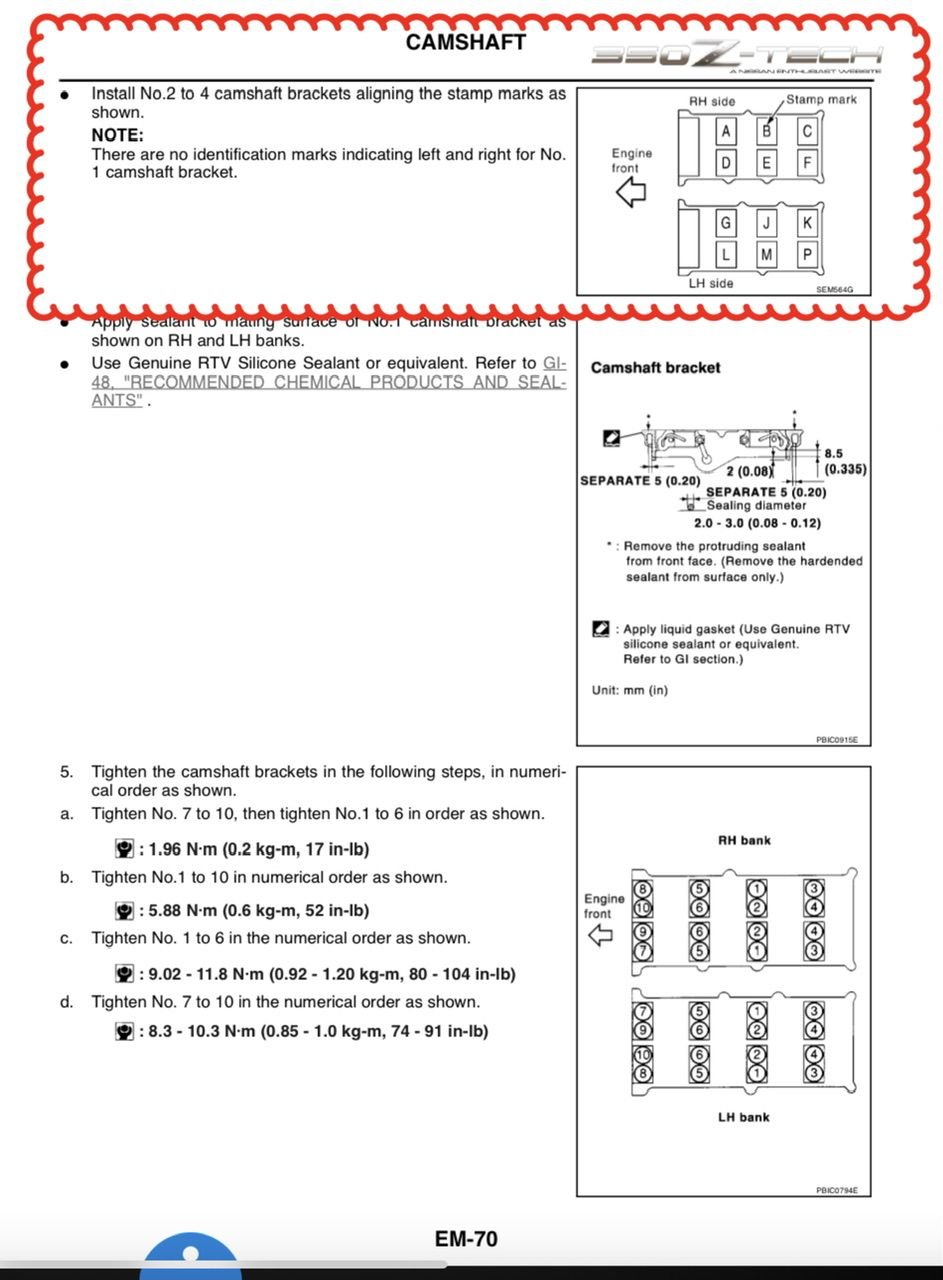

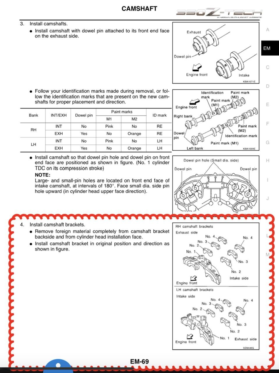

no no no - this isnt true…
Meta47 - Reference EM-69 and EM-70 in the FSM and there is a tables / diagrams which cam-cap goes where based on the stamped letter
The tricky thing will be which orientation the caps go in if they can go in top to bottom or bottom to top. Obviously the cam cap that supply oil to the cam shaft can only go in one way - what I do is I match the orientation of the letter of the respective cap to the orientation of the letter on the oil-supply-cam-cap.
Does that make sense?
