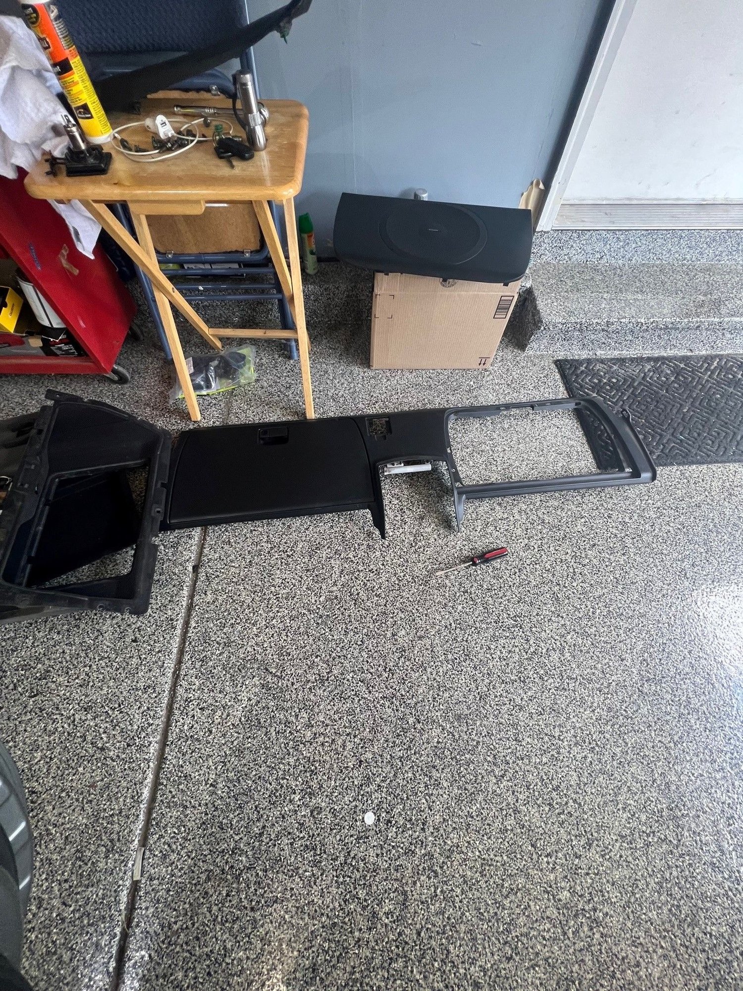

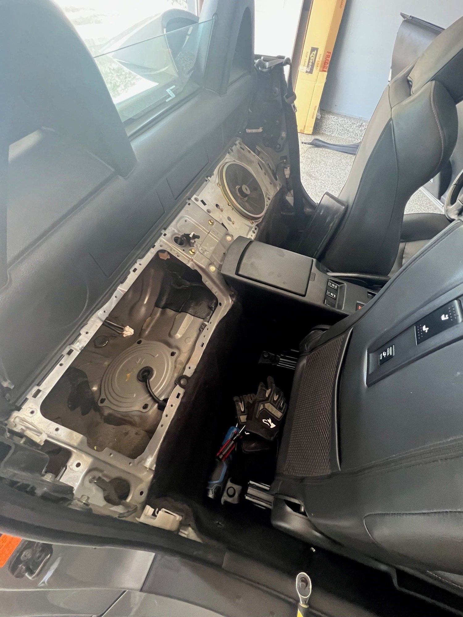

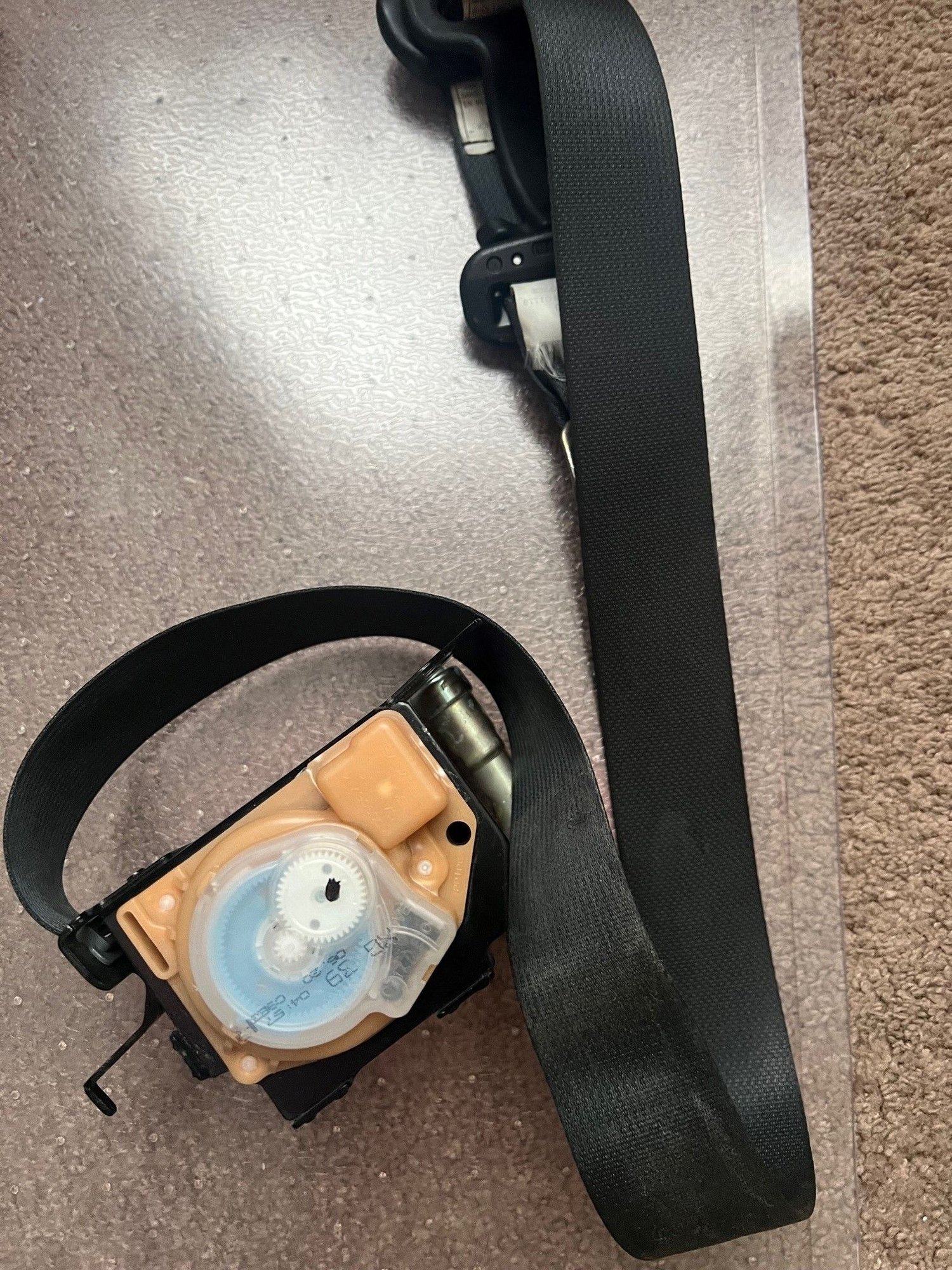

UPDATE - To date no one has road in the passenger seat and NEVER used the seat belt, well I go to use the seat belt and I cant moved the seat belt at all it wont move or extend!!! So checked online and it appears I have a BAD passenger side seat belt. If you shake it, it rattles like crazy which indicates that the retrack clips are broken because the ball bearings are not held in place anymore. Which could be why the SRS indicator light is on and SOLID. So ordered a passenger seat belt, should be here in a couple of days.
Thanks everyone!
Old Sep 5, 2023 | 09:19 AM
rdchi350z's Avatar
rdchi350z
Joined: Aug 2023
Posts: 8
From: IL
Removing panels to get to seat belt.
