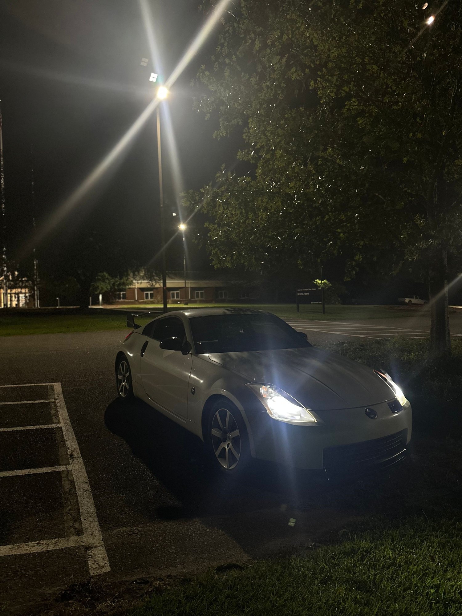

Do you have some photos to share with us of your car ?
