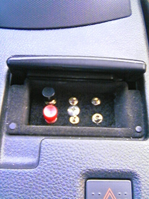

P.S. i like the pic of the switches....i also have mine in the ashtray. Easily reachable and very hidden!

thats an old pic of my ashtray. i did the same thing the first time around. i did a stealthy install. but i decided to redo the whole thing last summer and make it easily visible. plus i had to make space in the ashtray for 3 more switches for the xbox i was going to install.
this is what it looks like now.

Wow, i like it alot. I simply have my arming switch and purge button in mine. where were you hiding the bottle on your old setup? My shop and i went through a bunch of options and we decided on the space where the spare tire should be. Its worth it when people i race think im just lightly moded, but if i ever get a flat im SCREWED! May i ask what made you decide to go from the stealthy install to your current one?

a picture is worth a thousand words. the old setup didnt have the billet bracket so the bottle sat very low in the setin box i built for it. the stock carpet was enough to cover the bottle. since going with a show install i bought a billet bracket and mounted the bottle a little higher.
a lot of people frown upon nitrous as if its a sin to have. cheater juice or baby bottle, etc. garbage like that. that was the main reason for the stealth install the first time around. but i noticed that people were more interested in my nitrous setup then my buddy's SC setup, so i figured if you got it, flaunt it. lol. so when i installed the xbox, i went ahead and redid the nitrous setup and slapped on a duel purge as well.
