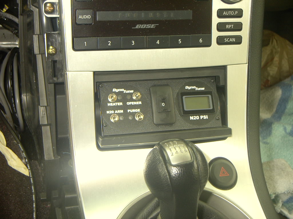

can someone give me an idea to install two gauges? the seller includes triple pod pillar. what should i fill up with extra hole?
I like the idea that charles did in his navigation pot. would it be able to fit two gauges and one more switch?

If you want stealth that's a good way. I heard that Crawfords sells this faceplate. I have a G35 and I went the stealth route. I have the switch center, Utec map switch and my Noz pressure. I just bought another ashtray to modify to hold an A/F gauge. The Noz pressure guage I only bought the guts of their square gauge that they sell. I'll just stack one above the other and have A/F in red led's and my Noz is blue. If you want any kind of pieces as per say from Dynotune, let me know and I'll see if I can get you it. Congrads on the purchase and try to keep it in a straight line.
