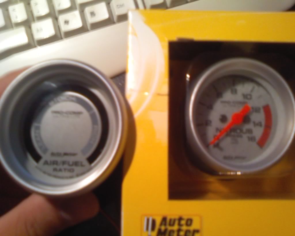

Air fuel guage & Nitrous pressure guage

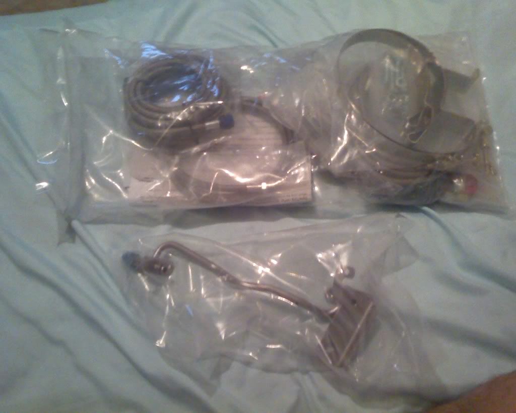

Lines, jets, solenoids, wires, fuel adaptor, etc.

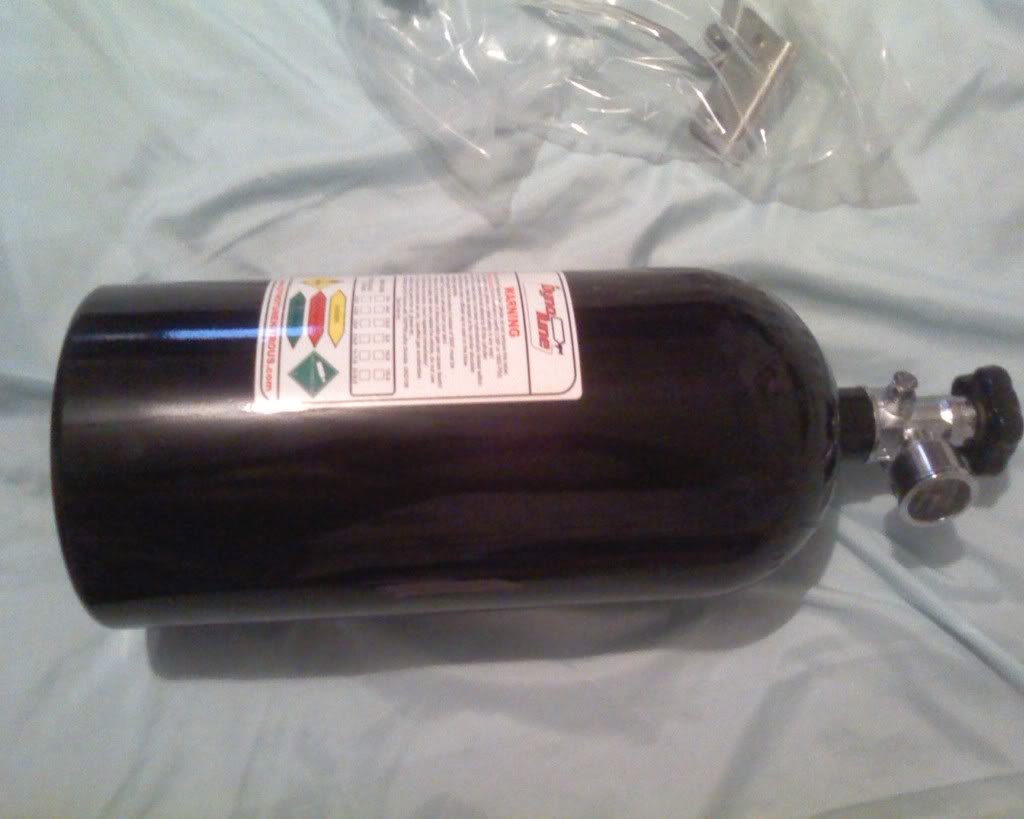

El bottle

interesting fuel adapter, can you take a pic out of the bag?
Also, sell the A/F meter, narrow bands don't do anything

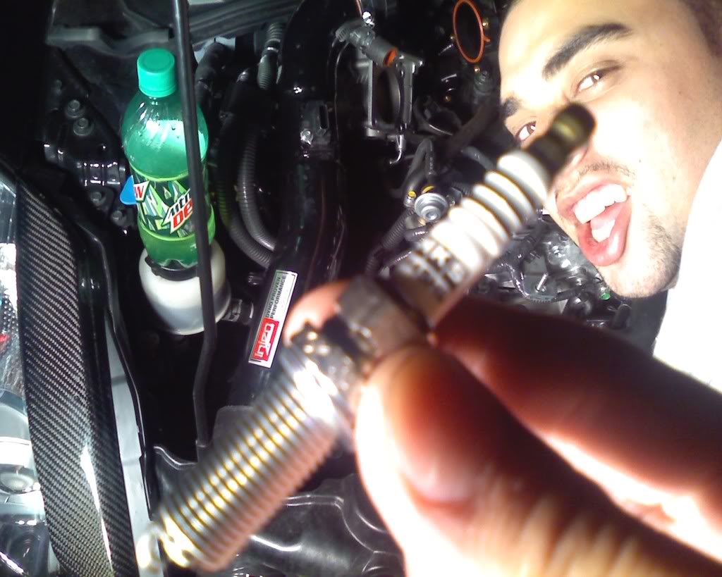

Just put the 2 step colder plugs in today, it runs completely fine, no poor idle or anything. No noticeable difference in performance either. Here's a simple pic of the plug, lol. Its an HKS plug made by NGK.

Hope you checked to make sure they were the same dimensions as your stock plugs (thread reach etc) Did you regap them or check to make sure all 6 had the same gap?
