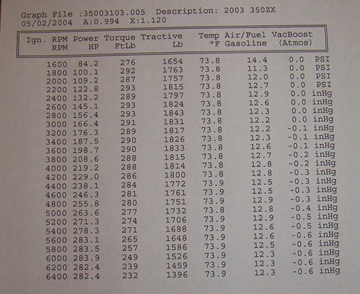

here is a slip with 55 jets from a zex kit, a/f ratios are almost identical to stock motor a/f ratios...........no plugs just nos at 55

What are the A/F ratios on a stock 350z?
Old Feb 21, 2004 | 08:49 PM
fluidz's Avatar
fluidz
Posts: 794
From: Vortechville,CA
well they all vary, i was told by one person that my a/f ratios are the lowest he has seen on a stock motor at 6,200 rpm, ive seen some vary from mine as low as 11.8 at 6,200 rpm to 13.2 at 6,200 rpm on other cars............if you go with nos, you must dyno if your gonna go higher than 55 jets in my opinion to be safe, just my 2 cents

I've seen N/A stock go all the way up to 14.
