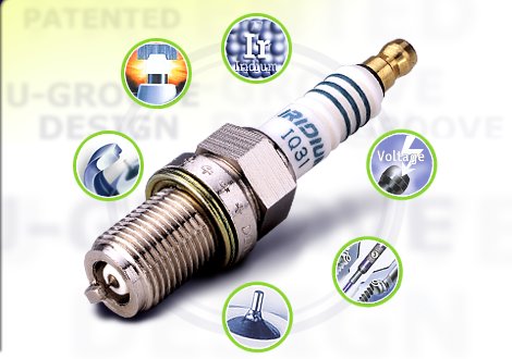

Originally posted by LaPuLaPu
(snip)It is best to use a non-projected type plug. Projected plugs allow a greater portion of the electrode to be exposed to combustion gases and possibly cause pre-ignition.
Anyone know of a non-projected electrode plug for the ZQ35? I assume they mean the ground electrode (the one that is adjusted for gapping) and not the center electrode. The Iridium looks like it's projected (see pic).
