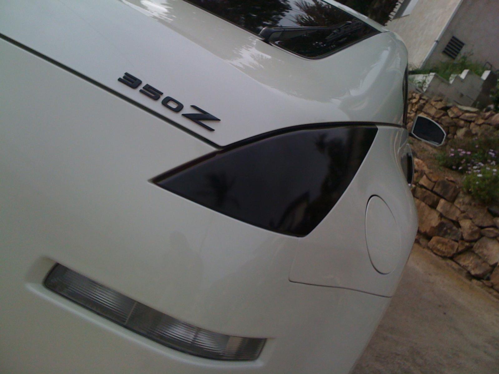

google VHT Niteshade translucent paint and do it yourself!!! Its really easy, but you have to be careful because the paint is REALLY thin.... I wouldnt go more than 3 coats on any of ur lights especially the headlights..my tails have 5 coats and thats only because a fly did a swan dive into my 3rd coat so i had to sand and do 2 more coats... i dont have the headlights done because i like to see where im goin at night any questions or tips let me know, i did my RX8s too so im a semi-professional rookie at it!

I have a PPW and had my tails painted by a local guy. He mixes black paint with clear and gets a nice darker shade to them. Looks really good. I didn't get them too dark, but it's definitely different than the original red tails.
