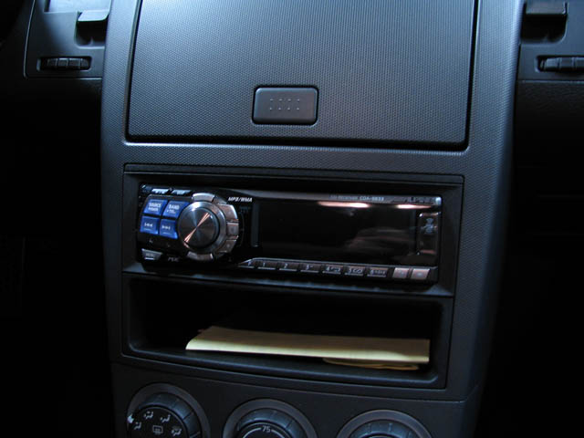

Head Unit: Alpine CDA-9833 (already installed)
Alpine iPod Adaptor + 20GB iPod (new install)

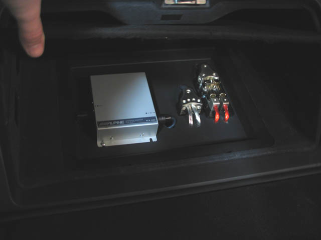

4AWG Power / Ground Wire + distro blocks (new install)

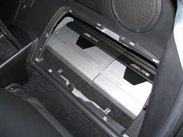

custom "amp rack" in space behind drivers seat (new install)
mounted Alpine MRV-F340 (front stage) & MRV-T320 (sub amp)

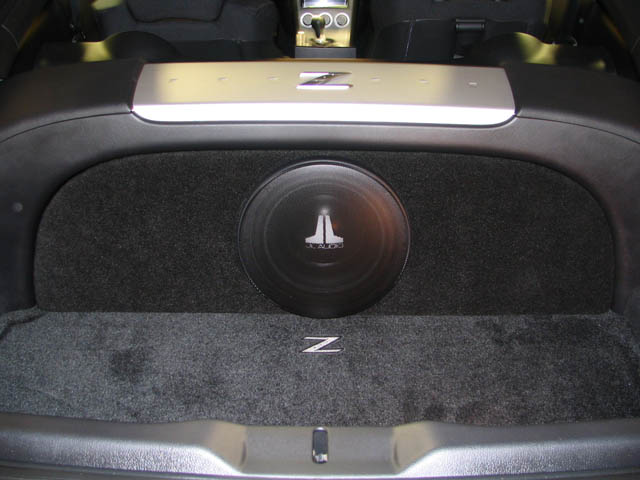

JL Audio 10w3 in under strut tower box (already installed)

Very clean install....
Thanks for the pic on the dist block.... I think it's time I mount my block nice and neat.

Wow, looks great, Dan. The amp rack is pretty dope!~ Ya baller!

Nice setup man. Quick question though... of the two dist blocks in that pic, one is fused, right? Bc I'm looking at a similar setup and thought the in-line fuse holder near the battery would be all the fuse protection I needed. Is this other block fused to protect the head unit or something?

The fuse block in the glove box is to offer seperate protection for each individual amp. The fuse near the battery terminal is one large fuse (I have a 100 AMP) and each of the smaller fuses is a 50 AMP, based on maximum current draw for each amp. This way, if something feeds back through the circuit, it should stop before hitting the amp.
Sort of like, being extra careful.

Yeah, the whole install was done by me, in my garage. The only thing pre-fab'd was the sub box, and though I could have made one, saved me a lot of extra time.

Right, I see. But don't the alpines have built in fuses to protect them? Just wondering bc I've got similar ones w/fuses built in..
