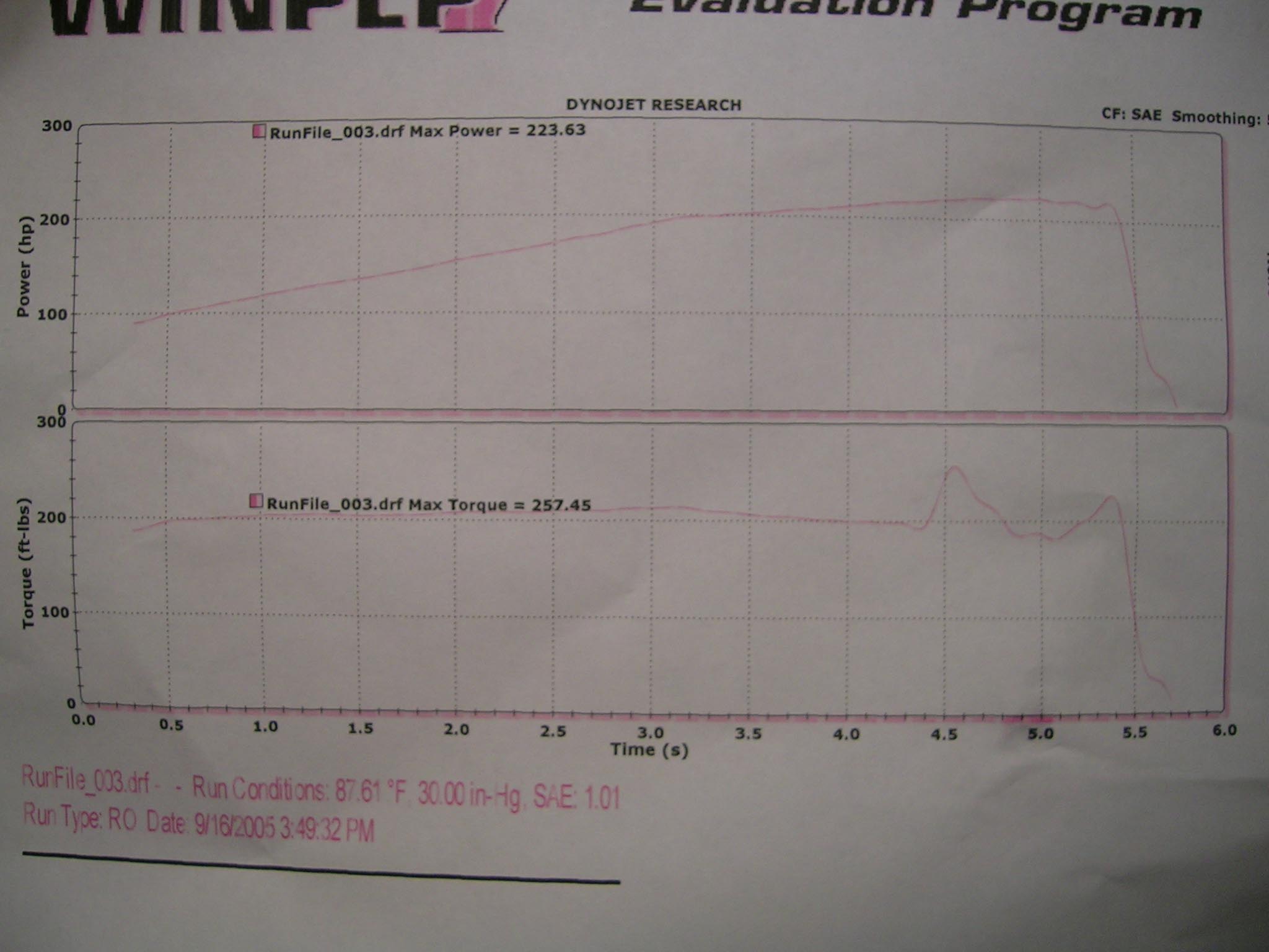

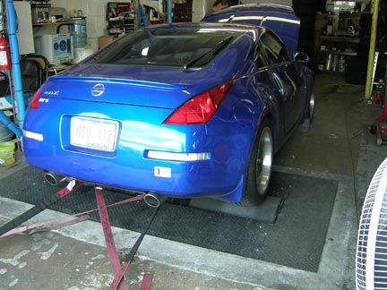

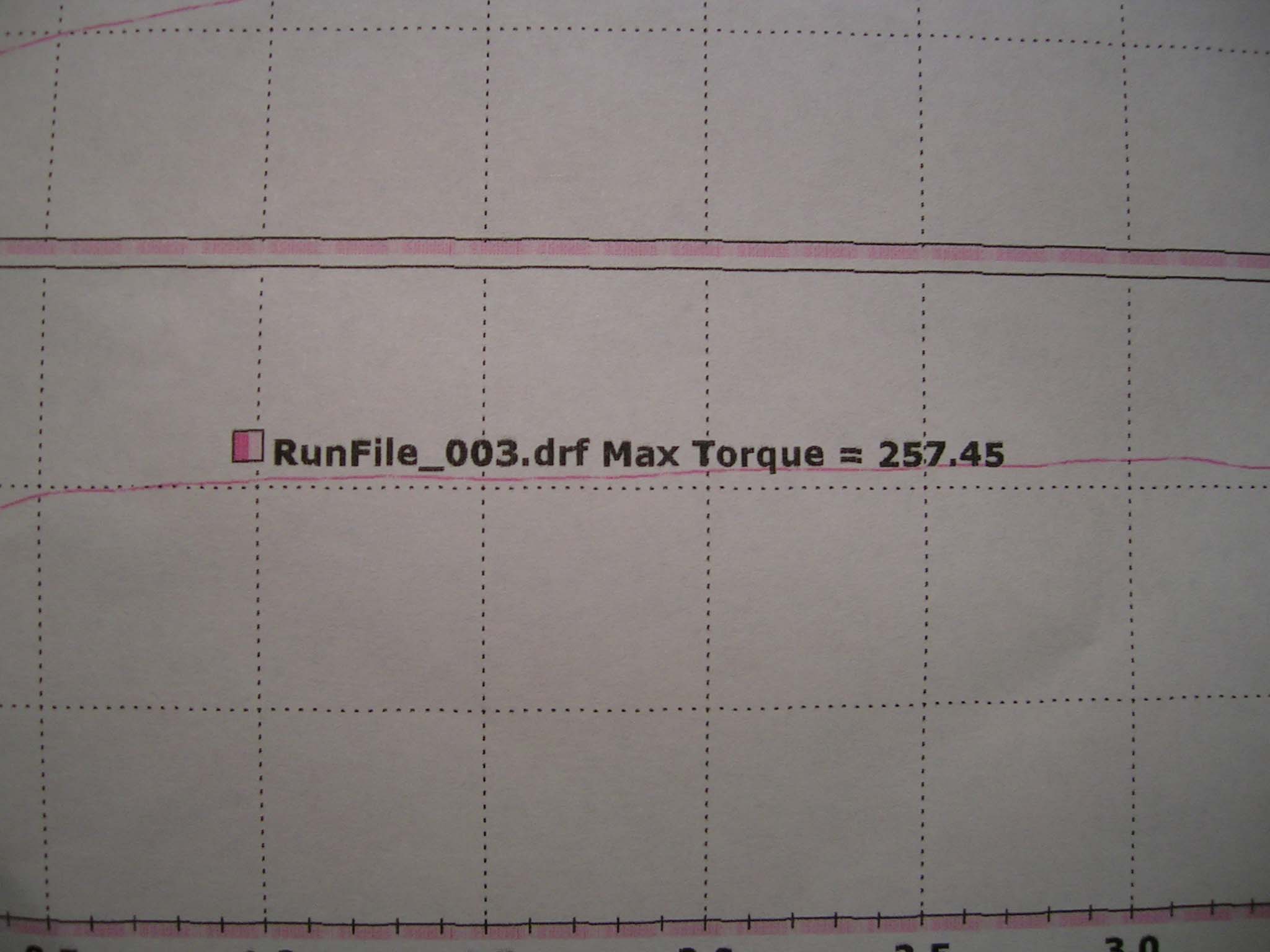

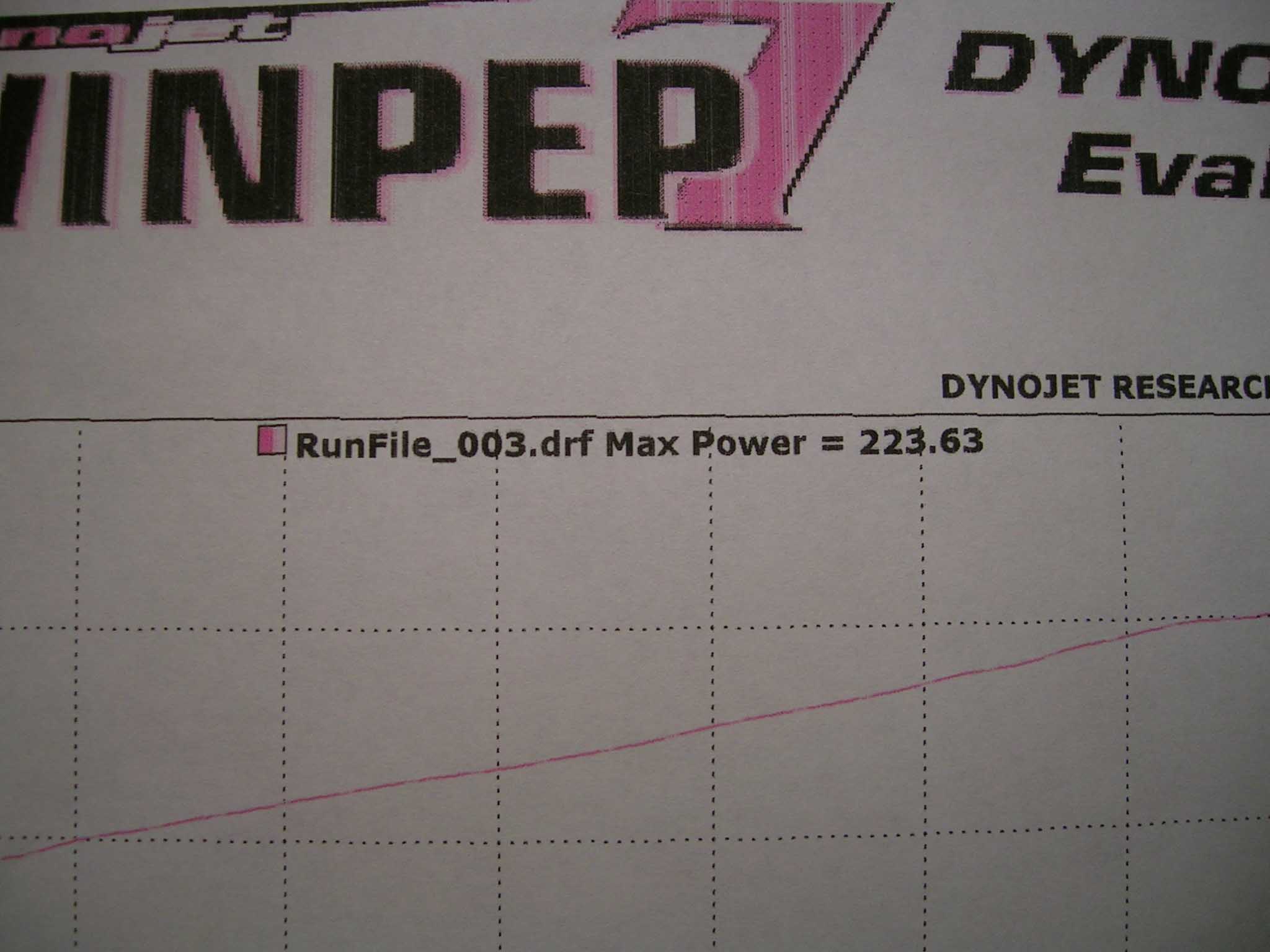

Ok just got back from Hypersport. Got a good baseline but realy odd.
223.5 WHP 257.6WTQ.
How in the hell is that possible? the TQ was flat with a slight slop towards the end then rises quickely to 257.6. One thing that threw off the results alittle. The guy in the seat never dynoed a Z before. My shift light was set to 5500 so at that point he let off the throttle thinking it was a bad light.
I didn't notice it until I was looking at the results.
The peak at 257.6 was not realy an anomoly. between each run the readjusted the clips to get diffrent readings to see where the best continuity. Always at the top end was that peak of TQ.
Got the dyno graph in the car, too lazy to go back down and get it. Took picks of the set up of the dyno and vids of all the runs. so let me figure how to put them on.
Soon I'll do a gheto scan and post the dyno on the page.
223.5 WHP 257.6WTQ.

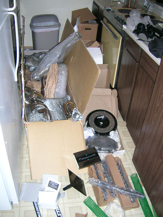

so here is the video, a good pic of the set up and my personal auto parts wear house. AKA my kitchen.
Edit cant seem to get the video on. How do I do that?
ooooh...nice pile of goodies in your "warehouse"!!! I've never posted a video on here before, but I believe you'd have to upload it to a hosting site like streetfire.net and then post the hyperlink. can't wait to see it.

You can cleary see were the guy in the seat let off the throttle, before 5500 the gas was let up.

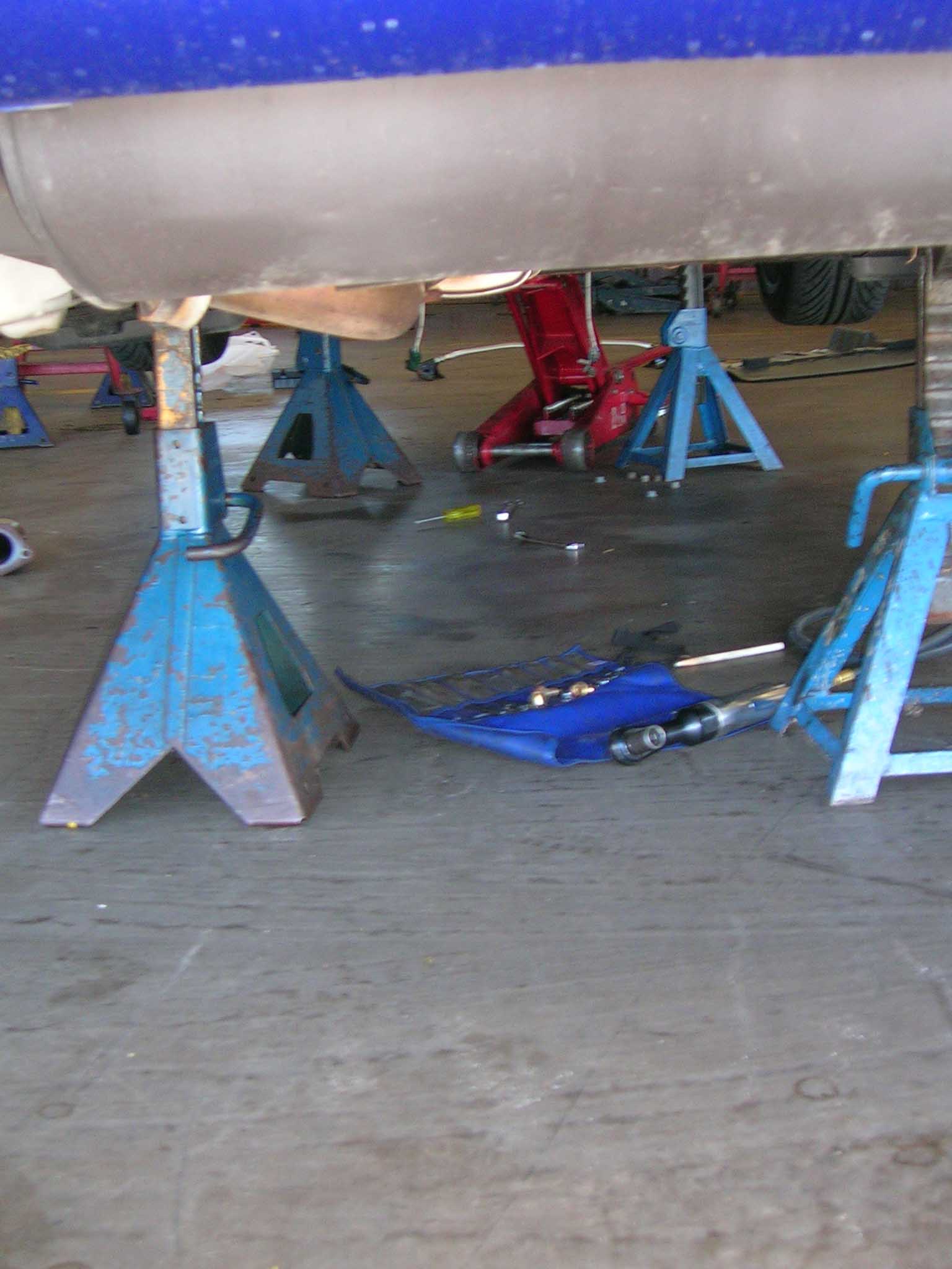

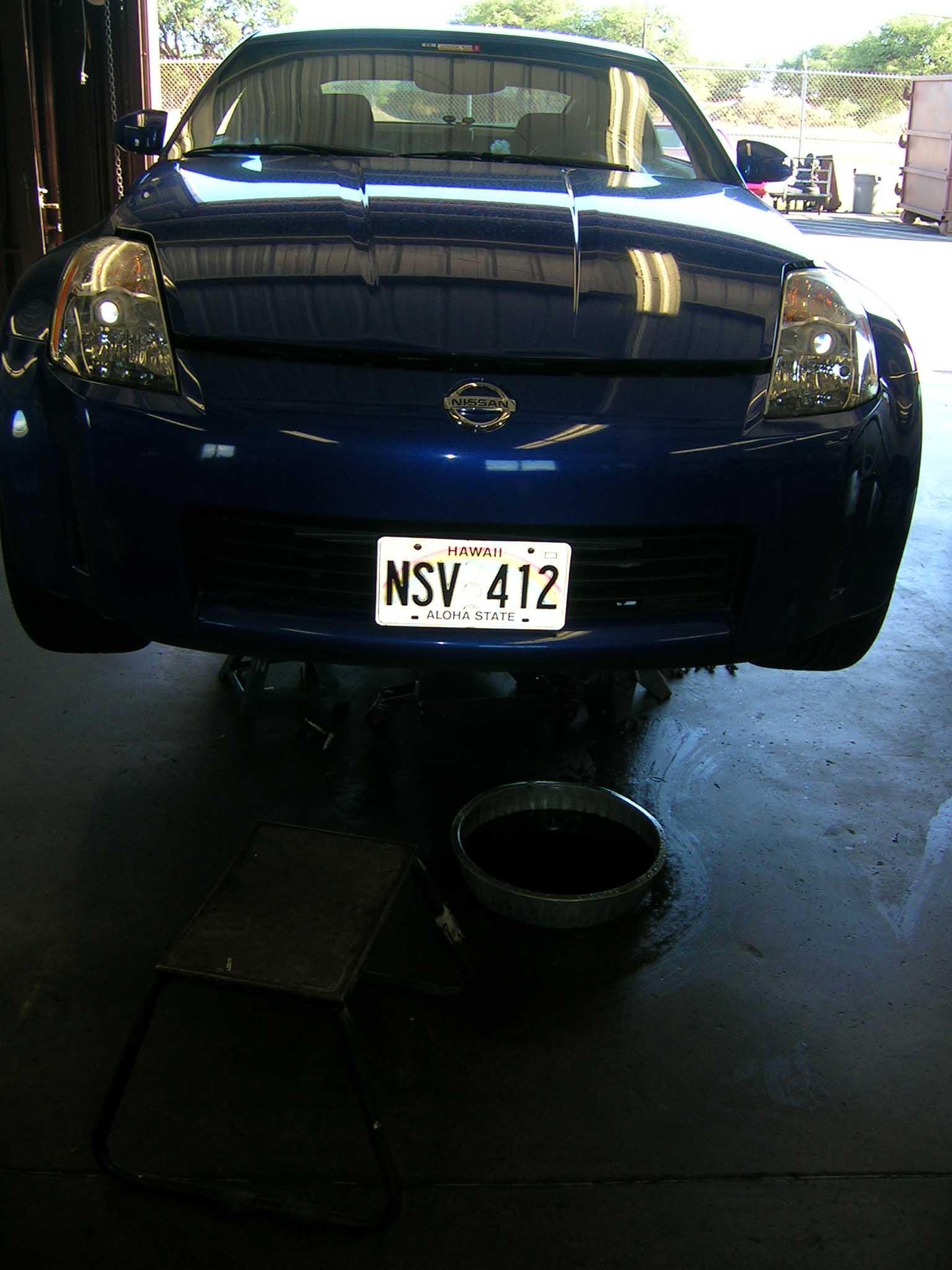

So yeah first day was a pain in the ***. Had to wait for most of the 1/2" drives and air tools. Once I finaly got all the bolt out of the tranny, went to pull it and it wouldn't move. Tried shaking it, rocking it rotating it, pulling. Basicly every thing short of peating the p!ss out of it. 2.5 hours I dicked with it and said screw it, I'll try tomorrow.
Actualy at that point it was 2pm and I couldn't hold my arms up any more. They had said I was able to do the work on a lift but when I got there I was told I had to use a stall. Sucks ****! so I went to pulling the heads. I got as far as the right bank heter hoses removed and the said we had to stop and clean up. They friggin close at 4pm on the weekends. Every other hobby shop I've been too stayed open until 8pm on weekends.
The only real thing I got accomplished today 100% was removing the pre cat and cats, and moving the O2 sensors to the test pipes. every thing else was left in shambles.

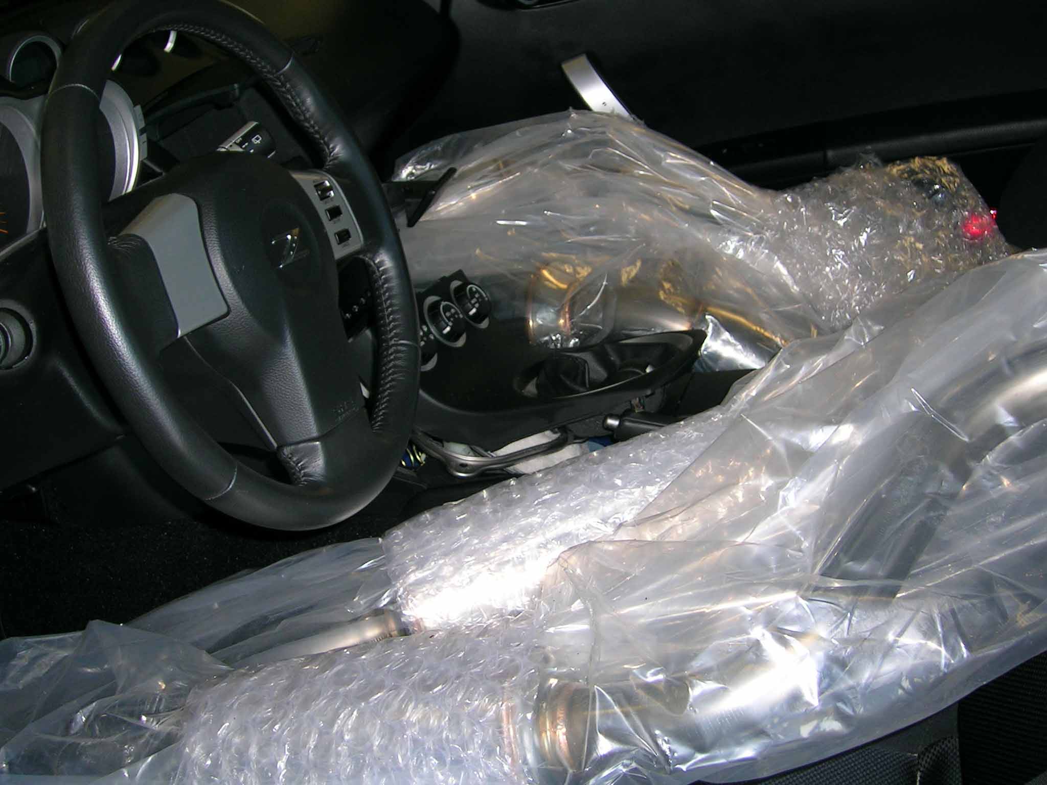

So here's how she was left, techinaly the exhaust, cams and fly wheel are IN the car. But not how I was wanting them to be.
Notice the distinck lack of tranny on the lower portion. That jack you see in the rear pic is holding up the unbolted tranny.
