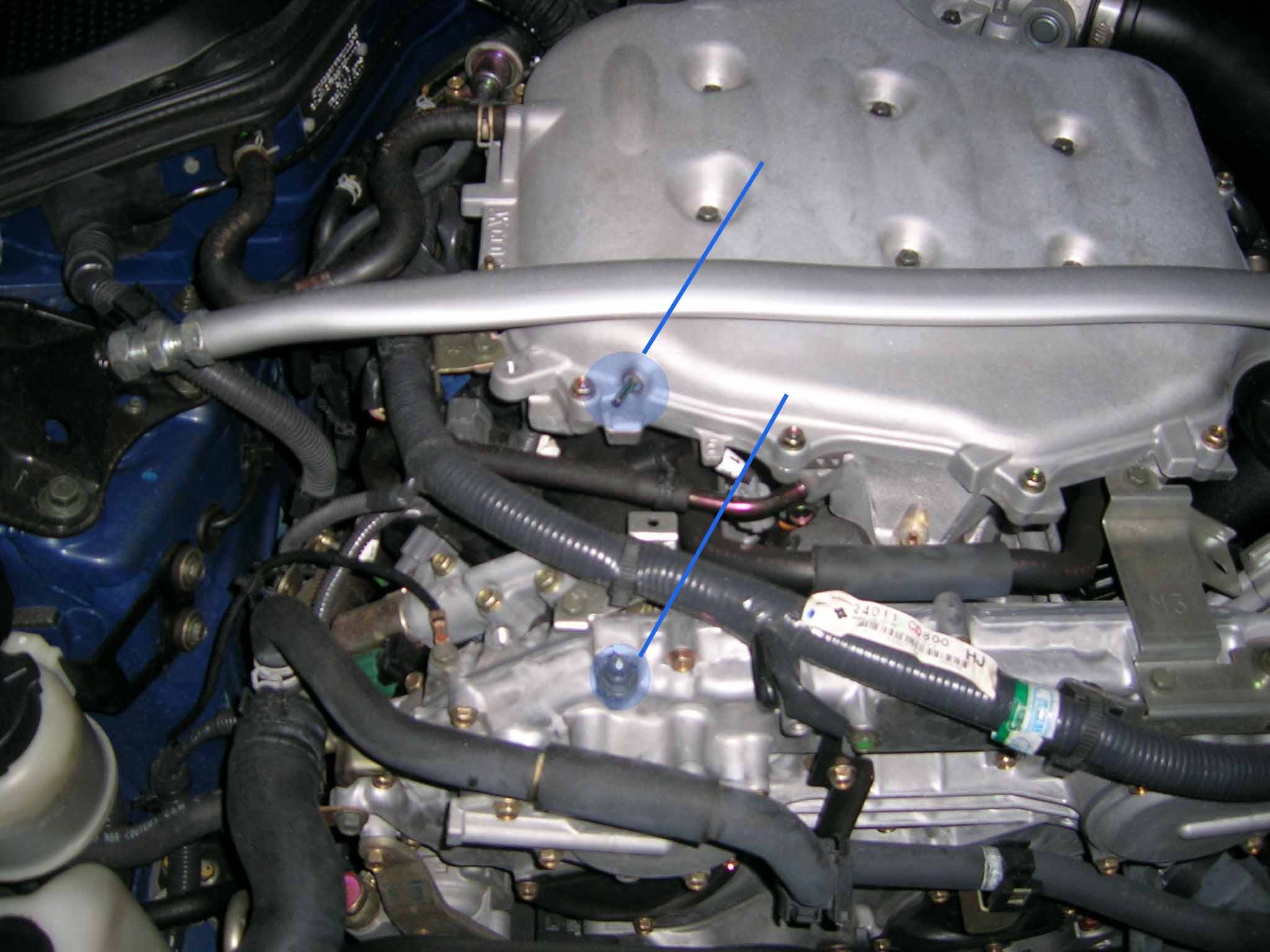

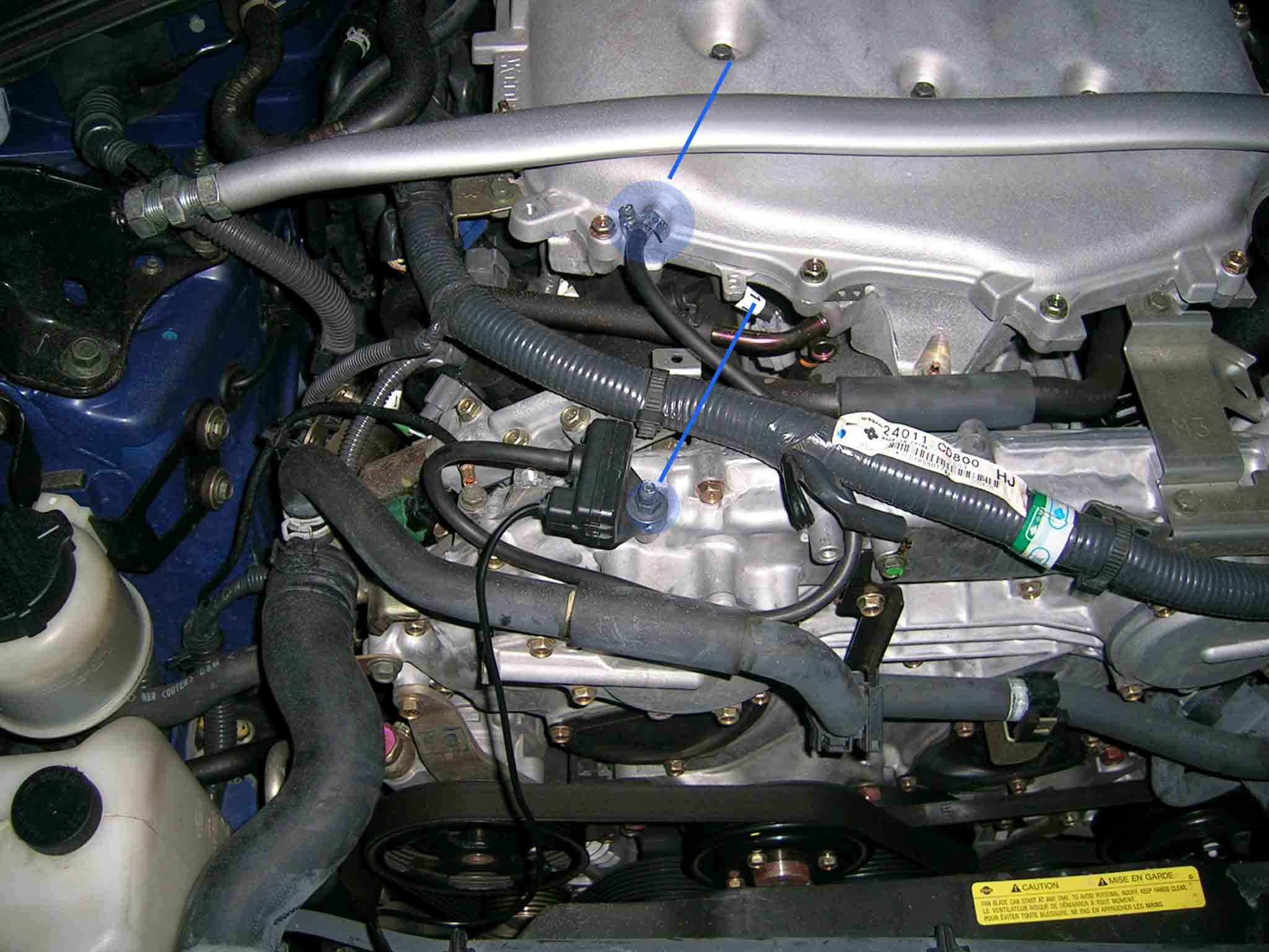

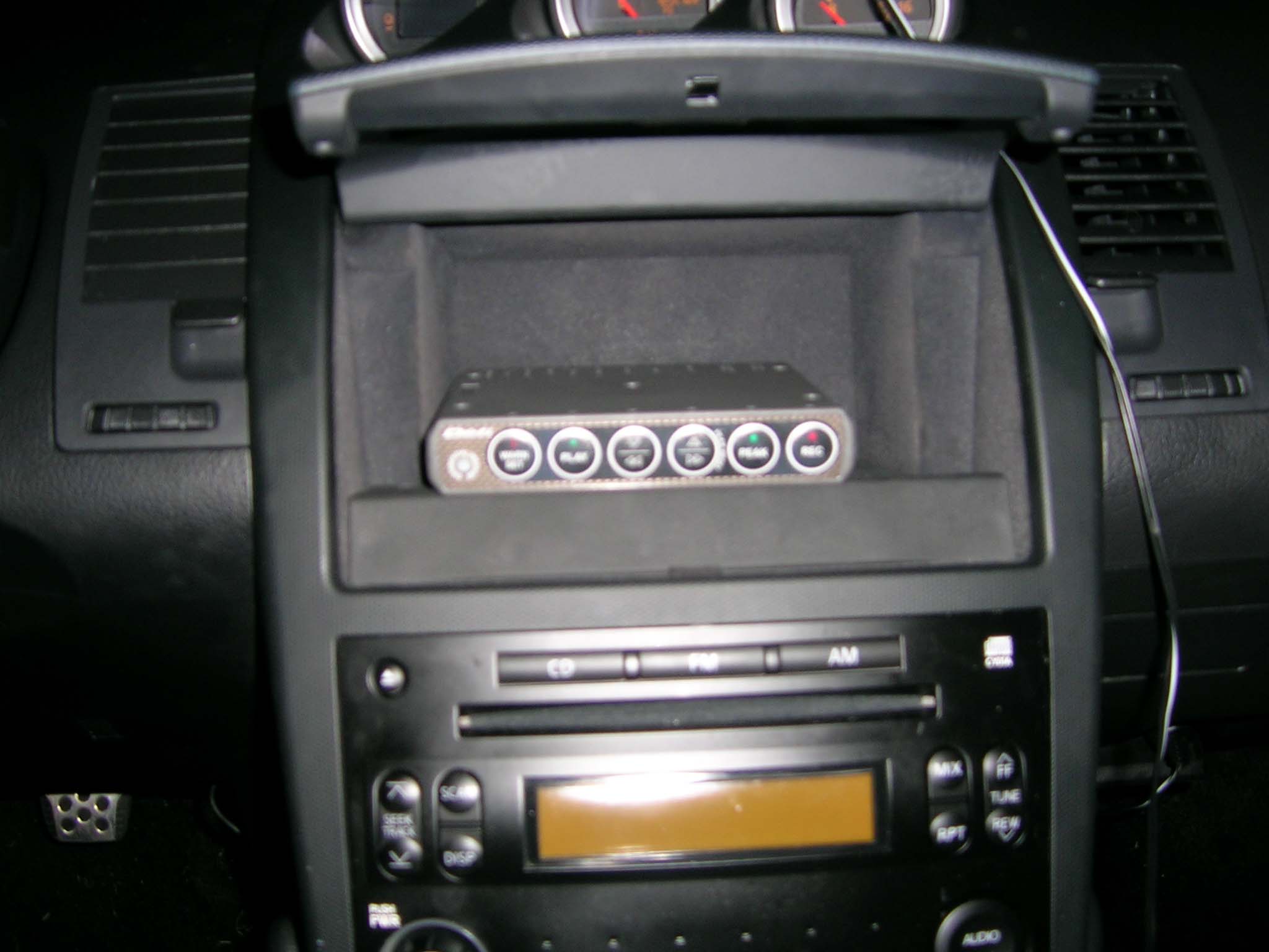

So I finally got off my lazy ****, again, and installed the head unit sans power.
In the front of our plenum there is a pressure nipple that is on the passanger side. Remove that, slip a hose clamp on your hose for the pressure sensor, tighten it down.
If you still have your engine cover remove it. If you dont use the stud on passanger side and tighten down. Run the wire through the battery box and bulk head the same way as running the AF guage wire. run the wire under the dash and up through the radio pannel into the back of the glove box. Run it through the back hole, on the left in the glove box. Run the power and signal wire throught the hole on the right and out the left side of the console section.
Tomorrow I will wire for power and hook up the guage. The same way as I did the AF guage. Getting the 12v constant from console harness, 12 ignition trying from the radio. Thats if I can get that dam panel off thats arround the radia. REALLY A PAIN IN THE a$$...

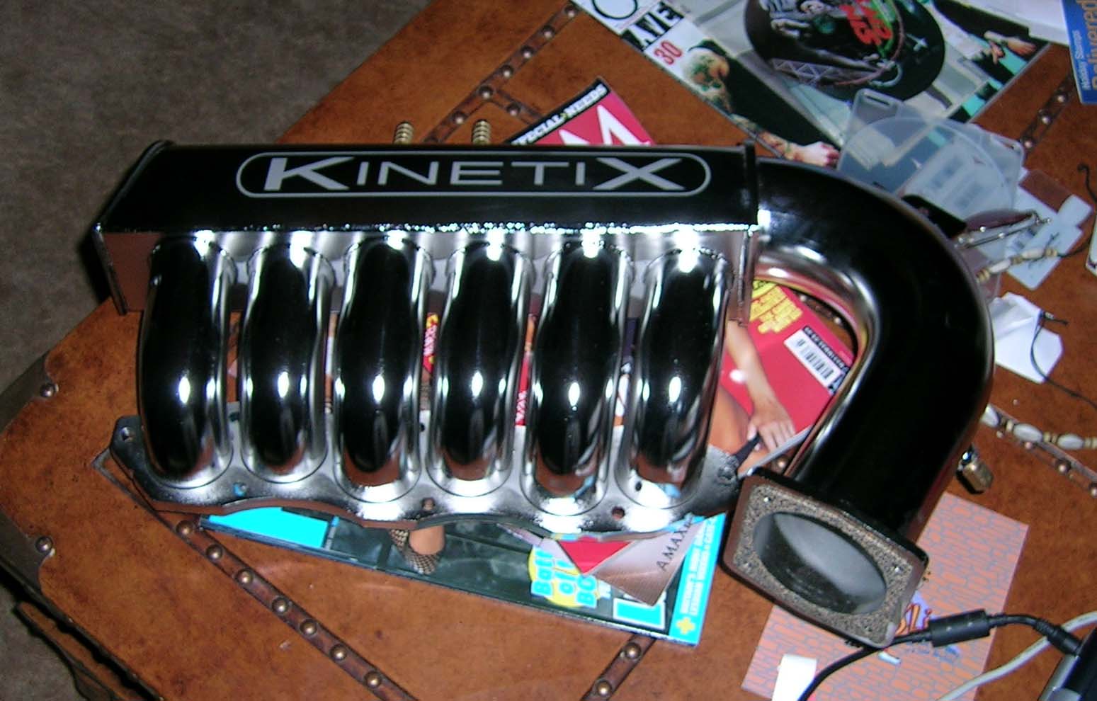

Default Me So Horn-e
My Intake manifold came in. Cant do anything with out a fule pump though. Going on a business trip monday. So my other stuff will probably come in next week while I'm gone.
