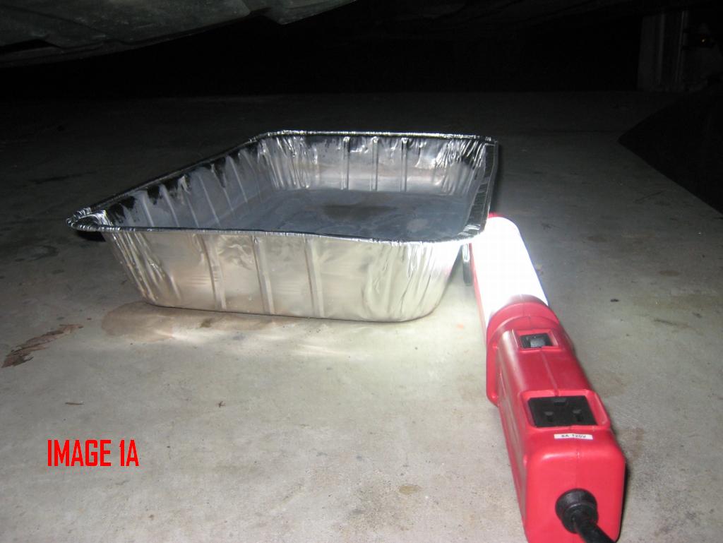

* If you are doing this at night, you will need a work light. (Image 1A)

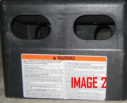

STEP 1: REMOVE UNDERBODY DIFFUSER. Some people do this without removing it, I suggest otherwise unless you like oil spilling onto it and clean up more than you have to. The diffuser is very easy to remove, although somewhat annoying because of the 14 bolts. Basically, you want to follow the 10mm bolts around the diffuser til you get all of them off- they should be on snug. (Refer to image 4, 5)

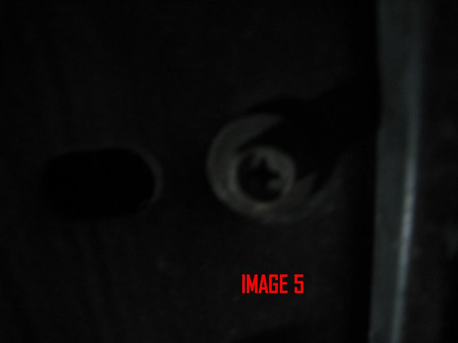

STEP 2: REMOVE DRAIN PLUG. Alright now that you have the diffuser off, you should be able to see everything underneath. Remove the oil cap on your motor before draining oil. You will see the drain plug pretty much directly underneath the filter. Get the oil catch pan ready. Use a 14mm socket to remove this. Once out, you will see a majestic stream of dirty grimy oil come flying out. This will take a few minutes, thankfully my VQ isnt burning oil so I saw most of my oil come back out haha (Refer to image 3)

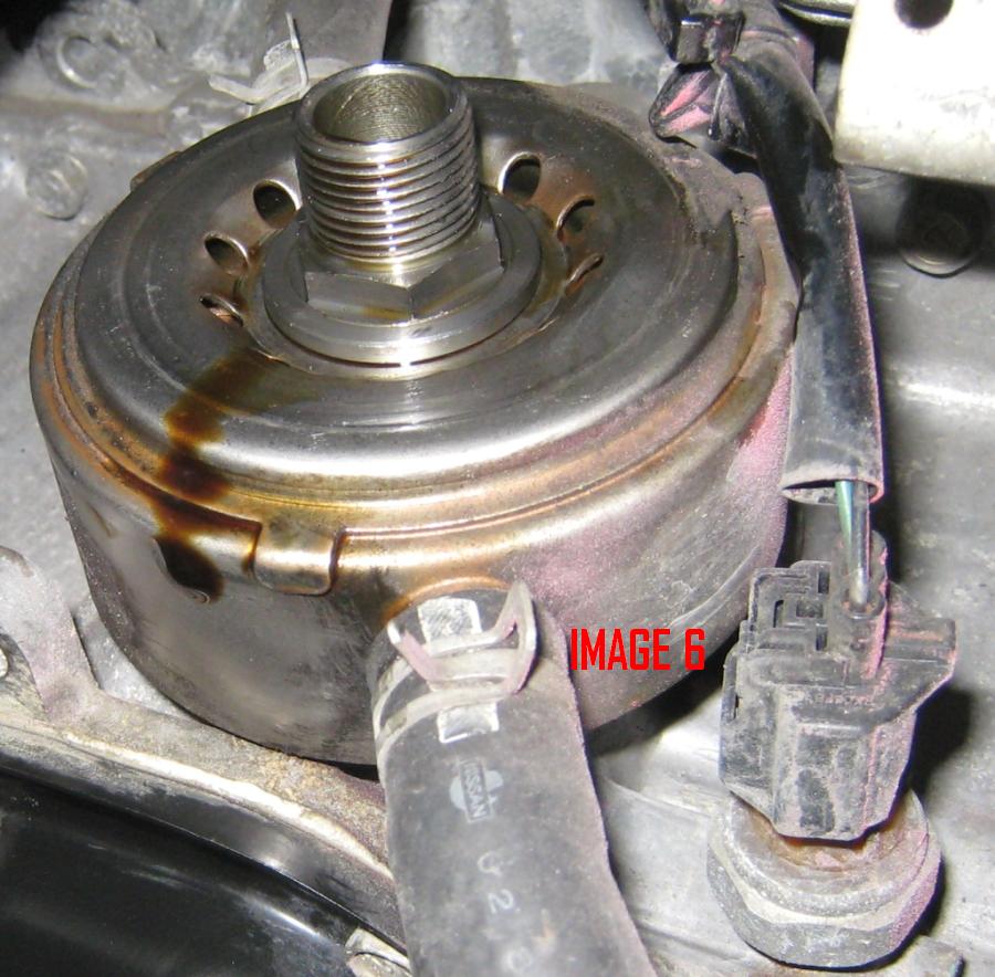

STEP 3: REMOVE OIL FILTER. Once you get the drain plug out, you can loosen the oil filter by using the oil filter removal tool. If you are using the adjustable one, just get it tight around the filter and slowly loosen it. There will be some oil coming out, so keep the oil catch pan next to you. Once all this is drained out, you are ready to put the drain plug back in. (refer to image 6)

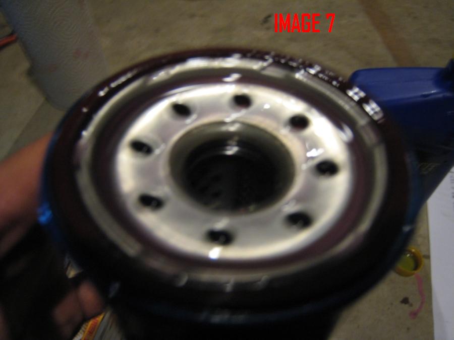

STEP 4: INSTALL DRAIN PLUG AND NEW FILTER. Get the new copper gasket/washer contraption, use 14mm socket to get the plug back on snug, DO NOT OVERTIGHTEN the bolt. LUBE the new filter around the gasket with some fresh oil. Put the filter on with your hand and get it snug, and give it a 3/4 rotation with the tool. (refer to image 7)

STEP 8: PUT DIFFUSER BACK ON. Reverse directions from STEP 1. Once you have this back on, you are good to go!

Attached Thumbnails How-To Change Your Oil **WITH PICS**-bolt-5.jpg   How-To Change Your Oil **WITH PICS**-oil-filter-location-6a.jpg   How-To Change Your Oil **WITH PICS**-oil-filter-6.jpg   How-To Change Your Oil **WITH PICS**-lube-7.jpg
