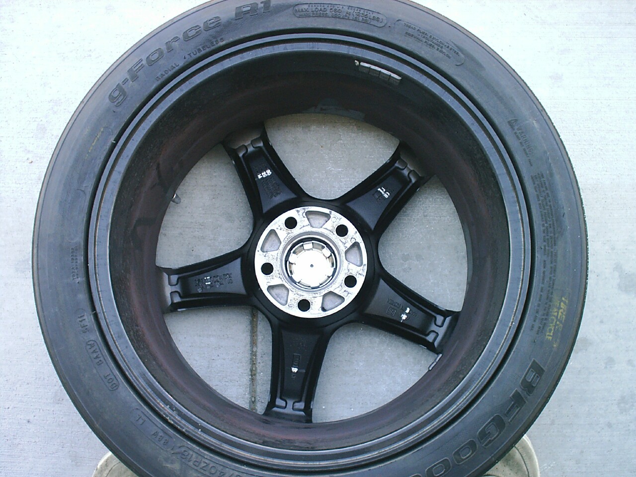

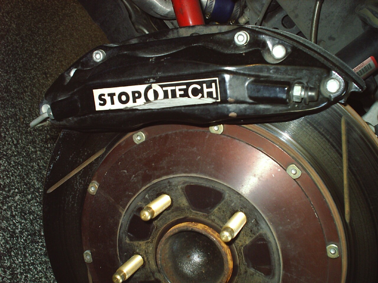

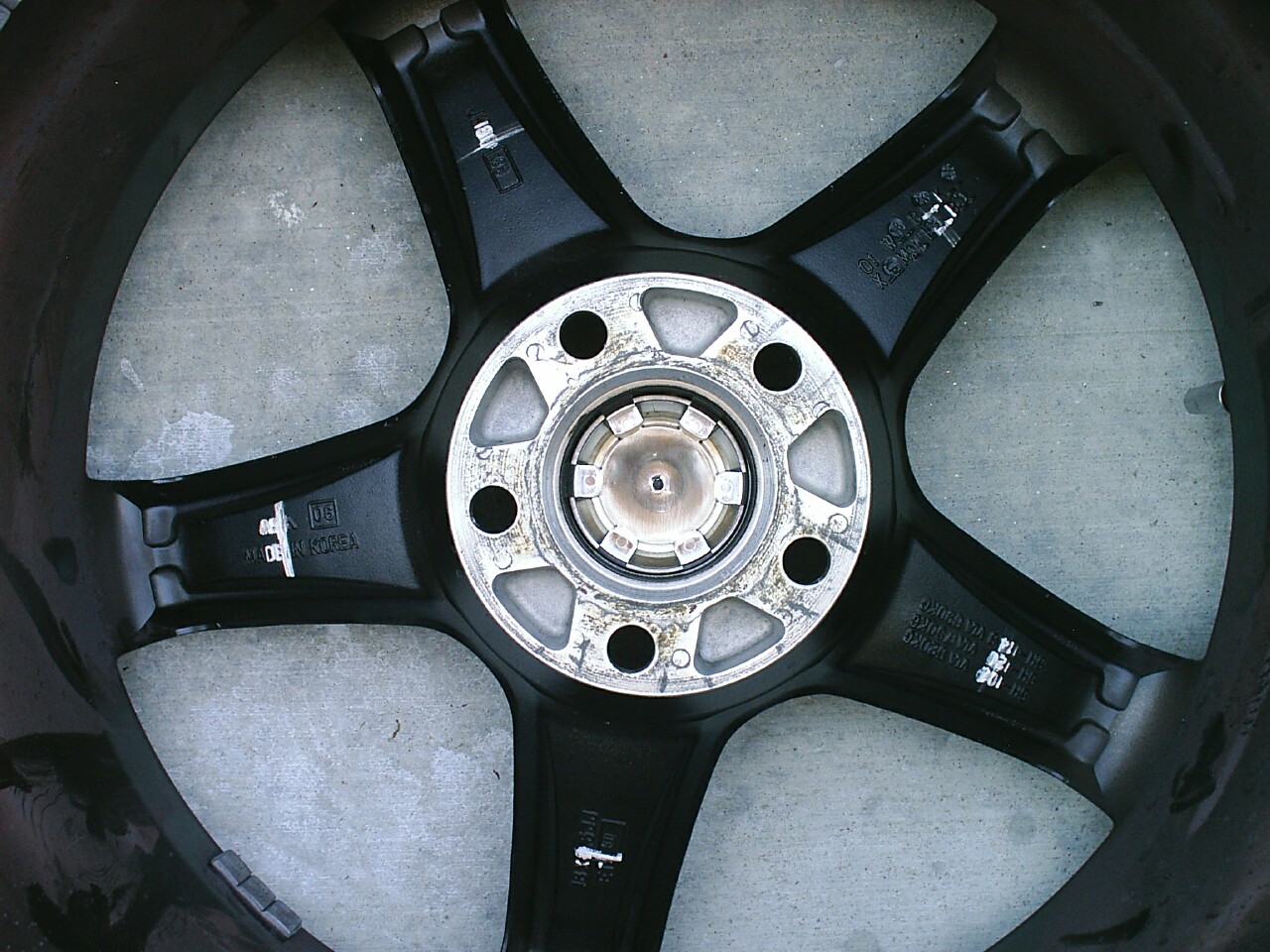

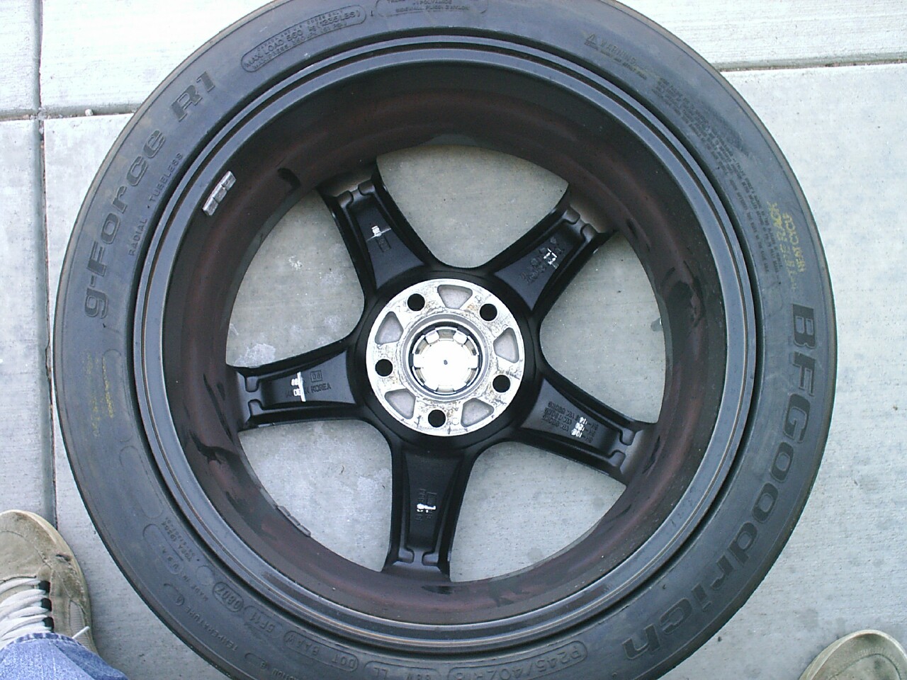

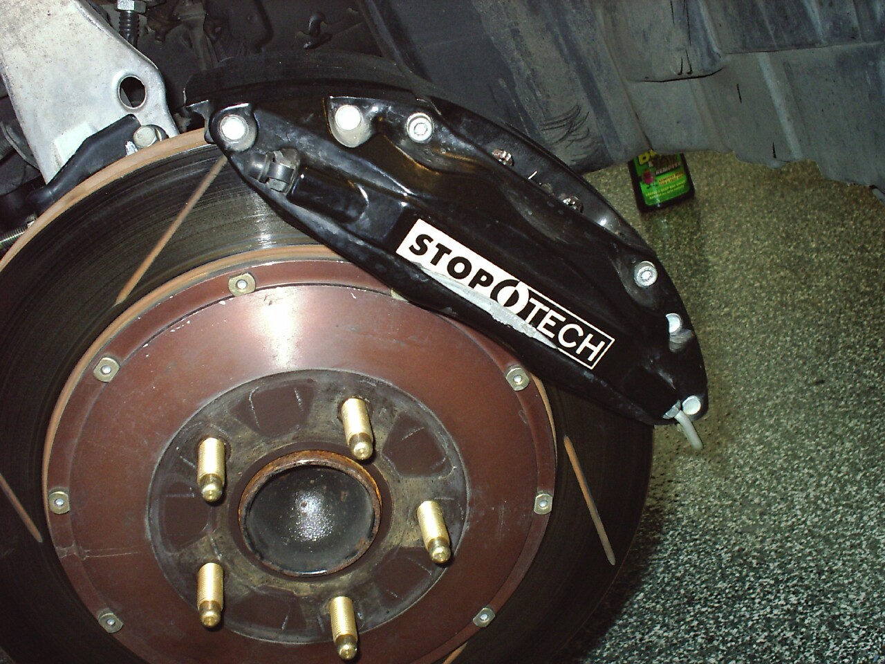

Ok, better late then never; here are the pics of my Stoptechs with some metal scrubbed off, and pics of the inside of the wheels. All cosmetic damage, but it does look ugly on the ST's

Old Sep 18, 2007 | 08:08 AM
Robert_K's Avatar
Robert_K
Didn't Go Cheap
Posts: 12,390
Likes: 101
From: Spring, TX
Wow. That is weird for same size/offset wheels. Thinking about powder coating the ST now?
