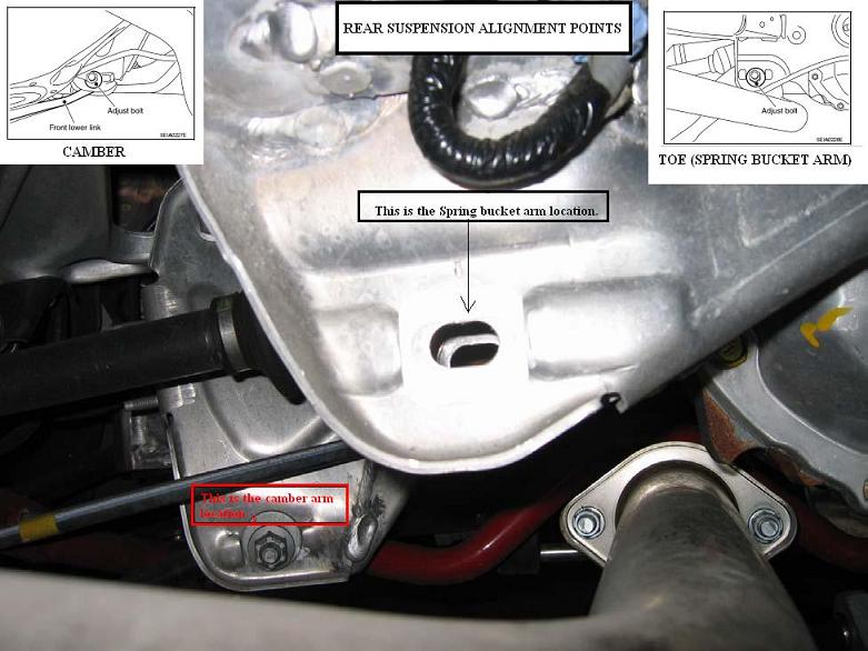

So i guess that the sticky( suspension 101) i read and many others is wrong when speaking about what a toe arm replaces...., and your correct??? LMAO
Originally Posted by JasonZ-YA
REAR - Camber and Toe:
When lowering the Z – lets talk 1.0 to 1.5 inch drop:
You will need rear camber arms and rear 3 degree toe bolt at a bare minimum. ---> everyone buys the SPC toe bolt...
Here are the two rear alignment locations for both OEM camber and toe:
CAMBER:
You need an adjustable camber arm! – done and done! Go buy one!

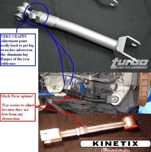

There are many camber arms out there……..which to choose? That’s entirely up to you and your budget, etc.
I however like those that are designed where the adjustment nuts/turnbuckles are not hard to get to.
Take a look below and see what I am talking about – Those camber arms that are designed with the adjustments close to the bushing side are hard to adjust with a huge 19-21 mm wrench due to the aluminum sub frame LUG getting in the way. You try getting in there and making adjustments!! pppffff..
To each their own on what you purchase – see here on what im talking about:

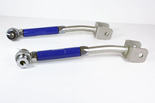

CHOICE of ROD END STYLE OR BUSHING STYLE ARMS:
You can chose when buying a rear camber arm if you want ROD END style end or if you want bushing style end. One may result in noise - MINE DID, but I just spray it every 3 months or so with lithium lube.
I choose ROD END style ended rear camber arms because I track my car, and I don't want a bushing to fail ever! So i opted
for the solid rod end style versus bushing end style.
ALSO, take note that the rod end style when installed between the lug of the rear aluminum subframe can be torqued down tight and squeezed to high torque spec and the movement is still free because its SOLID and a "rod end"........IF you try torquing down the eccentric washer at the end of a bushing style camber arm you are essentially squeezing the bushing and prematurely wearing the bushing out by limiting its "give".
re-read that if you have to.....
ALSO NOTE, THAT THIS ALSO APPLIES WITH ANY OTHER ARMS YOU BUY! ROD END VERSUS BUSHING END PARTS!
ROD END STYLE:
SPL Parts:
http://splparts.com/store/product-info.php?pid25.html
Stillen:
Circuit sports:
https://my350z.com/forum/suspension/...it-sports.html
Only downside is the casted rod end to them, but hey, its your car....keep reading...

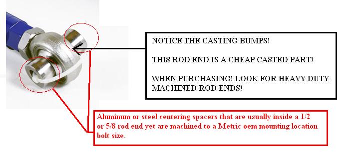

CASTED ROD ENDS:
Stay away from the cheap casted rod ends.........9 out of 10 "ARMS" built for the Z use aluminum or steel spacers at the rod end in order to accept the oem bolt and mount on the car! This allows many manufactures to purchase CHEAP SAE 3/4" or 5/8" cast rod ends that cost 2 bucks or less each and simply machine the spacers to the METRIC size bolt of the car! (rear camber and toe bolt dia is M12x1.25)
Purchase ARMS that use machined rod ends for strength and are of METRIC thread size, etc...
SEE HERE:
