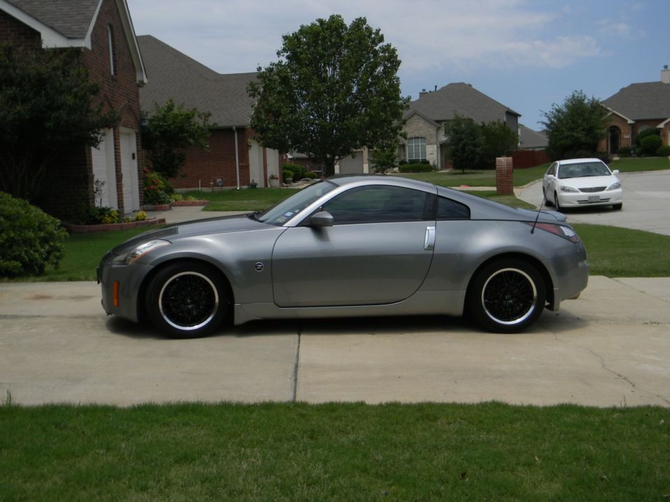

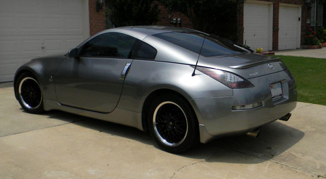

Hello everyone...I recently bought an 04 enthusiast with 63k miles on it. It's in pretty good condition... Anyway so the head lights on my car are all yellowed and cruddy. I found a pair of the non hid head light lenses for a good deal from a friend and thought it shouldn't be too difficult to get them to work... well I was wrong, I had no idea that it would be such an issue to change out the lenses period, let alone switch out and mod the other ones. I don't have too much experience with this type of thing. I'm wondering if there is anyone in the DFW area that could do it for me...any shops or local people.
Anyway so here are a couple of pictures I will attempt to upload on here, just recently bought these rims for 400 bucks new
Attached Thumbnails New owner and head light woes-240437_10150194280387712_707742711_7289582_8189978_o.jpg   New owner and head light woes-241653_10150194282617712_707742711_7289598_1829285_o.jpg
