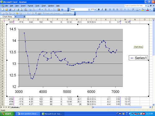

Originally Posted by aceman
Thought i would post a bit of my log file. Its a third gear pull. Let me know what you guys think. Im still using the timing map that came with the UTEC. I also had the AAM reflash before i installed the UTEC.
Code:
5081 -17.8 4.23 102  80    00   14.31 +25.1   60.3 +20.2  -7.0     4.15  14.37
 5073 -17.8 4.37 102  80    00   13.89 +26.0   58.9 +20.1  -6.9     4.03  13.59
 5096 -17.8 4.49 103  80    00   14.58 +25.9   62.0 +20.4  -7.0     3.84  13.28
 5136 -17.8 4.31 102  80    00   14.47 +24.1   63.0 +20.6  -7.1     4.07  13.14
 5224 -17.8 4.25 102  80    00   14.53 +23.9   63.0 +20.7  -7.3     4.13  13.12
 5257 -17.8 4.45 102  80    00   14.70 +24.1   64.4 +21.0  -7.3     3.82  13.12
 5274 -17.8 4.37 103  80    00   14.79 +24.0   64.1 +21.0  -7.5     4.09  13.06
 5341 -17.8 4.29 103  80    00   14.85 +24.2   65.8 +21.0  -7.5     4.11  13.06
 5376 -17.6 4.45 102  80    00   14.37 +24.1   64.5 +21.0  -7.6     3.92  13.02
 5411 -17.8 4.31 103  80    00   14.65 +24.9   66.2 +21.0  -7.6     4.13  13.06
 5464 -17.8 4.52 103  80    00   14.77 +24.9   67.4 +21.0  -7.7     3.92  13.12
 5500 -17.6 4.27 102  80    00   14.49 +25.0   66.4 +21.0  -7.8     4.15  13.12
 5537 -17.8 4.52 103  80    00   14.63 +25.0   66.7 +21.1  -7.8     4.15  13.12

Not a great tune..You really want to be 13.5 ish from 3000rpms till about 5500-5700 then go into the 12.5 range. Your looks like it is to rich from 5100-5800 then way to lean the rest of the way..if you get the A/F to where you need it, then you advance some timing over what the stock wants and you see the power come back in..It is a PITA but as pen and paper help to take notes as you tune, and take out or add small amounts like .1 and.2's

Aceman: I put your A/F log in an Excel graph. Hope you don't mind, I don't have any new logs of my own to play with.
I'll have to find a log of my base map to compare, but it much flatter, around 12.5, then bounce up to 13.2-13.5 around 4500 rpms and then ran rich to redline.

that looks like it would be a really fun roller coaster!!!
yup...Needs some cleaning up.

so did you try keeping the AF steady all the way across the rpm band?? you got the most overall power how you are stating to adjust it?? my car pulls like crazy at 12.5-12.7...
and with the timing, i noticed you said that you backed out some in the midrange?? elaborate please
backed out from the advance or actually retarded it ?? thanks a million, i WILL tune this car myself and i WILL have it running really well!!
We found the car we did today like ALOT of fuel, and mild timing, we actually advanced timing in the mid range and pulled a bit up top..I reccomend getting it on a dyno to see what the car responds to, it is the only way to see if the changes you make are making a difference..
Rajan: I am now convinced your car is weird..The same map I used on your car made mad power on the car I did today..He was way lean to begin with, your way rich..I really want to take that plenum off, but its too much work for me..lol

Went back and cleaned up my tune alittle. Still needs alittle work. So am i right to assume i should be richer from 6500 to 7000rpm? or should i start sooner?
Also it looks like i have some knocks around 6000 to 6100, what should i do to get rid of those?

Later
Aceman
I would take it into the 12.5 range at 5800 rpms up..

Thanks for your help MRC
I will give that a try later tonight and post up my log.
Later
Aceman
