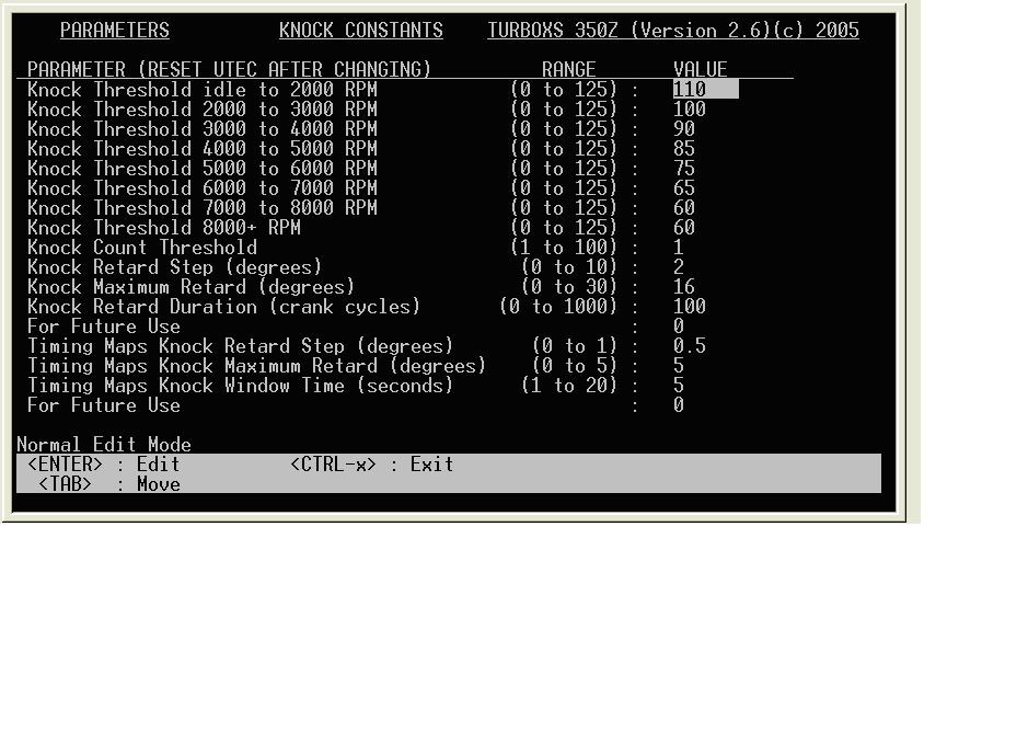

Here is a screen capture of mine. You can see what Sharif was talking about by looking at this screen.
Later
Aceman

hey man i would put your knock count threshold at 3, that way it wont pick up random engine noises and kill your car, if it knocks three times in a row, you have a problem...
yes sharif, i meant in maf pulldown, NA cars. sorry

I have it set there now, this was a old screen shot. So how are things going on your end?
