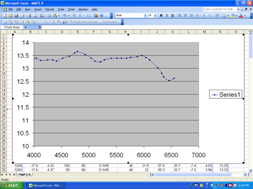

So, if a motor quits making power from added timing, would there be any real advantage to a 100 octane N/A map? I would assume that you would need more timing to get back to where you started due to the slower burn and you could maybe run a little leaner, but would it make any more power?
I'm sure I'll end up trying it just to have something to play with after I get my 93 map right.
...and, since this has become the official DIY tuner thread I'll attach my last log graph. It had a lean spike at 4750, due to an overcorrection on my part, but I think its been worked out since. Should get a new log this weekend.
If the car isnt making anymore power with added octane and ignition timing, then there woudl be no benifit to running a second higher octane/greater ignition timing map.
We found that 116 octane fuel on NA cars, even with very aggressive timing advance, did not result in a meaningful increase in power. This was just one example. I am sure another engines might respond differently, based on the mods done.

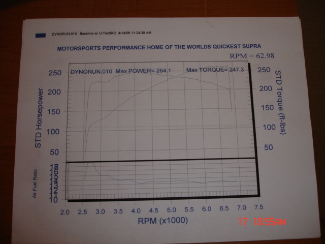

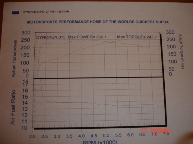

Here are my before and after dyno's and the log file for the after dyno.
Looks like i made 4 more HP and 5 more TQ over the reflash. I think i can pull alittle bit more out of the car with more tuning. Had the A/f dip to around 12.5 A/F and it did not make more power with my parts. For my car after about 7 pulls on the dyno, i made the most power with my A/F around 13.0-13.2.
Also my timing was to far advanced. I made more power just advancing the timing between 1 to 2 degrees. I need to play with my A/F alittle more. Around 6000 it dips down into the 12's. Need to bump that up alittle.
All in all i am happy with the results. The results are on top the AAM reflash.
More to come later.

Later
Aceman
Attached Thumbnails more questions about utec...-before.jpg   more questions about utec...-after.jpg

That dip in the dyno around 3000rpms can be smothed out a bit.By the looks of your data log, your in the 12's a/f at that point, go with mid to high 13's and keep it mid 13's..Other than that nice job.
Thanks MRC, i will try and get the rest of it smoothed out.
Would like to add that i had a blast tuning my car on the dyno. The guys at Motorsports Performance in Frederick let me sit in the car and adjust the maps before each run. I guess i did about 8 runs and let the car sit for about 5mins between each run while i changed the maps around.
I did do a data log for every run that i did on the dyno. I do believe i am the first one to post up a dyno with a data log Good stuff
Later
Aceman

You should bring that car over to Jermaine at Turbo XS and see if he could squeeze some more out of it..
